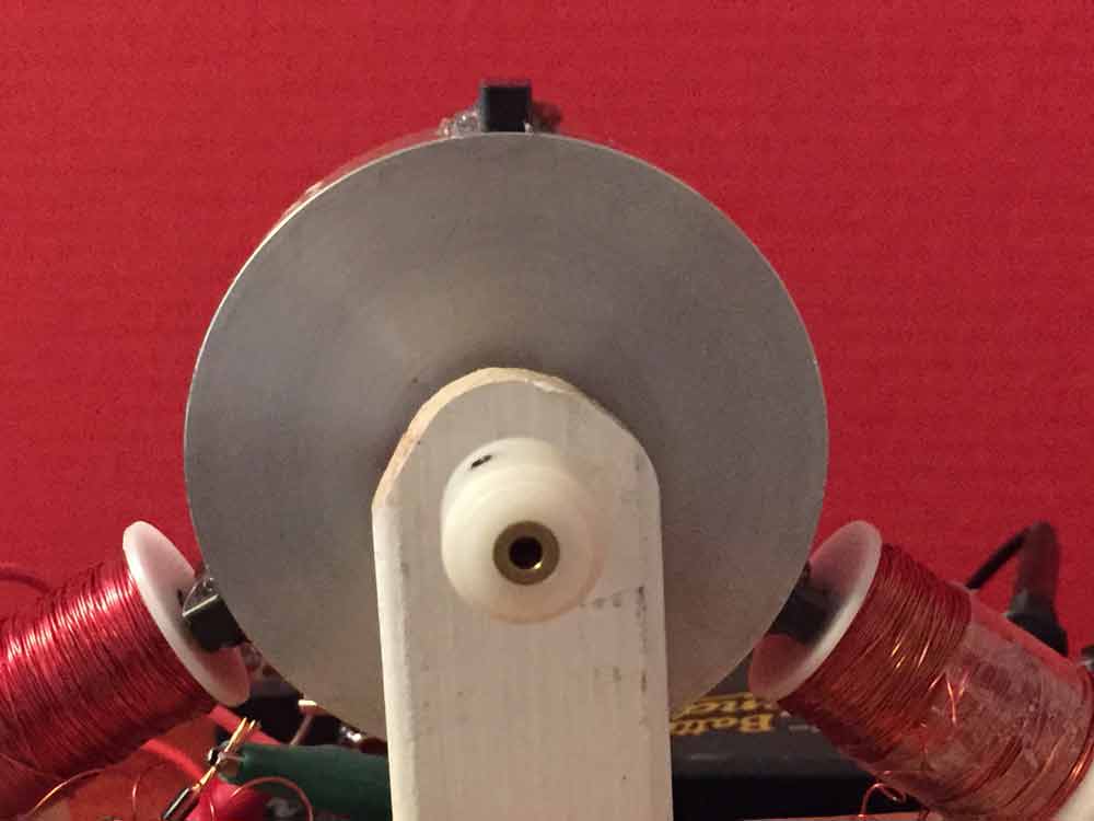

I played around with several different magnets on this 3PM kit.
these are the ones that I found worked the best:
leave the neos in there. I purchased these from my local hardware store - 1/4" x 1/4" x 7/8"
7/8" is the same width of the wheel.
These work nicely in the same acrylic frame with the Bedini logo however, you will want to ditch the wire if you want to build a better charger. Which means you will want to wind bigger coils, so you will want to perhaps drill some new holes so the frame can accommodate the new coils. Also, put some spacers on the coils to move them away from the center of the wheel.
The coils in the picture are the originals they work better with the new magnets however not as good as thicker wire. For me it was just easier to build another frame from wood, I could have extended the white stand higher to hold a 3rd coil however this is just a prototype. wood is cheep, quick and easy to work with.
