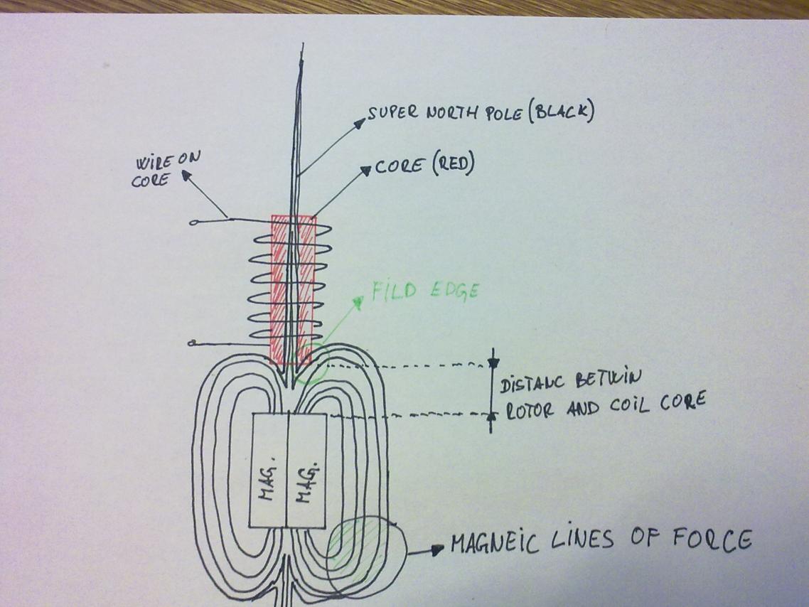

I draw a pictures how I see the rotor and core, edge of the field ect. if I understand you corectly set up should look like I draw it on the picture (my english is litle rusty and I dident know if we mean the same thing when you were talkin of the coil set up at post #26,28 so I draw a quick picture
)hope I understand what you ment, is it correct???
with regards Stane
with regards Stane

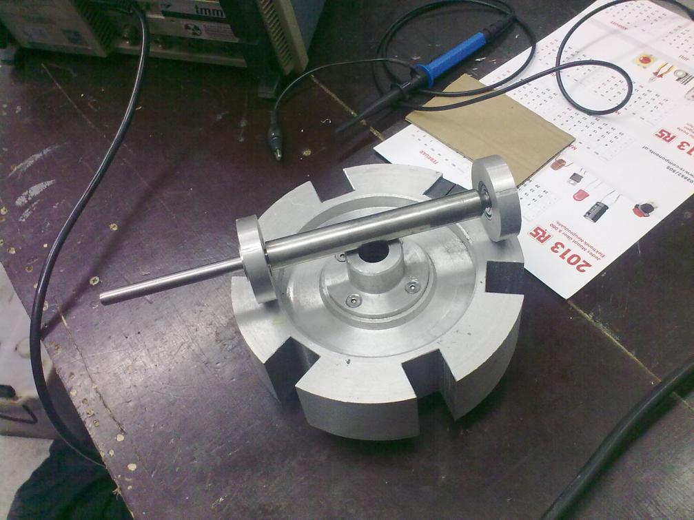

at the moment I don have super pole rotor on machine becouse of the magnets that flow away of the rotor becouse of the glow I will put promesed pictures up the forum of my set up later this weekend.
