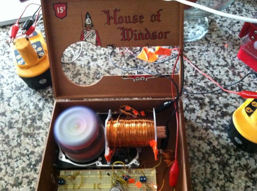

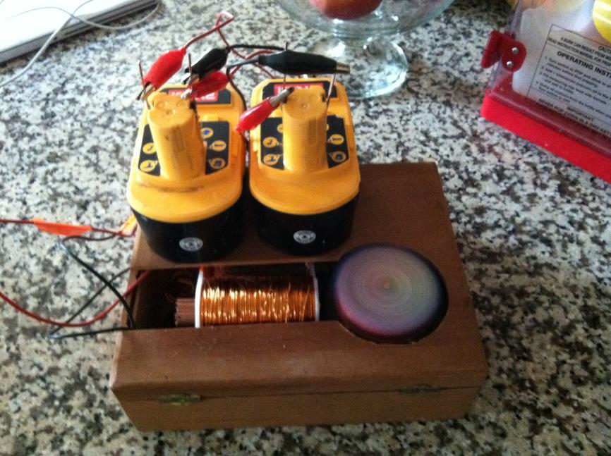

Here is a picture of my latest Cigar box SG. I use it to recondition and charge my 18v drill batteries. Works like a charm. These batteries wouldn't charge in the manufactures charger, but Bedini came to the rescue! These batteries charge as high as 23v now. The coil is 3 pwr (#23) and a trigger (#26) spinning on a 250GB hard drive (which, by the way is a 3 phase stepper motor/awesome bearing. I wonder if I could power that 3 phase motor , its rated for 10,000RPM
