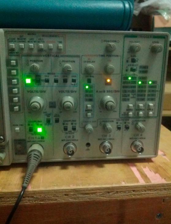

1 - O-Scope Setting Panel (x10 probe)

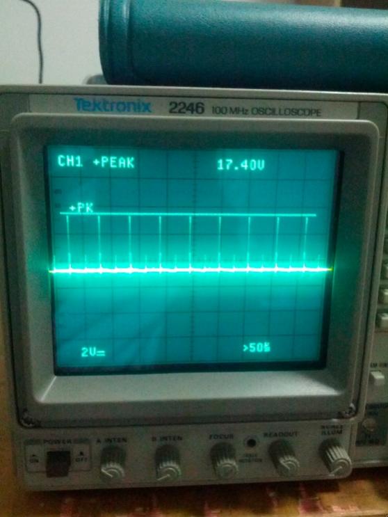

2 - O-Scope Screen Shot

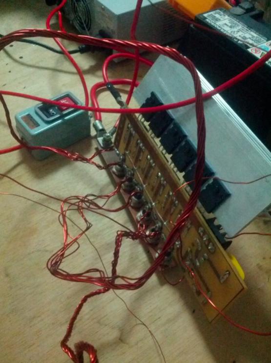

3 - Back side of my circuit (with Patrick's cap/diode mod, though you can't see them in the photo)

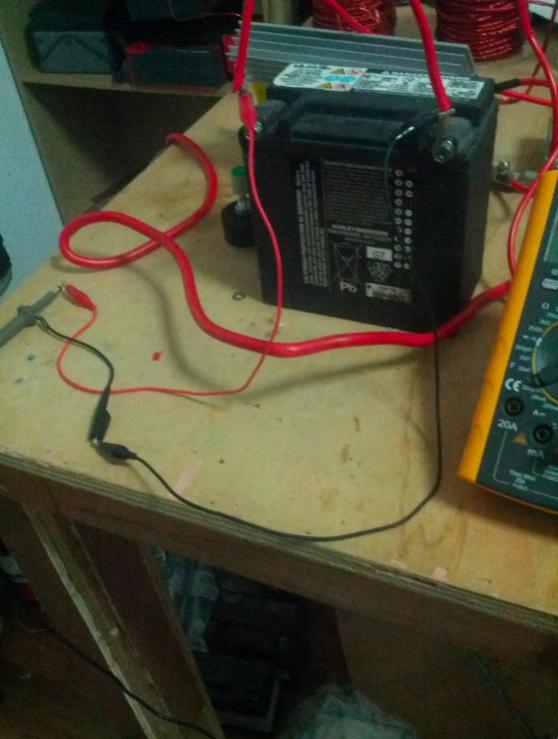

4 - Charge battery (small Harley Davidson 12V 10Ah battery). You can see I am taking the spike reading directly from the battery terminals. I noticed if I put the probe directly on the output point coming from the circuit board, I get a larger spike reading (the 17.4V seen in the scope screen shot).

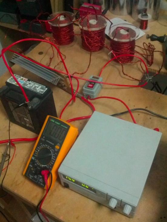

5 - Setup (input is a power rail 16V, 0.6A. I know, power rails aren't ideal as the signal needs to bounce between charge and input batteries, but I'm still at the testing stage for now). The multimeter is not hooked up to anything, hence the nul reading.
In the full setup you'll see my 3 coils, circuit, power supply and charge battery. The coil in the center is the drive coil (haven't separated the trigger) and the other two are power coils (8 filer, 18AWG, 150foot windings, same but 9 filer for the trigger coil).
You'll see in my scope shot that the peak voltage of the spike is only around 17.4V. But I have filled a 450V, 470uF cap to just over 180V with this system so I do believe I am getting a proper spike. To do this, I just switched the charging battery for the cap. I know the cap isn't the proper way to measure the spike level, but I thought it would be a good indicator whether I'm getting a proper spike or not.
Anybody have any idea why I can't see the spike on the scope? Is the scope just not up to the task?

PS - In my setup image, you can see some iron pipe sections at the top left. I took these (10mm thick) pieces and placed them around the two power coils and the spike increased about 8% (focusing the em fields I believe: Master Class DVD from Bedini). Putting one around the drive coil seems to interfere with the trigger resulting in a slight drop in the max spike.
