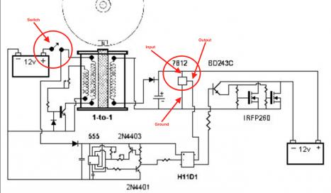

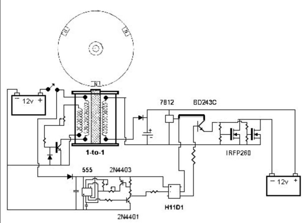

the new schematic and my original questions
Thanks RS.
So it seems the voltage regulator is now both turning on the transistor, and sending the current through it, instead of the current coming from the battery as before.
It seems more certain that the leg of the voltage regulator going to the right is output, but can you confirm?
Any comments on the switch I was asking about?
Hi Cmor,
The voltage regulator supplies a constant 12 volts to both the BD243C transistor and the H11D1 opto coupler thru the leg going to the right. And no, the regulator doesn't trigger the transistor. The opto coupler keeps the run battery completely isolated electrically from the capacitor, 7812 regulator, DB243C transistor, IFPR260 FETs, and the charge battery.
The 555 timer circuit causes the 2n4401 and 2n4403 to trigger the H11D1 opto coupler which in turn triggers the transistor. The capacitor is discharged thru the FETs when the transistor turns them on. The timing of the 555 therefore determines when the cap dumps rather than comparing the voltage on the cap to a given value. A comparator circuit is actually a better way to do a cap dump.
The switch you were asking about is simply and on/off master switch for the entire device.

I appreciate the clarification of what the voltage regulator is doing. I was clear on the function of the optoisolator, but confirmation is always welcome.
I still remain a bit confused about the switch though. Do you mean, rotating the wheel is the "switch" or is there something physically there, in that part of the circuit, that I need to install?

I forgot to add another question to my last message. It's regarding the recovery coil. I think I get it, but I just want to confirm. In my case, I have 8 power windings. All I need to do is isolate out one of them right - and then hook the diode to the bottom end (would a 1N4007 work?) the cap to the top end, etc. as shown in the schematic?

Hi Cmor,
The switch is a manual toggle switch that you can turn off to stop the machine from running. It is only a convenience so you don't have to unhook the battery leads to stop it. It's optional.I still remain a bit confused about the switch though. Do you mean, rotating the wheel is the "switch" or is there something physically there, in that part of the circuit, that I need to install?
Yes. That is correct.All I need to do is isolate out one of them right - and then hook the diode to the bottom end (would a 1N4007 work?) the cap to the top end, etc. as shown in the schematic?

Hi Cmor,Originally posted by Cmor View PostThanks RS.
The switch at the primary (drive battery) may be a simple toggle switch to turn on the Radiant Oscillator, or it may well be a split-commutator switch as per JB 1984 machine for the sake of back-popping of the drive battery. the idea is to isolate the drive battery from the oscillator circuit at the instant when the dump occurs and re-connect it when it is charging the capacitor.
