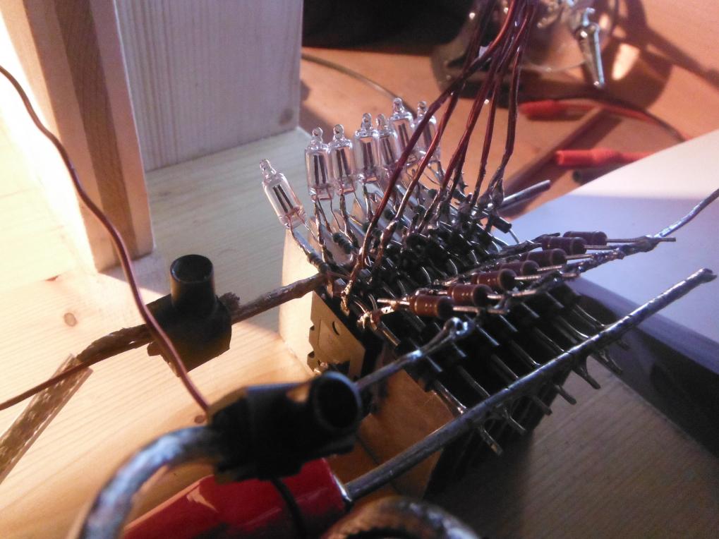

do you have insulators between your transistors and the heatsink? where is your probe attached? collector ouput after the diode and charge batt negative is where it should be.Originally posted by forelle View PostHi to all,
here is my setup in superpol-configuration.
Coil is 8 filiar 18 AWG 1.2 ohm each strand,18mm core
7 MJL21194,7 1N5401,7 1N4007,7 470 ohm base,potentiometer adjusted to about 20 ohm,
155 [email protected] amp attraction mode,

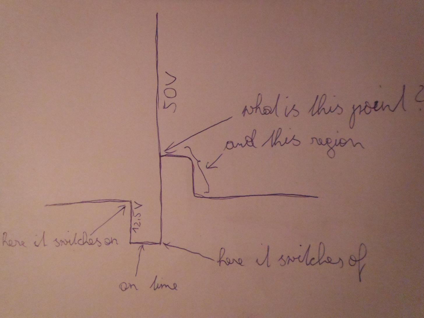

My problem is that my h-wave is not correct and i dont know where the mistake is,i am not very familiar with electronics,but on the scope you can see that when the transistor switches on it goes to the wrong direction,it looks like AC.
I hope somebody knows why this is.
Thanks[ATTACH=CONFIG]1309[/ATTACH][ATTACH=CONFIG]1310[/ATTACH]
There is a voltage spike where the Transistor switches of,of 50 volts(hardly to see)

Hi Tom,Originally posted by Tom C View Postdo you have insulators between your transistors and the heatsink? where is your probe attached? collector ouput after the diode and charge batt negative is where it should be.
I have insulators between transistors and heatsink(mica+the white mass),my probe was atached on C directly on the transistor and on E.

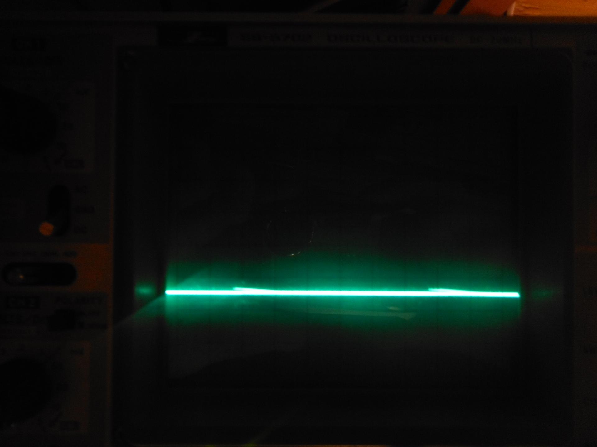

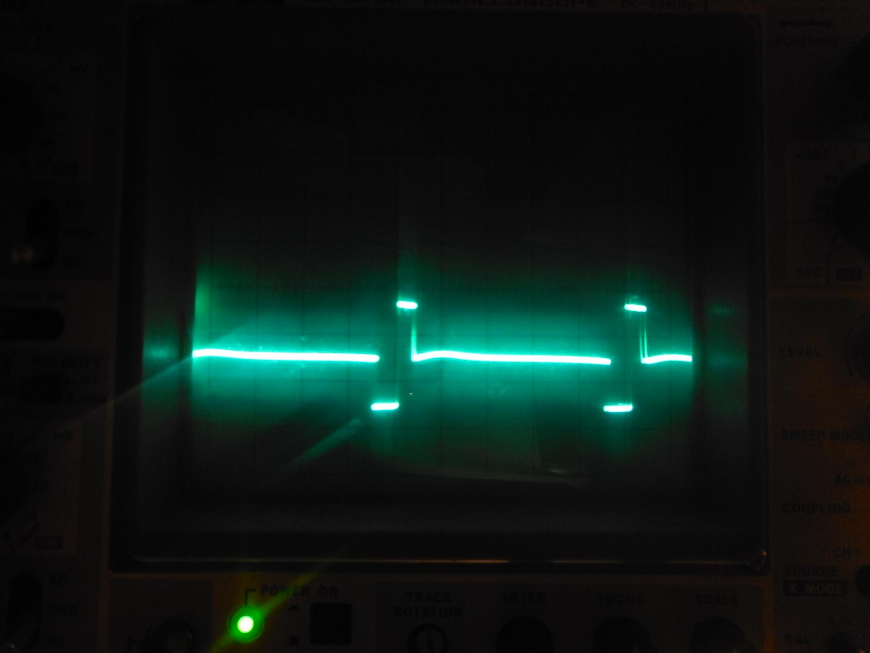

When i attached it after the diode and on -CH i get only straight very small spikes you cant see them on a photo.
I try to make a good picture.

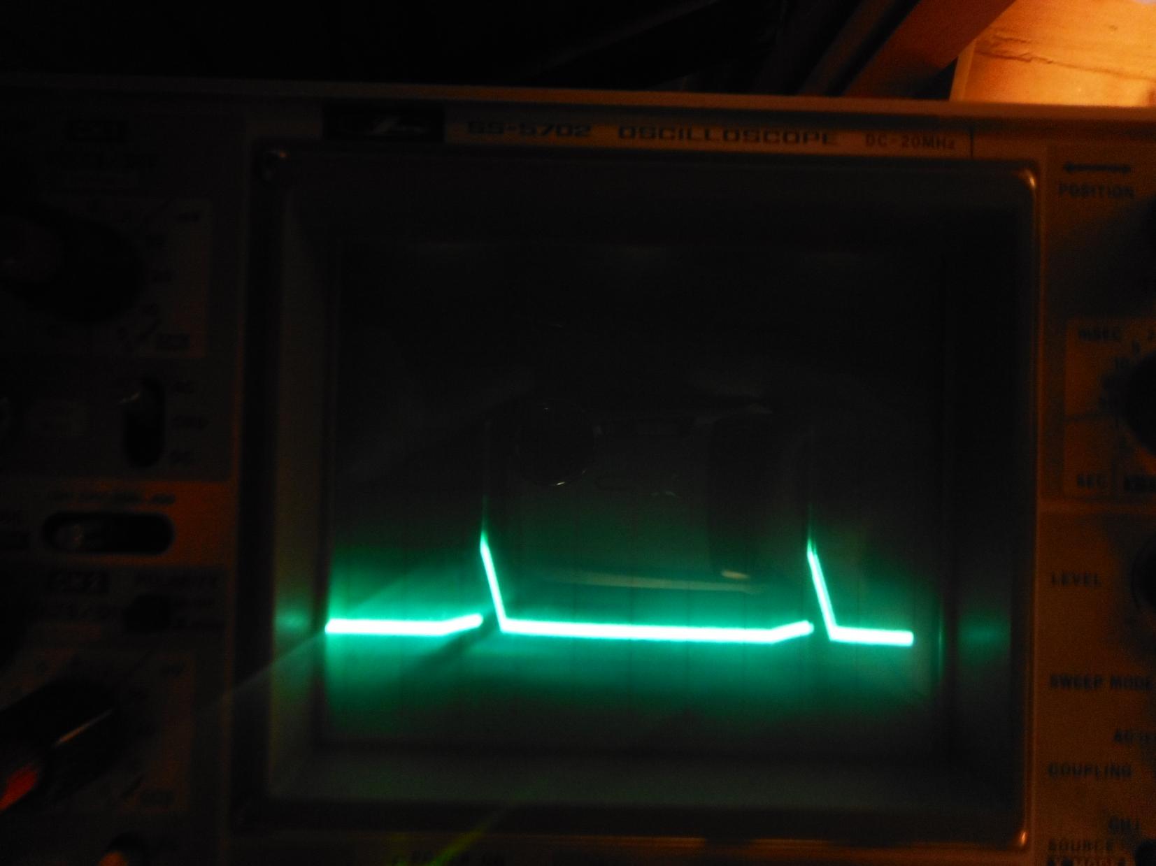

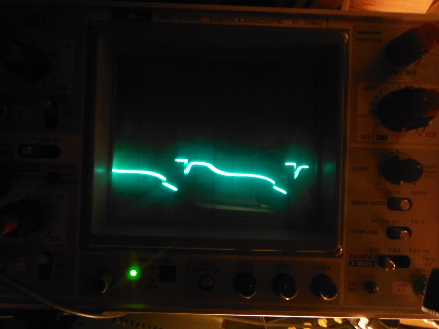

Here are 2 pictures but the quality is not good i did my best,but there must be something wrong.When i hook up a cap on the charging side it charges up to 510 volt in 2 sec.I have measured the diodes and they look good.I have new batteries wich means not conditioned.Maybe i dont know how to adjust the scope right.I have tried with a coil with only 2 wires but the wave looks the same.Originally posted by forelle View PostHi Tom,

There is no currentflow,i am not sure but the first picture above,C after diode and CH-,could be what im looking for,i hope John K.or Tom C. say the same.Originally posted by LesK View PostWell, you got me on that one...
