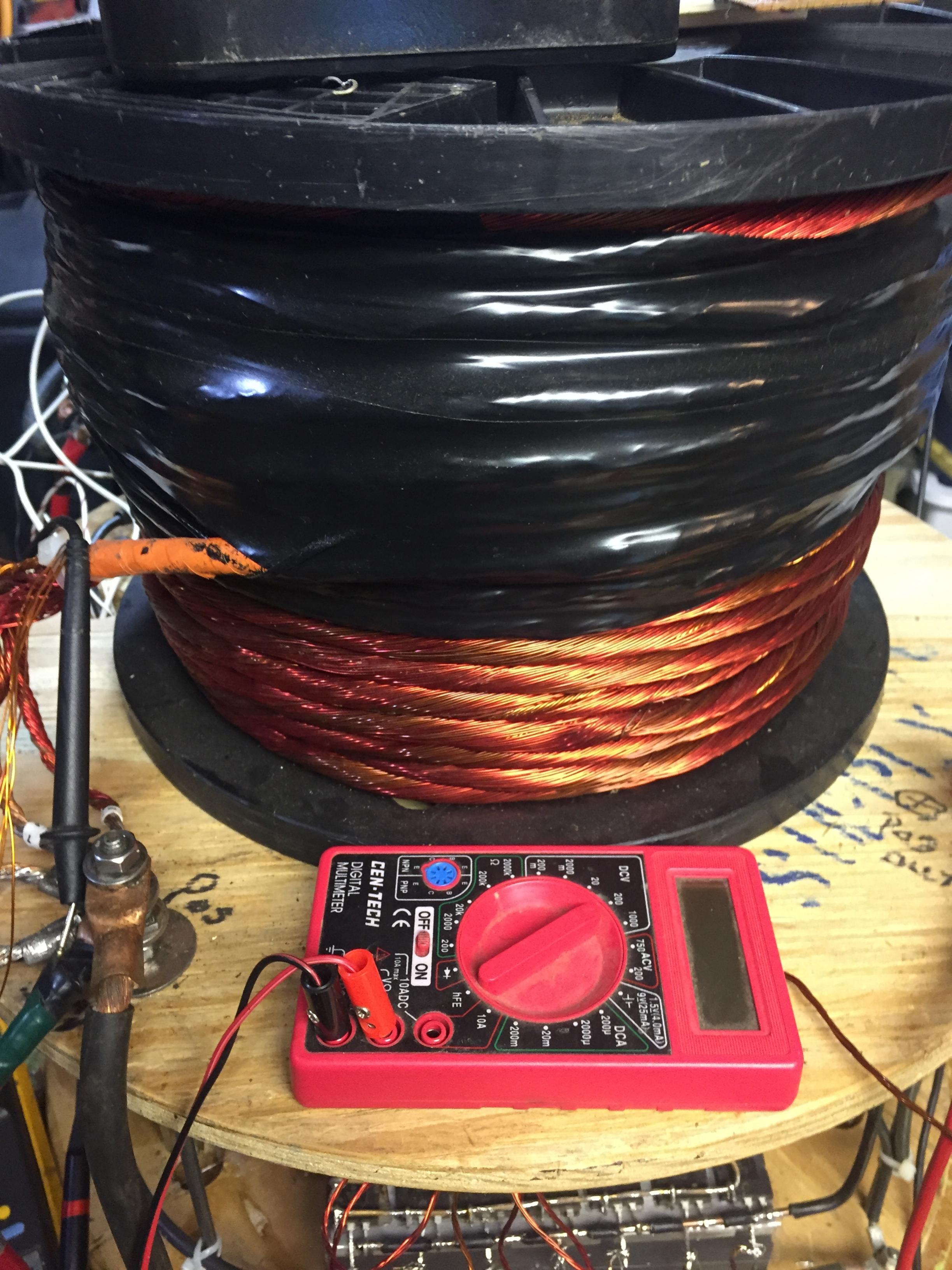

My coil began life as a standard SSG coil, 117 strands of 23AWG, about 315 feet long. The wire size was used because I came across a large spool pretty cheap.
The number of strands and length came from trying to impedance match the coil to a battery bank that I had at the time.
The core was soft iron, and the coil had several strands of #26AWG wire in there for tgger wires.
The wheel was made from a 5 foot diameter table top and had 16 6" x 2" x 1" ceramic magnets mounted. Shaft diameter was 1".
The thing never worked very well, and, I didn't have good batteries either.
So, I've ditched the wheel and made an air core out of the thing.

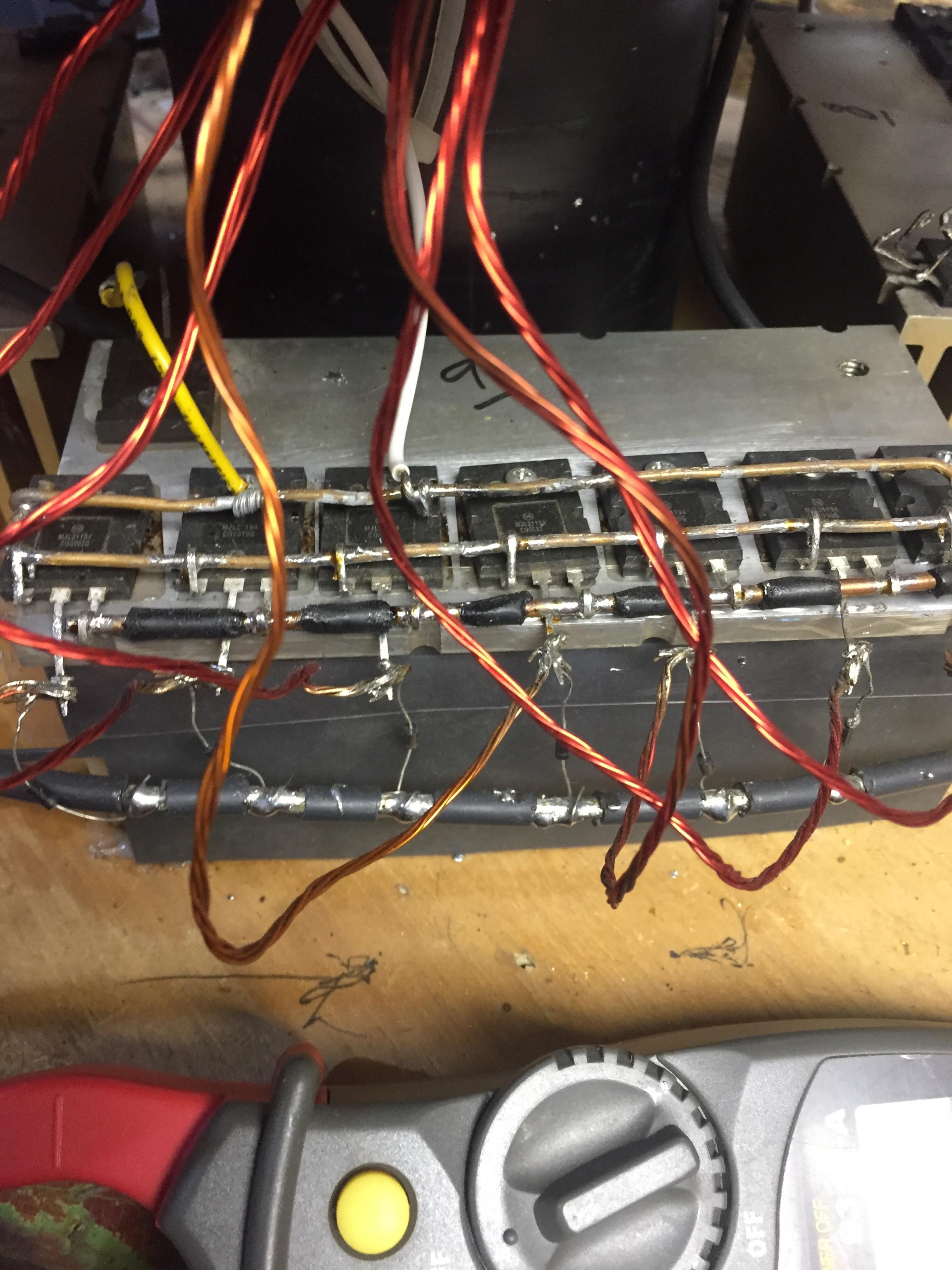

I'm using 7 MJL21194 transistors per heat sink, each with 4 strands of wire attached.

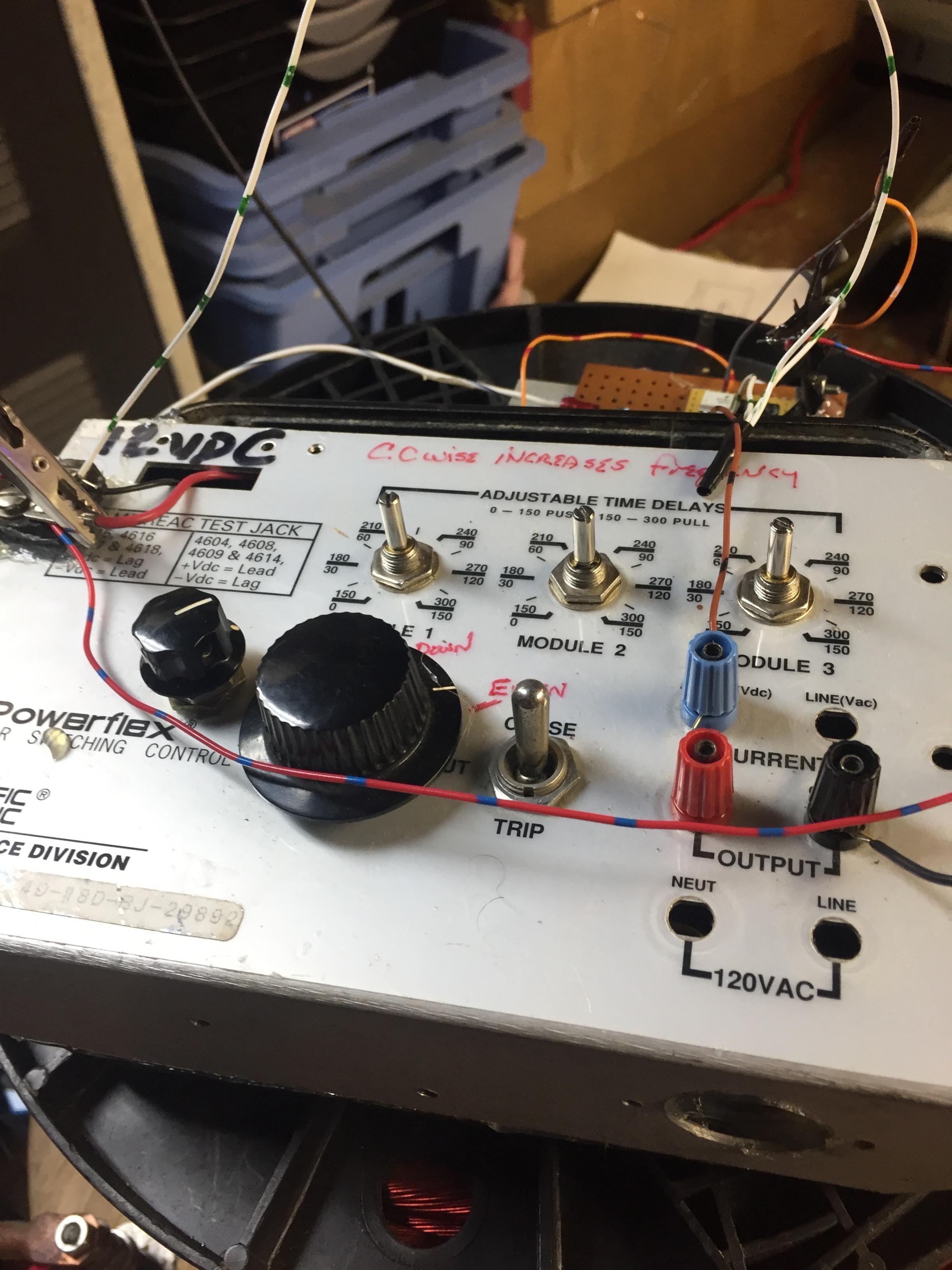

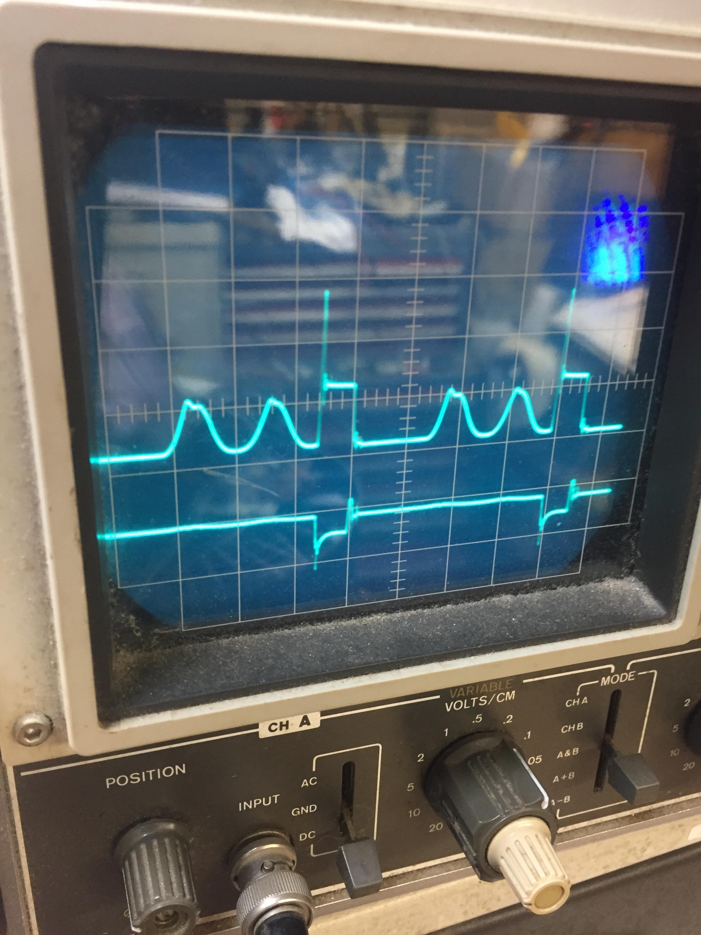

Several frequencies produce good radiant, with something like 1.8 KHz seeming to give the best.
The machine is connected 'split positive' between a 24 VDC supply and 6 each 6 VDC batteries, series connected for 12 VDC.
On my first try at this, I only had one 12 VDC bank at the bottom of the circuit. It quickly rose to 15.5 VDC, so I shut it down and am using 1 battery for charge from the SG and 3 banks of 12 on the bottom.
This is working well, as both the charge battery and the bottom bank are above 14 VDC.
Current from the 24 VDC supply is 3.2 amperes.

1. Use JB's SG3524 PWM from his patent to control the base biasing transistor. There's a print around somewhere that shows how to vary the duty cycle. I've played around a bit but can't accomplish that.
I can get the frequencies that I want, but not the duty cycle.
2. I've had a picaxe setup around for some years. Reckon I'll start studying up and find out how to use that.
I want to be able to choose about 5 somewhat tweakable output frequencies to send to the coil and I would like the frequencies to be 'rock solid'.
I can live with the thing the way it is now, but would like to have a cleaner wave form.
