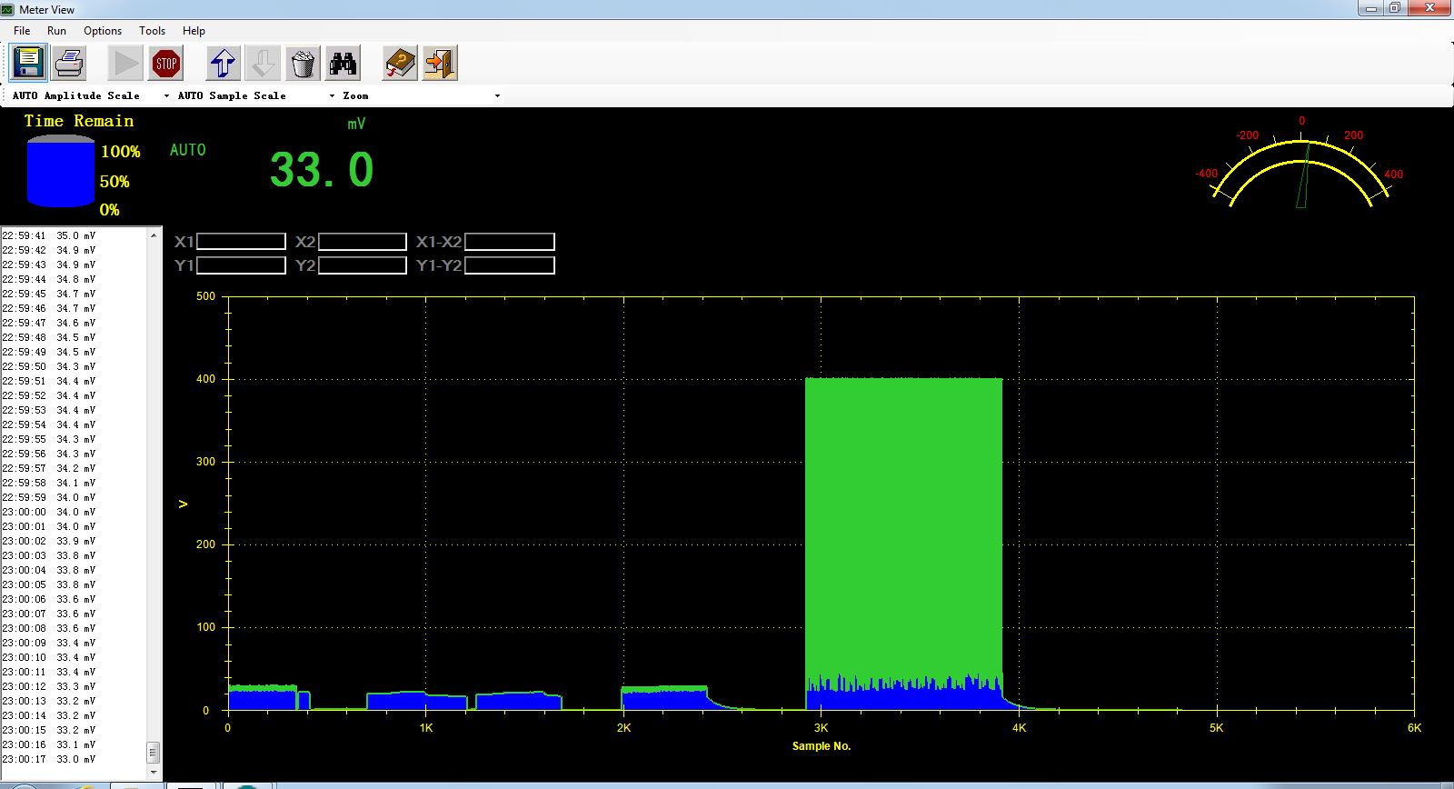

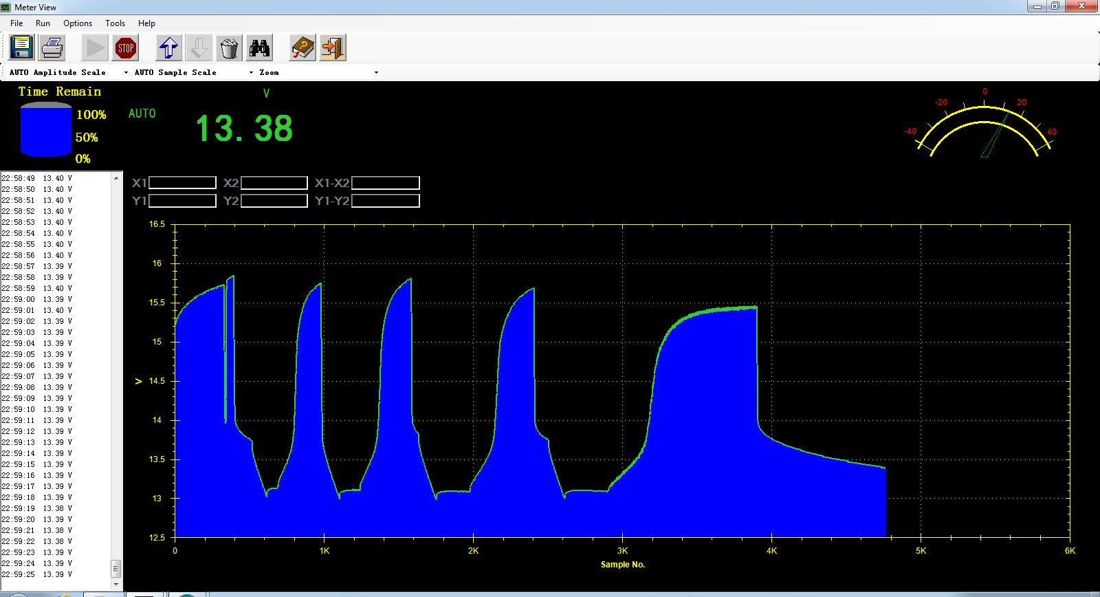

I have to ask you Bob where you got that wonderful software that graphs the battery charging curve I saw in your video?
Very impressive setup Bob.
