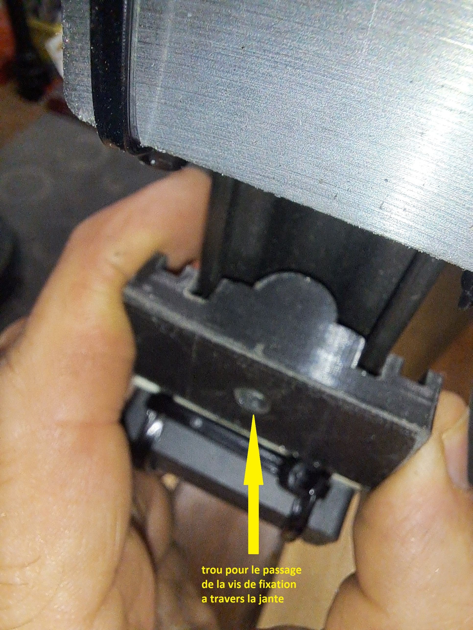

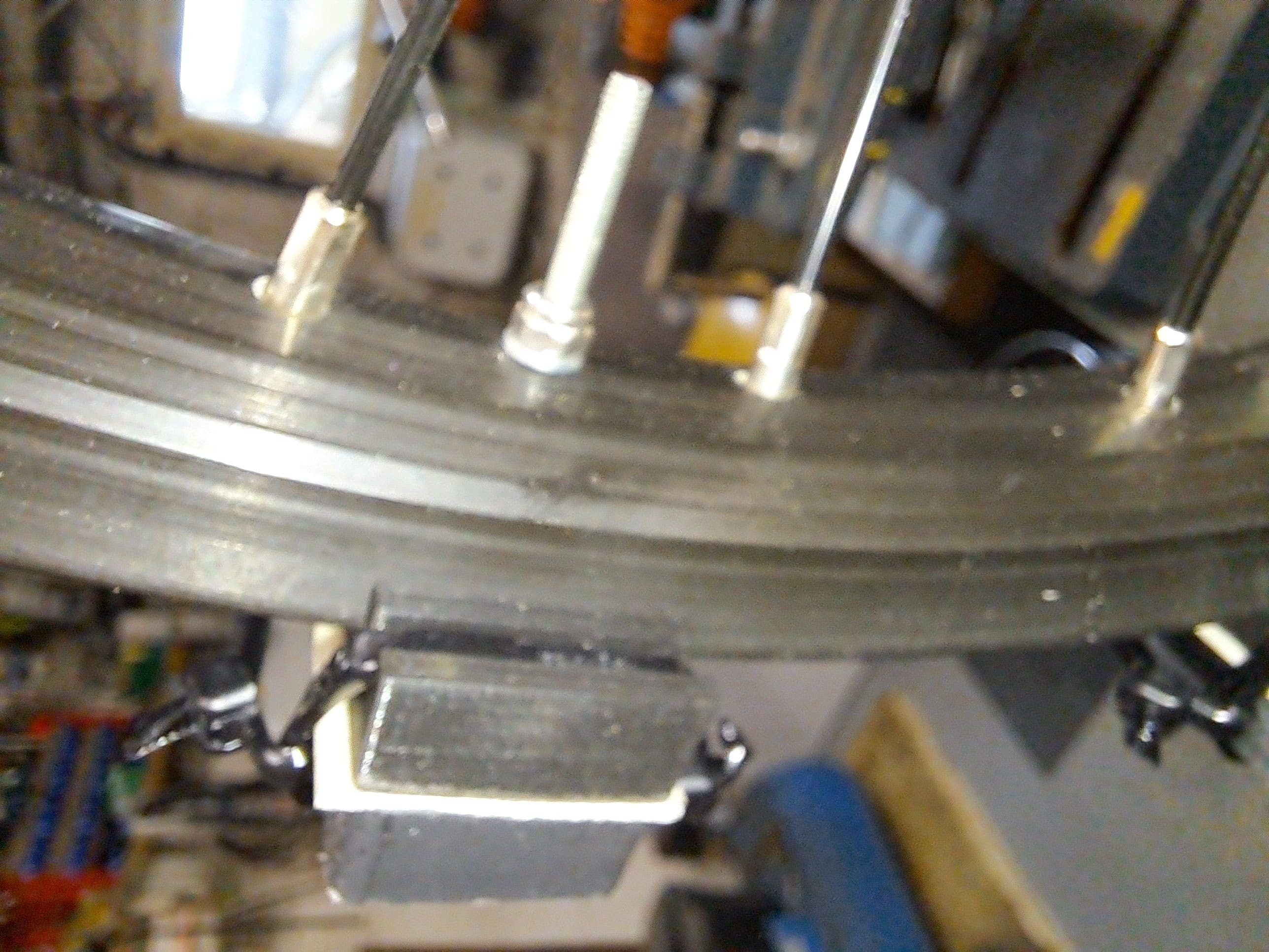

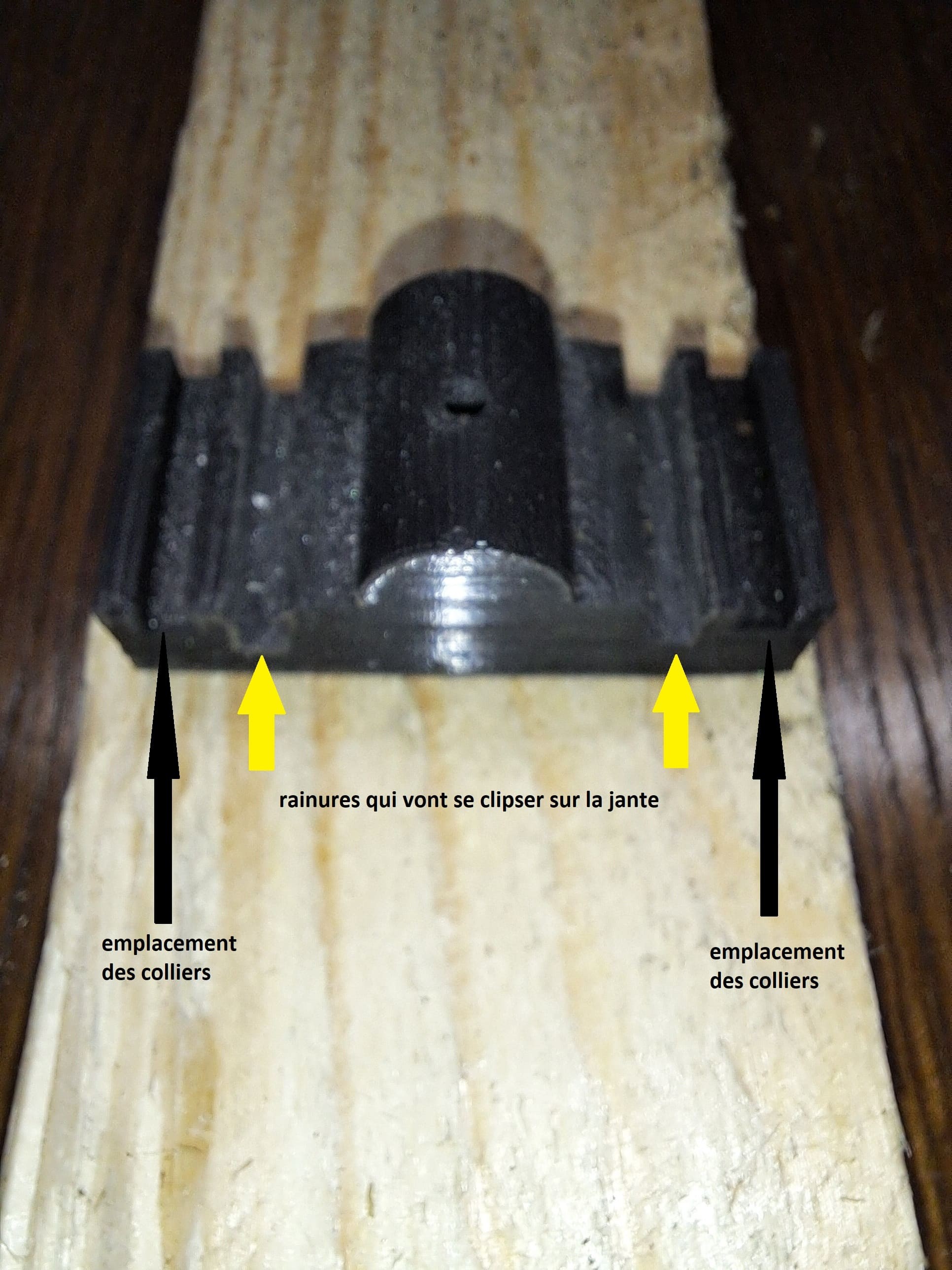

    Hello everyone, and sorry for my English.
    I wanted to make my modest contribution to fixing magnets on bicycle wheels
    You will need a 3D printer, for those who have one at home or at a friend's house.
    I hope I can post the photos
ID:	74801 Click image for larger version
    for those who wish, I can provide the source file of the magnet support ready for printer

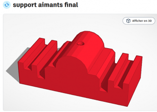

              voila une capture d'?cran, me donner un mail, je vous l'enverrai .
              here is a screenshot, give me an email, I will send it to you.

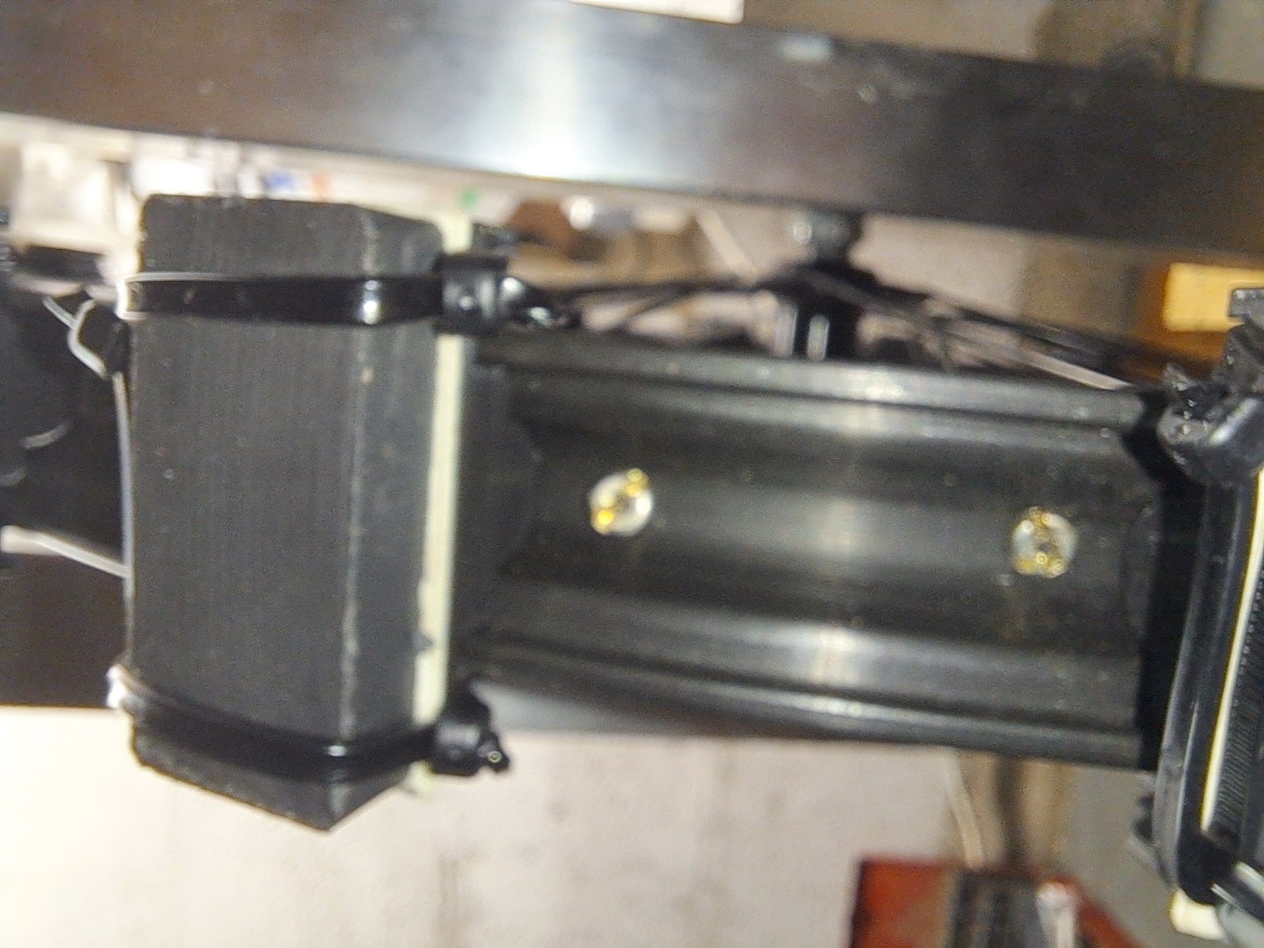

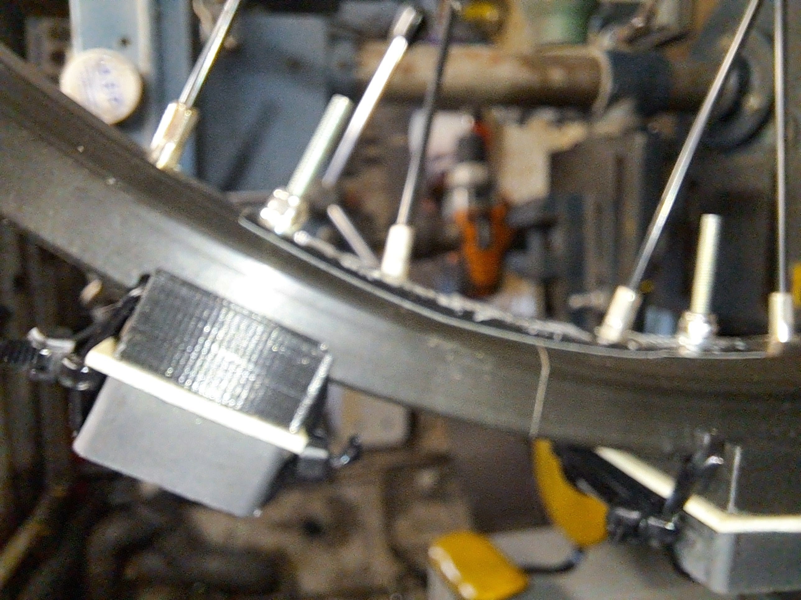

                Here is the result, the support is fixed with a screw which passes through it, the rim is drilled with a 3 mm hole, the magnet is fixed with a powerful double-sided adhesive and 2 plastic collars at the ends to secure
