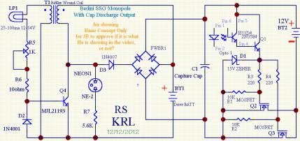

SSG Monopole with Capacitor Discharge, I know you call it a SG in the video....
JB,
Using a muilty strand SSG to fill up the Cap pulser had been talked about a long time back, but I was unsure at that time which way this version was arranged. So I wached this video several times, and cut and pasted up the basic single transistor SSG with pulser Schematic below, to make sure that is what you are talking about. Muilty Strands would all have their output diode Buss into the FWBR. Does not show any cap pulse trigger, for simplicity's sake........
Post 8
If this is correct, I will be testing a 16 Strand PCB Version soon........
RS
