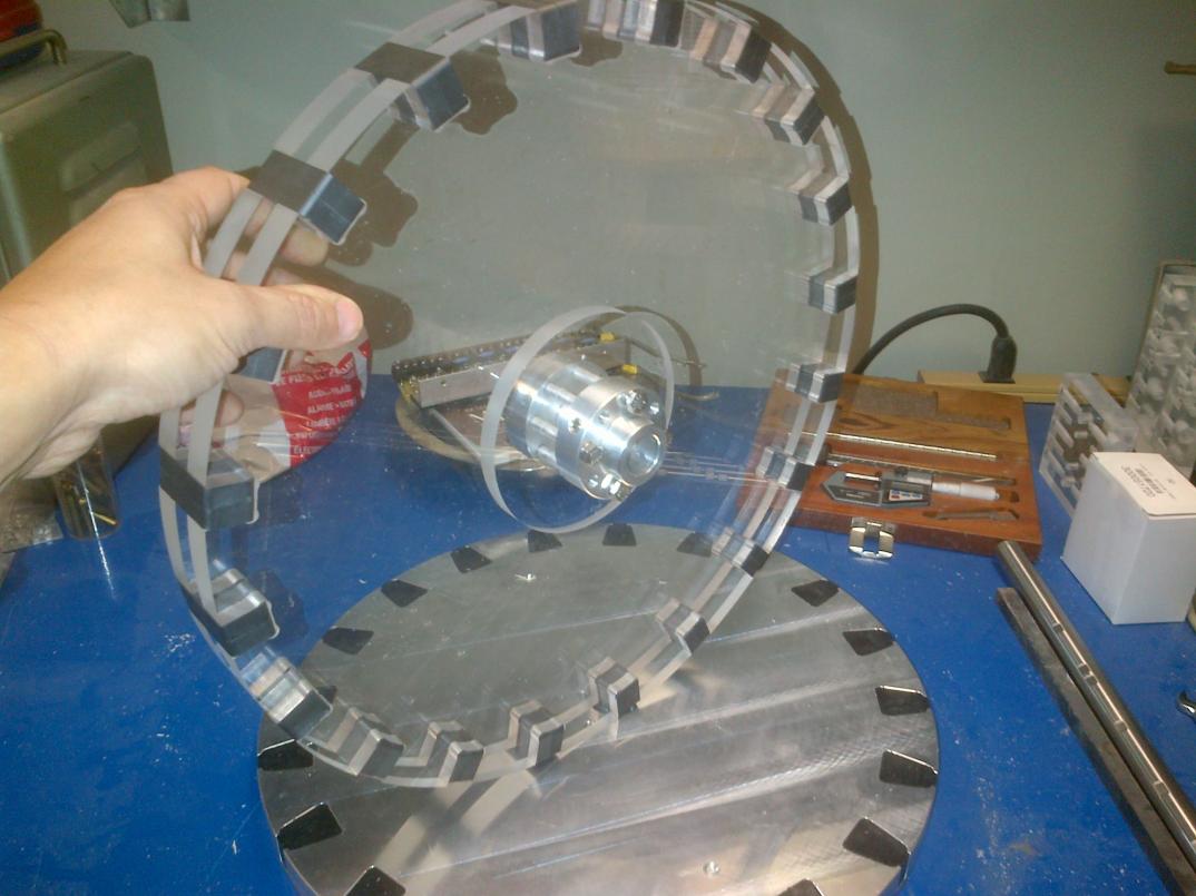

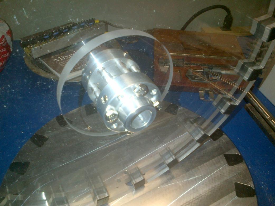

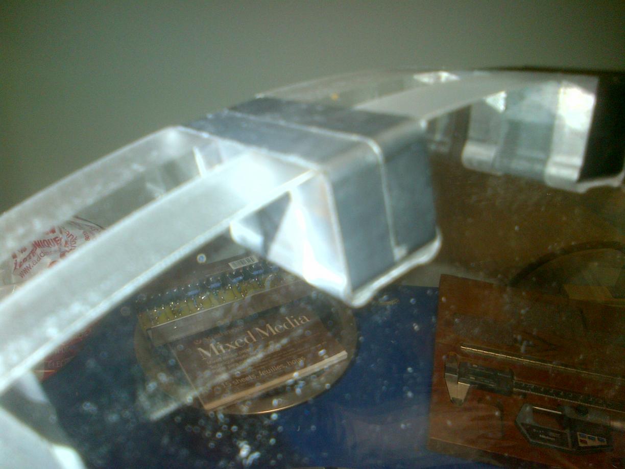

I finally received the rotor in plexiglass for the modification of the 10 coils kit .
I am sorry for the long wait but I have to re-do it because the 20 slot was to tight.
These rotor is especially for the people that have already the old 10 Coils Kit, and wont to change the aluminum rotor whit the neo magnets and put the plexi whit the ceramic magnets.
The 20 slot in the rotor need to be finished : you have to square of the corners ( see video )
I did these for mine 10 Coil, so if somebody wont to buy one you can call KEL-TECH Plastics and speak directly whit Leslie Harris at 253 472 9654. They still have the CNC program saved .
Her address :
KEL TECH 253 472 9654
Tacoma WA 1 800 535 8324
[email protected]
Kel-Tech Plastics | Leading manufacturer in plastic displays and custom fabrication
I have pay it $236.00 for mine (actually more for the re-do it ) but these is the price of today plus shipping ecc. I am not involved whit the company and I do not make any many ,I wont to be clear. But if you are still interested ,Leslie is a nice person and the one to talk to ,because she dealt already whit me and she will understand what you want.
I made a quick video whit the dimension ecc.
I hope that these will help somebody and continuing experimenting.
Saluti Ralph
