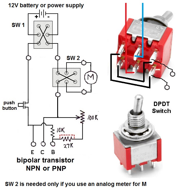

We have the beta matching circuit from the SG manual for NPN trasistors.
I would like to modify that circuits concept to beta match PNP transistors.
This might be very easy for some of us.
Any one sure of the PNP circuit?
I guessed wrong and blew an expensive PNP.
Help if you can.
Always grateful,
bro d
