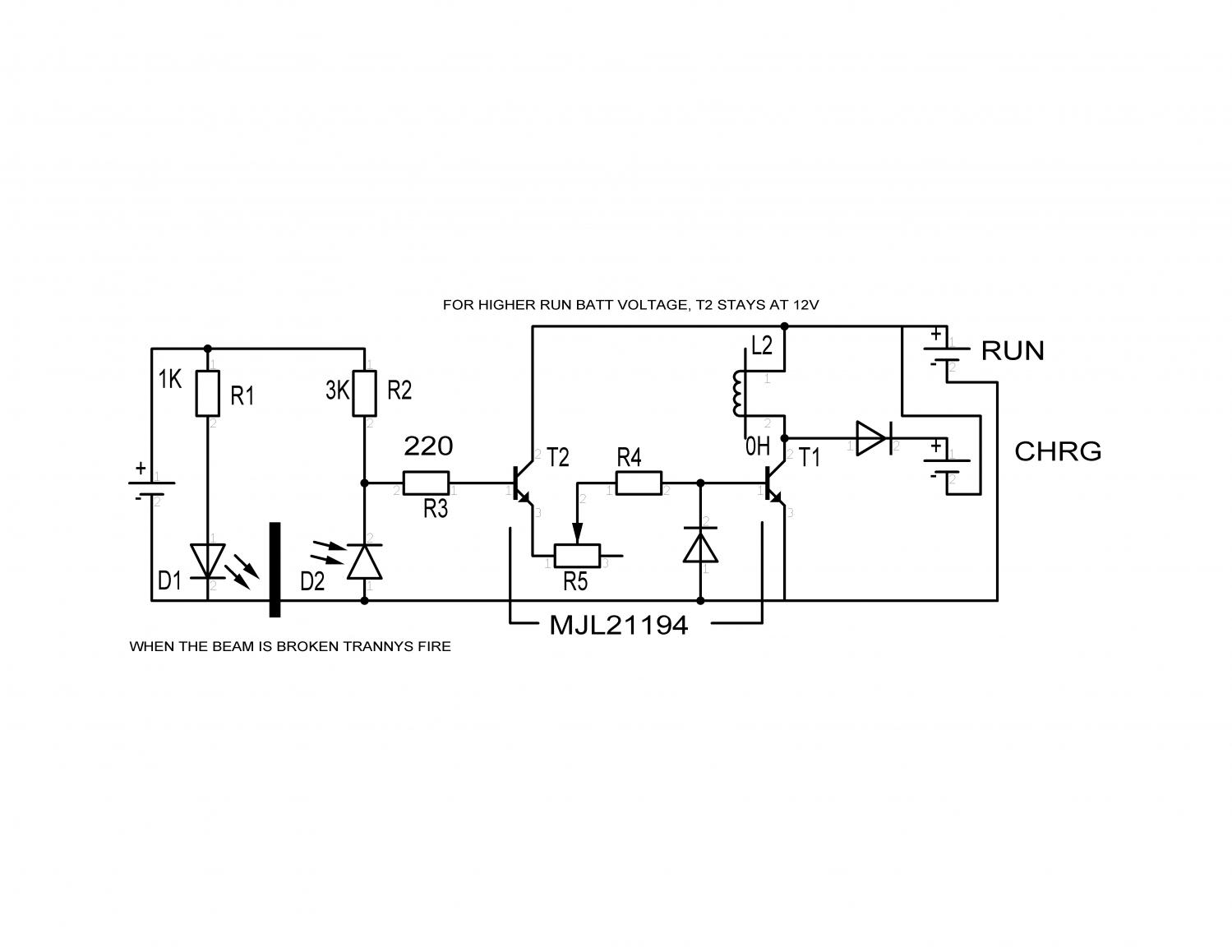

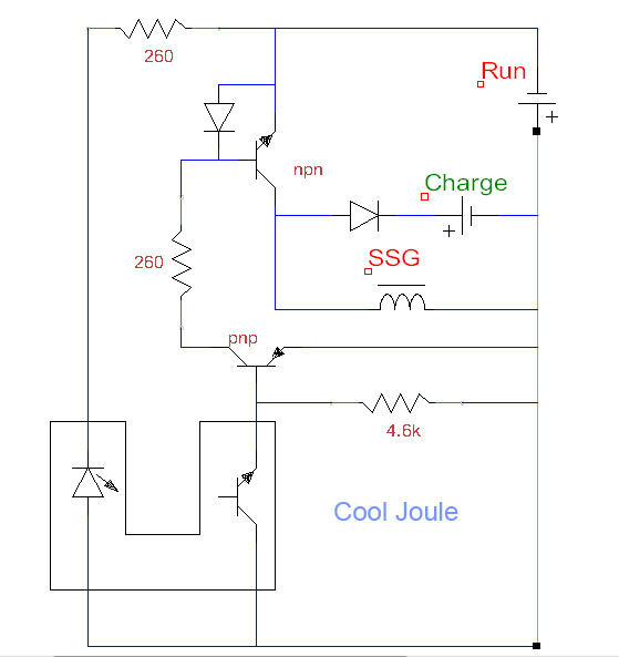

so check Gary's post 19 the hall is triggering 2 pnp's (interesting use of two...) which go on to trigger many NPN's - so for this opto/phototransistor do the same thing only picture 1 pnp instead of two.
Again, your drawing does NOT picture a phototransistor, what are you using instead?
That's some nice speed you're getting, how about the charging?
once you start using other methods to trigger the "SSG" you now have to consider timing vs charging - yes :-)
