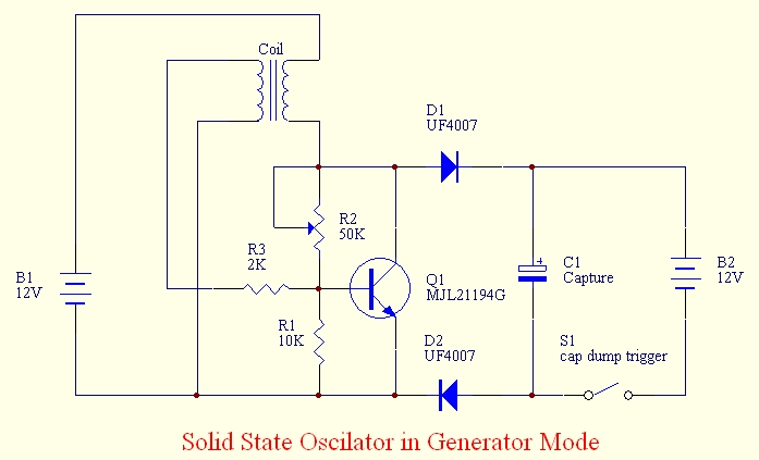

For my 81 strand solid state the wire is Gauge 23 and the resistance per foot is 0.02036ohms and it measures 3ohms per strand. So the estimate length is 3 ohms / 0.02036 ohms per feet = 147.35 feet
After reading thousands of posts form the monopole groups, I picked up that is makes no difference if you twist the wires or not, with regard to the performance of the coil, twisting the wires only makes it neat and tidy. The down side of twisting the wires is that you lose some of the length of your multi-strand wire/cable which means less turns.
When I wrapped many rolls of insulation tape around the 81 strand cable, I realized that a cable this thick may not need twisting together, just tightly wrap insulation tape around the multi-strand cable. Then you will get a couple more turns around the spool.
