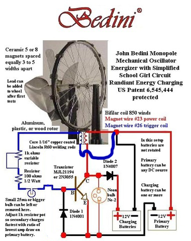

Instead of connecting the the trigger bottom to ground (emmiter) you connect it to Primary Pos. The trigger is no longer working via induction but rather by a primary feed. The circuit goes into self oscillation. This is a typical solid state as first introduced by Patrick who also made many videos of it. It is literally the same circuit accept the movement of the trigger from ground to pos. I say it is typical because I have made other solid states that were not the same and I am not talking about those.
