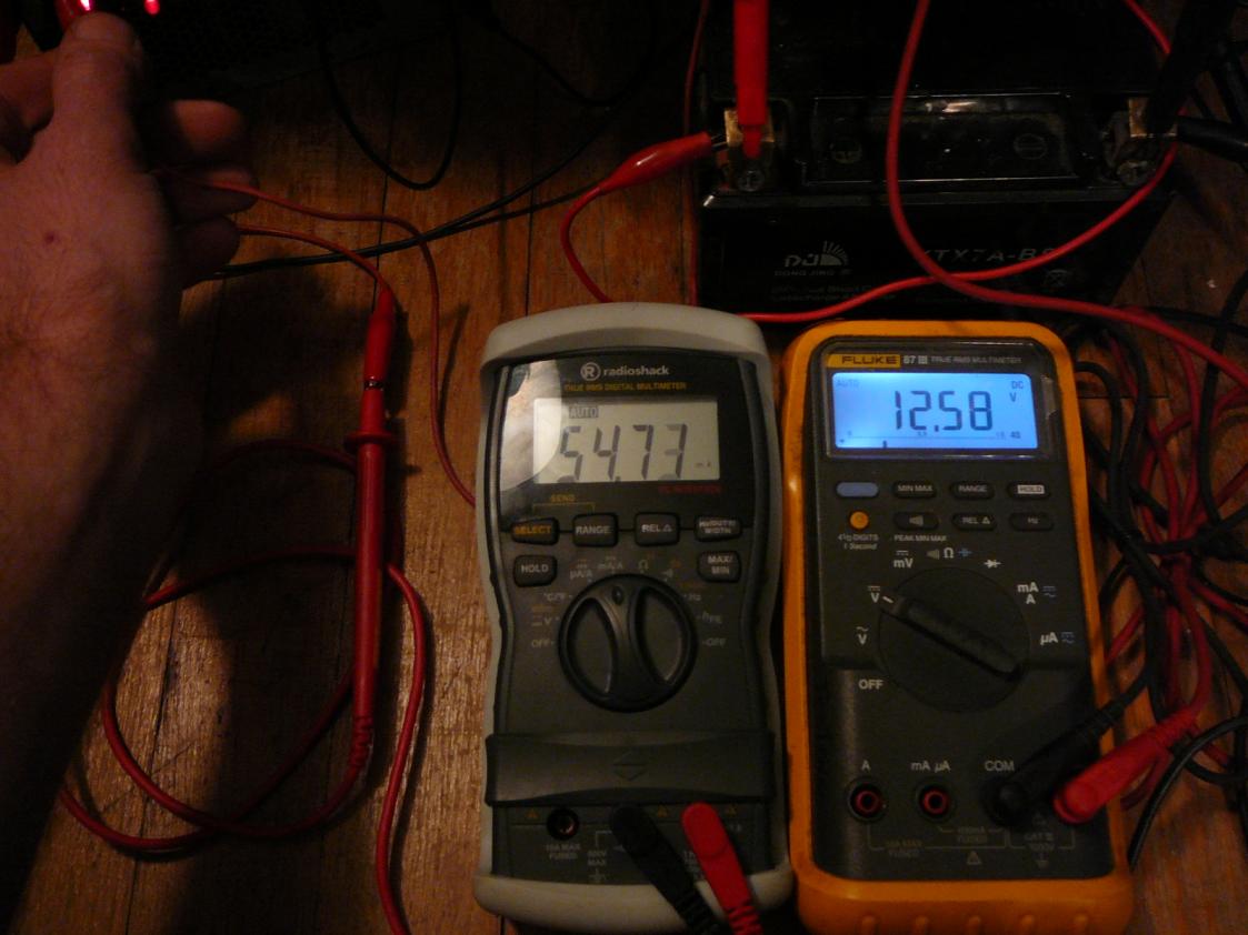

These are just the results over the last 30 minutes, and I'm going to leave the machine on these settings over night and also see how much the voltage settles when i take it off of charge.
I have it running off of a modified PSU from a PC @ 12.6V, and it is running at 60mA.
8:15 - 12.35
8:23 - 12.36
8:34 - 12.38
8:42 - 12.39
8:48 - 12.40

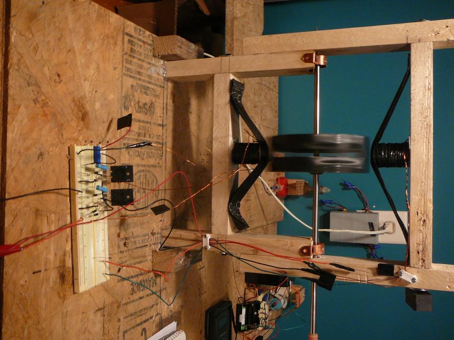

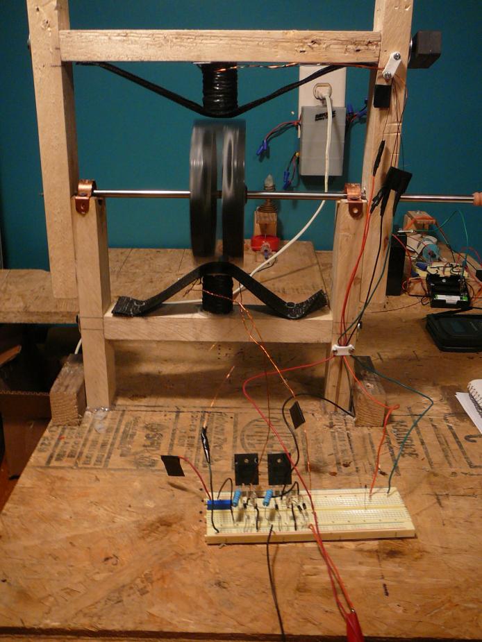

It doesn't meet any of the recommended build specs... C8 1 7/8 x 7/8 x 3/8 (x4) on a CD size rotor, with two coils at 180*. Coils are 450T #22 and #26, and on the 2nd coil I am only using the #22. MJL21194's - 47 ohm base resistors and 1K cermet pot - and the rest is what is recommended on the basic SG circuitry. Oh, and I am charging a 12V 7Ah battery that started at 12.22V. (I ran it for a bit before I tuned it to it's current settings. I will measure the resistance on the 1K pot when I shut it off tomorrow....
Is this something I should be excited about? Or is this fairly typical? I read on the fight-4-truth Bedini notes that I printed off that Erwin was happy about having his system run at 2.5A...
I don't load the front of the coil too tight with too much wire on those. Some of my best coils are almost V shaped at the point so there is less interference between wire and magnet. I guess one could just push the core forward a bit as well.
