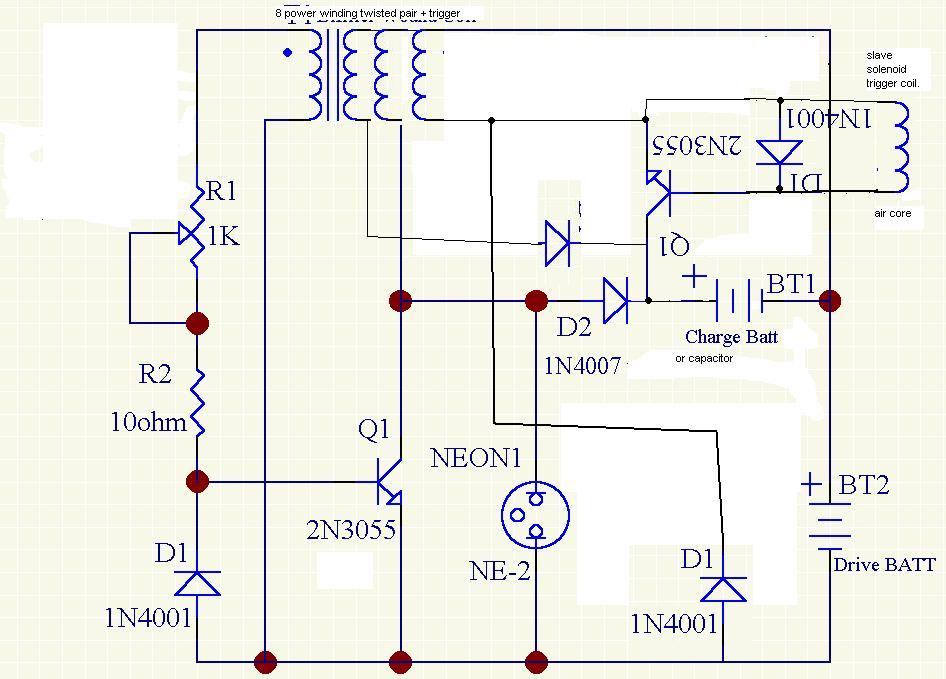

    i tried an experiment this morning, seeing if i could take the output of the ssg and use it to fill a capacitor and then using a transistor pulse the charge back into the coil at the right time using a slave trigger coil at the virtual south pole point.
    the thing accelerated like i have never seen before, and when i connected a battery instead of a capacitor it seemed to charge extremely well and started spinning upwards of around 10,000rpm (hard drive platter rotor) at a best guess! needless to say i left the room as i was quite curious what would happen, and it was lucky i did as it accelerated to the point of rotor failure with a bang.
    has anyone tried this before? i expected a longer spin down time or less input and no charging of the battery, instead the battery was going up at a rate higher than i have seen on the machine.
    heres a circuit diagram, someone make it and see if it works, you need to move the slave coil untill you get the sec battery going up and the rpm going up, i was also running a winding on the coil that wasnt powered to collect energy thru a diode to the output bus.

    Hi bigmother, I'd like to try this but have a couple of questions first.
    1. What is the purpose of the diode between drive battery negative and the bottom of the third winding?
    2. Is the 3rd winding part of the main coil, or is it part of the slave coil (bifilar)?
    Thanks for sharing your work

      The diode conducts the inductive collapse from the repulsion coil winding that is being driven by the capacitor or battery that is being charged back into the primary circuit where it probably ghosts, i checked power thru flow with an led and it blew, so i checked again with a led resistor combo, and it lights up.
      the 3rd winding is just a coil that wasnt being used on an 8 filer 0.5mm twisted coil, i ran 2 transistors bd243c on the drive transistors that powered the attraction winding, and a 2n3055 on the feedback repulsion circuit there is no bifiler coil its 8 strand, the slave coil is an air core mini spool of around 0.4mm and about a hundred grams or so.
      if your doing this suggest you do it at low power, i have a very small ssg and was pushing it too hard, there was no way i was staying in the room when it took off, power draw was at 700ma and rising the charge battery was going up from about 11.7 to 12.2, it is a deep cycle 110ah marine battery, quite ruined suplphated boiled who knows, they were junk when i got them, they are getting better slowly but they ping a 7amp car charger so they take a bit of current to push up.
      I woulndt be surprised if dc was getting through from the primary to the sec battery capacitor i am not sure, you will need to test this i didnt get a chance to, i know they say you cant loop back to batteries that are being discharged so it could just be acting as a second winding powered through the secondary battery, but its always worth having a play to see what happens,
      if i had a cap dump i would try the same thing with an opto sensor linked up to trigger it, you will have to get a quick discharge so small uf and low resistance windings for quick pulse duration otherwise you will cogg the rotor down hard and damage things.

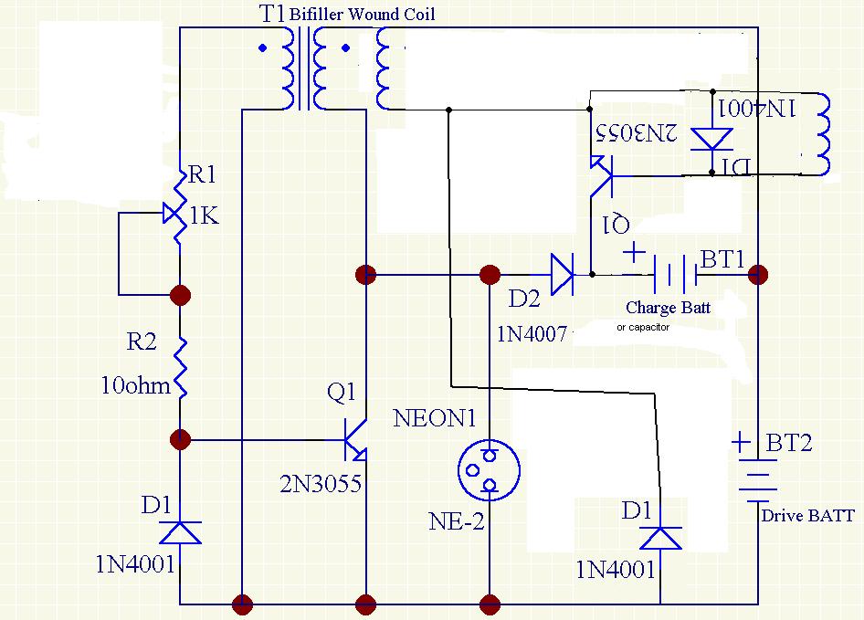

        This is a quick update to correct the circuit

              It works. Sweetest little inductively triggered circuit I have played with in a while. It still suffers in the all too familiar manner though, in that if you want to increase the throughput, most of the energy is wasted as can be measured by the heat output in the base resistors. Awesome method for reusing the recovery though. I tip my hat to you. Apply this to a circuit where you don't have the associated trigger losses, and you have a winner in my opinion.

                  Your Schematic.
                  Hi Bigmotherwhale,
                  I'm baffeled with the orientation of Q2(Transitor), and how does it switch with no ground connected...???
                    Hi Bigmotherwhale,
                    I just pondered and i'm able to figure it out, the Circuit is very unusual to the conventional mode in that the Inductor is switched in the Emmitter section of 2N3055 Transistor.
                    This is a topology of Inversion coupling between the first (Usual SG Switching)and this mode (second) of orienting the Transistor.
                    Further it does not give a picture of the need for the Slave Coil...
                    Faraday88

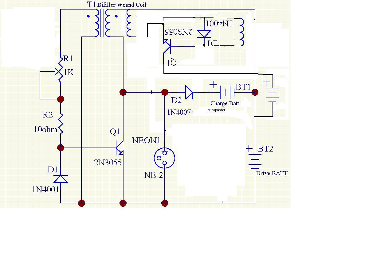

                      The transistor is set up emitter follower - common collector, you could try to connect the slave coil from the positive of the drive battery to the the base to include the trigger current in the output coil - as i say you can try, not saying it will work that way, if you do and it works please let me know, its the first experiment i would try if i had a rotor.
                      there are some experiments i want to try running in emitter follower mode,
                      i dont see how it would work without the slave coil setup in this way

                              I have made some new rotors quickly, and tested the circuit but with 2 drive batteries and a charge battery, in push pull, attraction repulsion, one drive bat for pull and one for push, its a half bridge circuit.
                              it works well but not as well as with the other coil running off the charge bat, it didnt try to climb and climb it just stayed at its sweet spot. oh i forgot the diode from the collector of the upside down transistor to the + of the charge battery in the diagram.
                              charging seems really good, better than running 2 transistors in one current direction, and higher rpm, i will know how well it charges tommorow.
