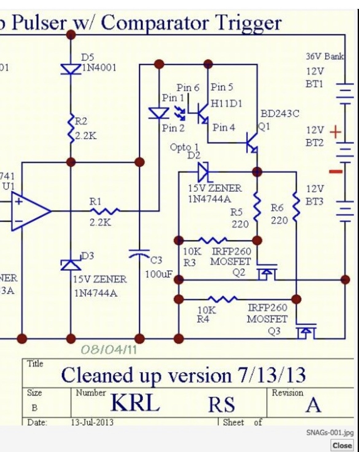

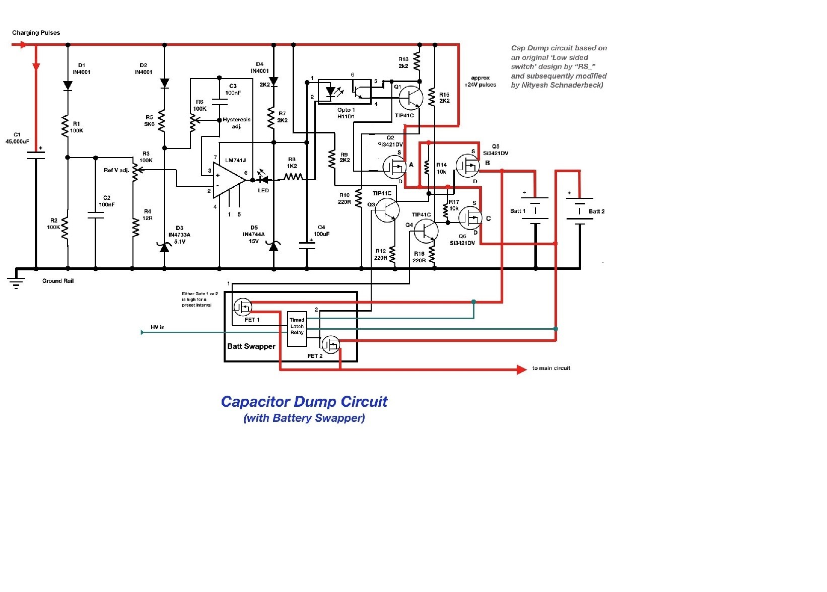

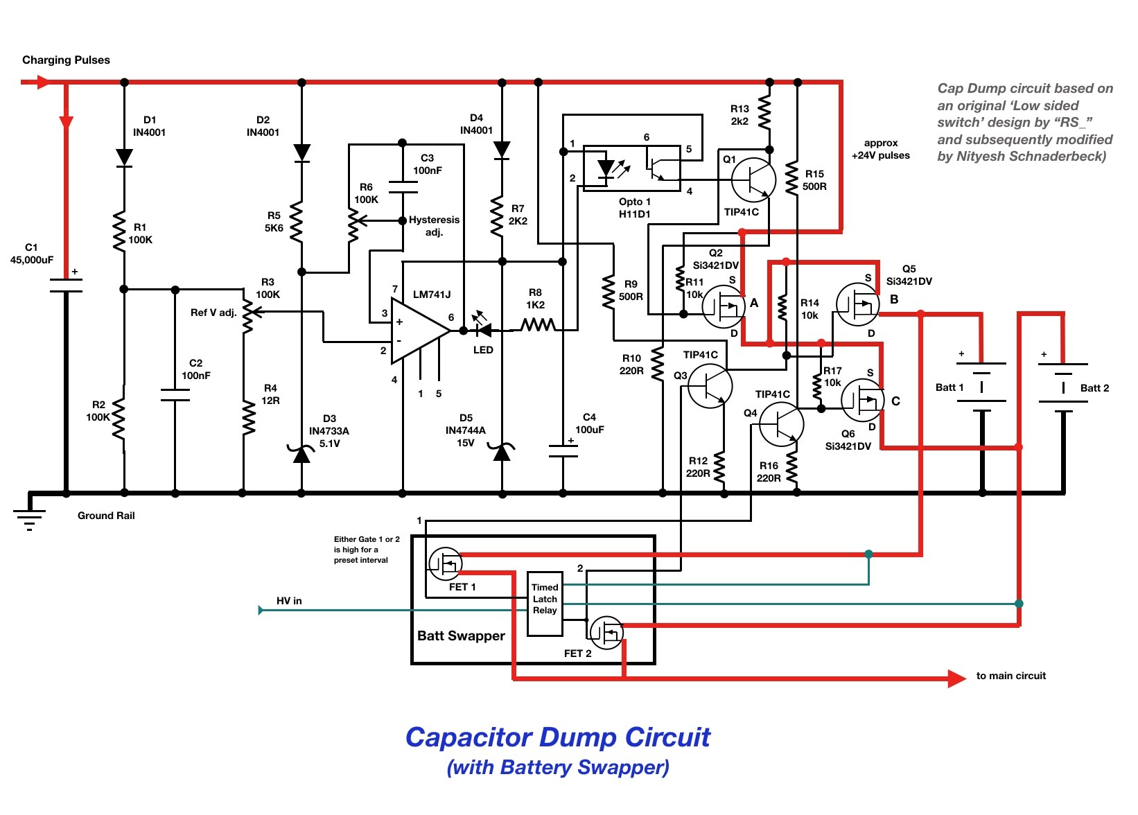

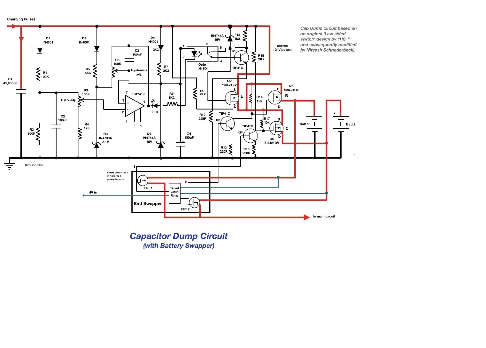

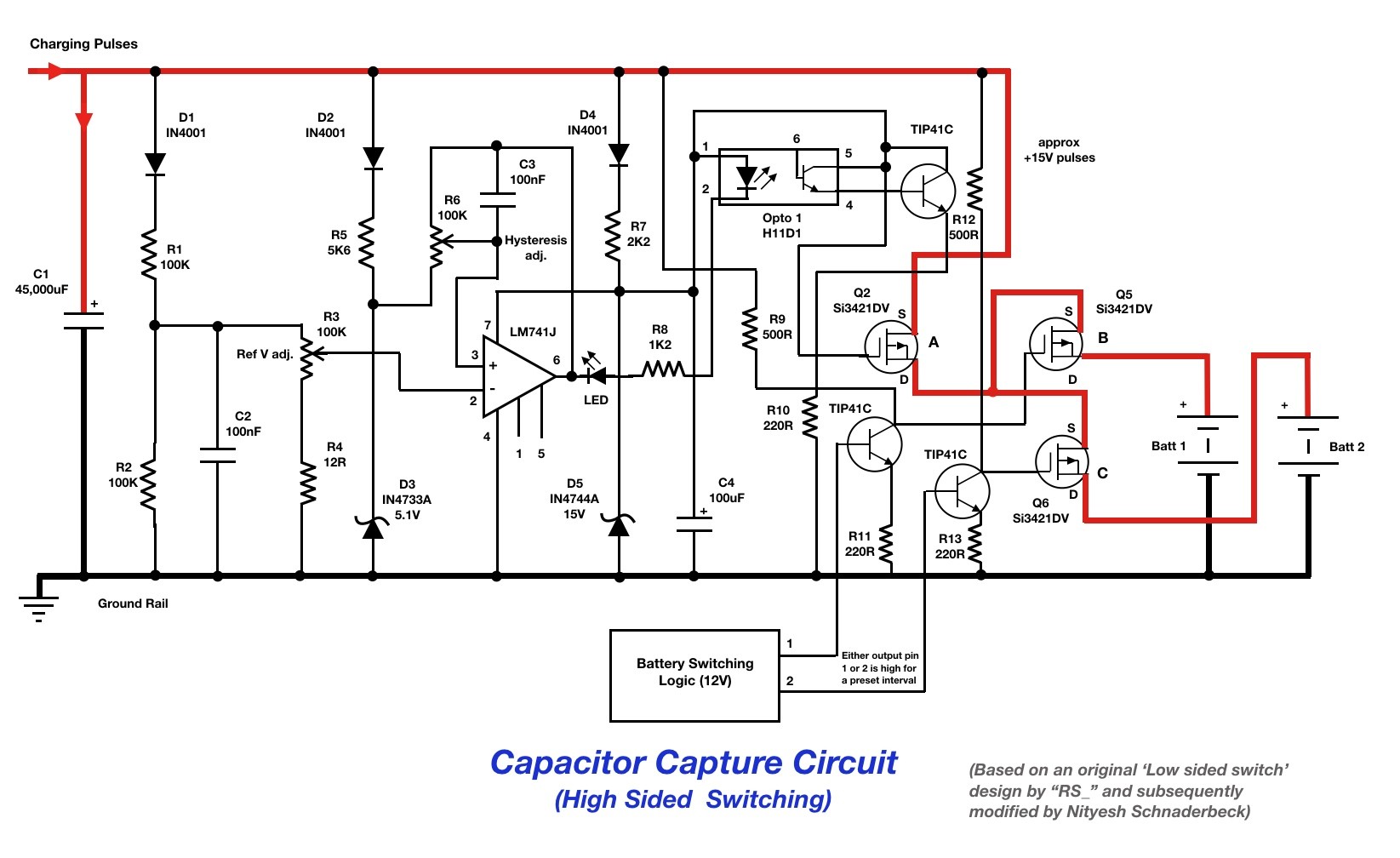

I have modified a design for a capacitor capture circuit that recycles BackEMF pulses by charging a large capacitor and periodically discharging it to one or other of two lead-acid batteries. (The reason why there are two batteries is that at any moment one of them is also receiving the BackEMF pulses directly and these batteries don’t like providing charge for the main circuit and simultaneously receiving these pulses).

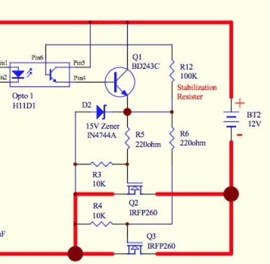

The intended circuit operation is this: when capacitor C1 reaches a voltage set by the adjustment trimmer R3, it allows the LM741 to trigger an optoisolator which then operates a P channel FET (Q2). As a high-sided switch, this lets through the pulse, at say 15V, to one or other of two P channel FETs (Q5 and Q6) which are on or off depending on the ‘battery switching’ logic provided by another part of the circuit (either output 1 or 2 is a 12V high). Therefore one of these two FETs will pass on the pulse to one or other of the batteries.
The discharging capacitor will stop releasing its charge when its voltage drops to about 9V and this value, the hysteresis, can be adjusted with trimmer R6.
My query then is about whether the way I have set up the three ‘high sided’ switching FETs will work as intended (the original design used two N channel FETs in parallel for low-sided switching), or if I need to include any additional components, or perhaps different values of those already included, or modify the circuit.
