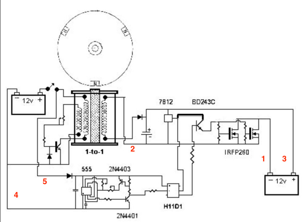

    Hi Claudio,
    Originally posted by claudio View Post
    [ATTACH=CONFIG]7264[/ATTACH][ATTACH=CONFIG]7265[/ATTACH][ATTACH=CONFIG]7266[/ATTACH]
    The schematic you posted is for an SG with an isolated collection coil.
    Since you are using the Teslagenx coil with 7 power windings (and 7 transistors) you need to connect #2 directly to the run battery. If you connect #2 to the run battery positive, the machine will run (and charge the cap) in "radiant" mode. And if you instead connect #2 to the run battery negative, the machine will run (and charge the cap) in "generator" or "common ground mode".
    Common ground mode charges faster than radiant mode.
    Where is your ammeter?
    When the caps discharge, they deliver in excess of 100 amps almost instantly to the battery. Don't try inserting anything between the output and the charge battery, as it will reduce the charging effect even if it isn't fried by the high current pulse! Keep the impedance as low as possible!

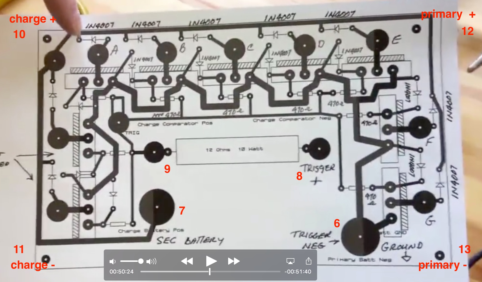

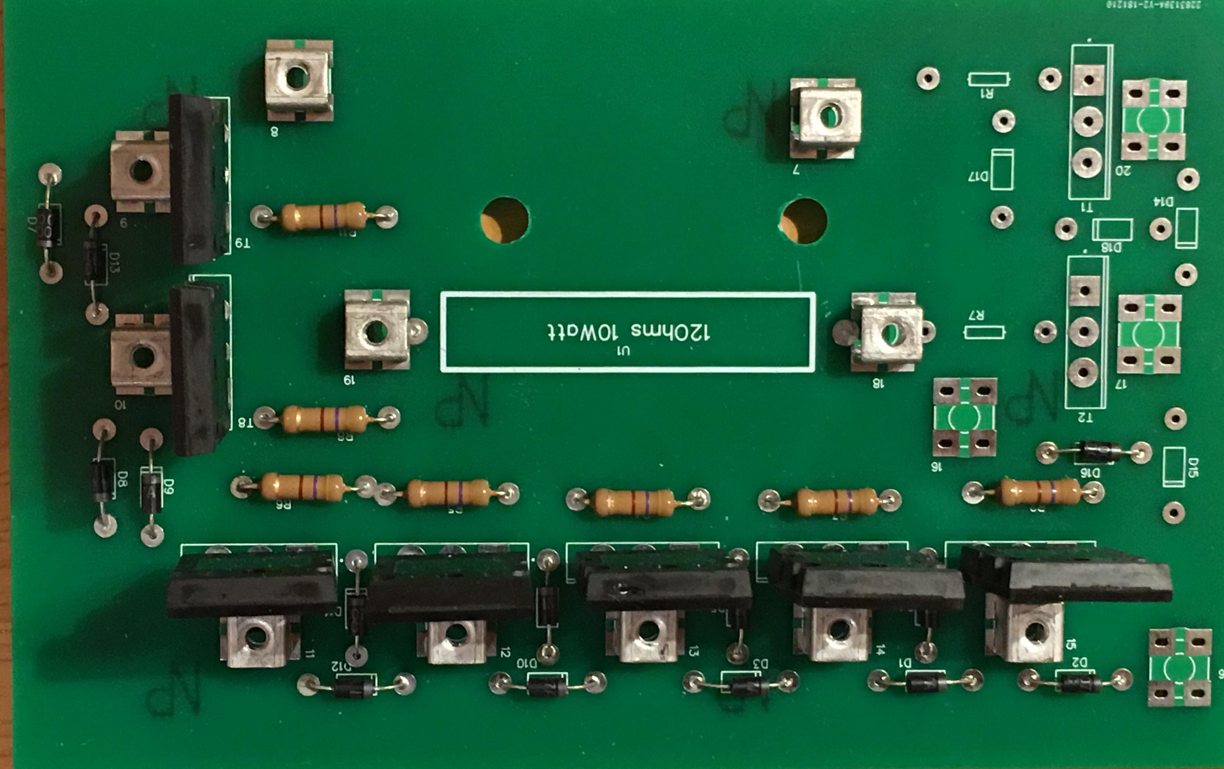

      how do I connect this:
Name:	schema circuito3.jpg
      To this ?
      I put numbers to explain connections...
      please help...

        Hi Claudio,
        The numbers you put on the drawing of the back of the circuit board don't match the numbers printed on the front side of the actual board!
        #8 on the actual board is the primary battery negative (ground) and trigger winding negative. You have it labeled #6 in the drawing of the back of the board .... should be #8 instead.
        #7 is correct both places and is the positive output to the charge battery and cap dump.
        #19 on the actual board is for the trigger coil positive lead (this is wrongly marked #8 on the drawing of the back side).
        #18 on the actual board is incorrectly labeled as #9 on the drawing. This connection is for an alternate (lower resistance) positive trigger winding connection to bypass the 10 ohm resistor.
        #9, #10, #11, #12, #13, #14, & #15 on the actual board each go to a separate power winding on the bottom of the coil. ........... (#10, #11, #12, & #13 on the drawing shouldn't even be there. They are shown in the corners where there are no connections.)
        The top of all the power windings of the coil should be fastened together and attached to the run battery positive post.

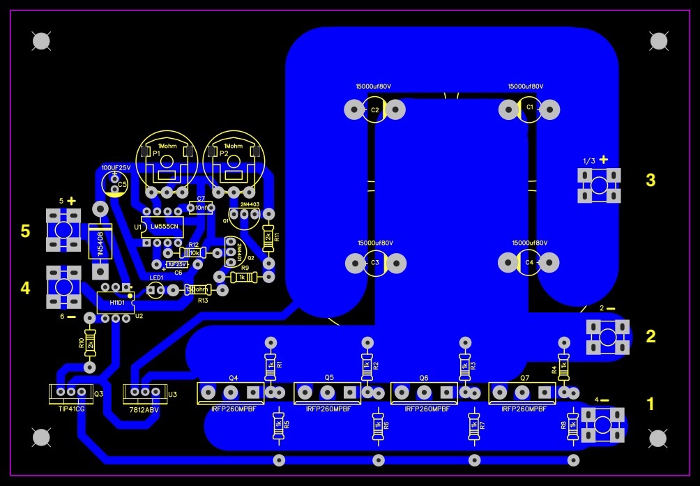

        Now to hook up the cap discharge board. #5 on the cap discharge board is connected to the run battery positive post, and #4 on the cap discharge board is connected to the run battery negative post. This supplies the power for the 555 timer and trigger portion of the board.
        #3 on the cap discharge board is connected to #7 on the SSG board and also to the charge battery positive post. These should be large wires. At least #8 AWS.
        #1 on the cap dump board should be connected to the charge battery negative post with large wire (#8 AWS).
        #2 on the cap dump board can be connected to either post of the run battery again with #8 wire. When connected to the negative post of the run battery, the SSG is running in "charge" (common ground) mode to supply the caps. And when connected to the positive post of the run battery, the SSG is running in "radiant" mode to supply the caps. The fastest charging and more frequent dumping is with "common ground" mode.
        When you make the final connection between the SSG board and the cap discharge board for the first time, you will get a big spark as the caps charge up to the battery voltage! This is normal, but a little spooky if you're not looking for it. This is only momentary as you can tell if you disconnect and then reconnect.

          Hi Claudio,
          #3 on the cap discharge board is connected to #7 on the SSG board and also to the run battery positive post. These should be large wires. At least #8 AWS.

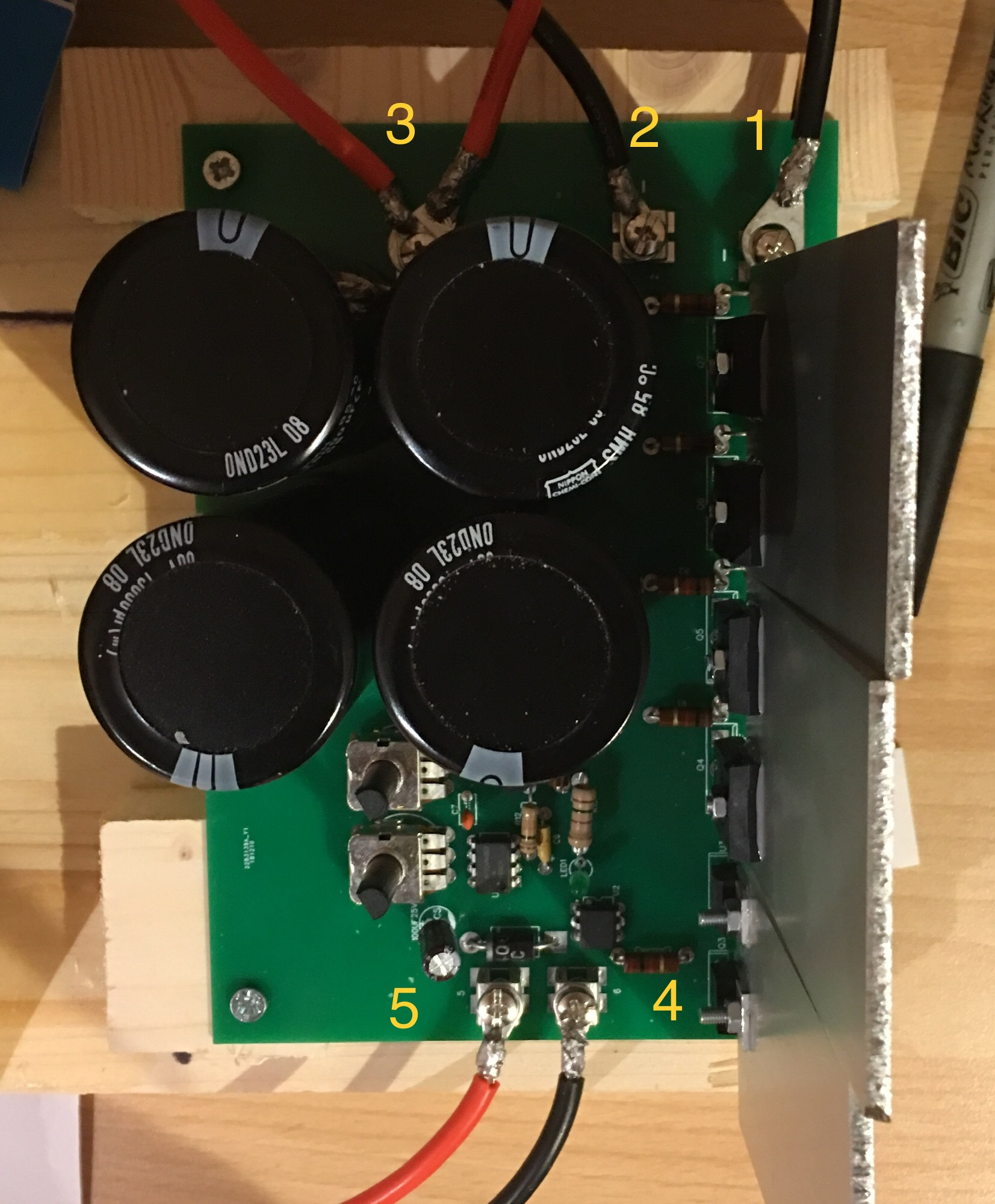

                Hi Gary,
                I connected everything and started the SSG, the green Led was pulsing but in about 5 seconds the 7812ABV chip burned !
                Should I replace it with a different chip or something is wrong with the circuit ?
                best regards
                Claudio
                  Hi Claudio,
                  Hi Gary,
                  best regards
                  Claudio
                  It looks like the regulator has a 400 ohm load which would be only 30 ma of current at 12 volts. This is well within the rating of the device. Plus it has built in current limiting for protection. However, the absolute maximum input voltage for the regulator is 35 volts. If this is exceeded for some reason, it would burn the device out. The only way this would happen is if the caps weren't discharging thru the FETs and into the charge battery.
                  You may have gotten hold of a faulty regulator. Either that or there is a circuit fault like a "short" or "open" somewhere. Make sure you have good connections to the charge battery. If the caps can't dump for some reason, the voltage on them will go too high and burn out the regulator. But 5 seconds sounds like too short of a time for this to be the problem.

                    Hi Gary,
                    thank you for waisting time for me...
                    I put a new regulator, but this one exploded after about 10 secs !!
                    I think the connections are ok..
                    Maybe there is a mistake in the circuit ?
                    I don't know what to do, please help..
                      Hi Claudio,
                      It's very hard for me to troubleshoot over the internet, but I'll try. It's much easier when I have the device in front of me and can use a multimeter and o-scope to help find the problem.
                      Since the cap dump is triggered by a time based device (555 timer circuit) and the LED is flashing, I think you can assume that portion of the circuit is operating correctly. It should flash the LED any time that 12 volts is applied across terminals 4 and 5 of the cap dump board whether the SSG is running or not.
                      And since the regulator only blows when the SSG is running, I think you can assume the FETs are not dumping the caps at all which causes the voltage on the caps to go way above 35 volts and probably much higher.
                      The H11D1 electrically isolates the higher voltage dump part of the circuit from the 12 volt timer part of the circuit. If either the H11D1 or TIP41 are faulty the FETs won't be triggered to dump the caps. And if all the FETs are faulty they won't dump even if triggered.
                      You can test the dump board separately without having it connected to the SSG. A 12 volt battery or power supply connected across terminals 4 and 5 will produce timed flashing of the LED which can be adjusted by the two pots. If you then connect 24 volts (batteries or power supply) across terminals 2 and 3 and a 24 volt light bulb across terminals 1 and 3, the bulb should flash each time the LED flashes. If the bulb doesn't flash then you can check each FET, the TIP41, and H11D1 with a multimeter to find which part is not working properly.
                        Hi Claudio,
