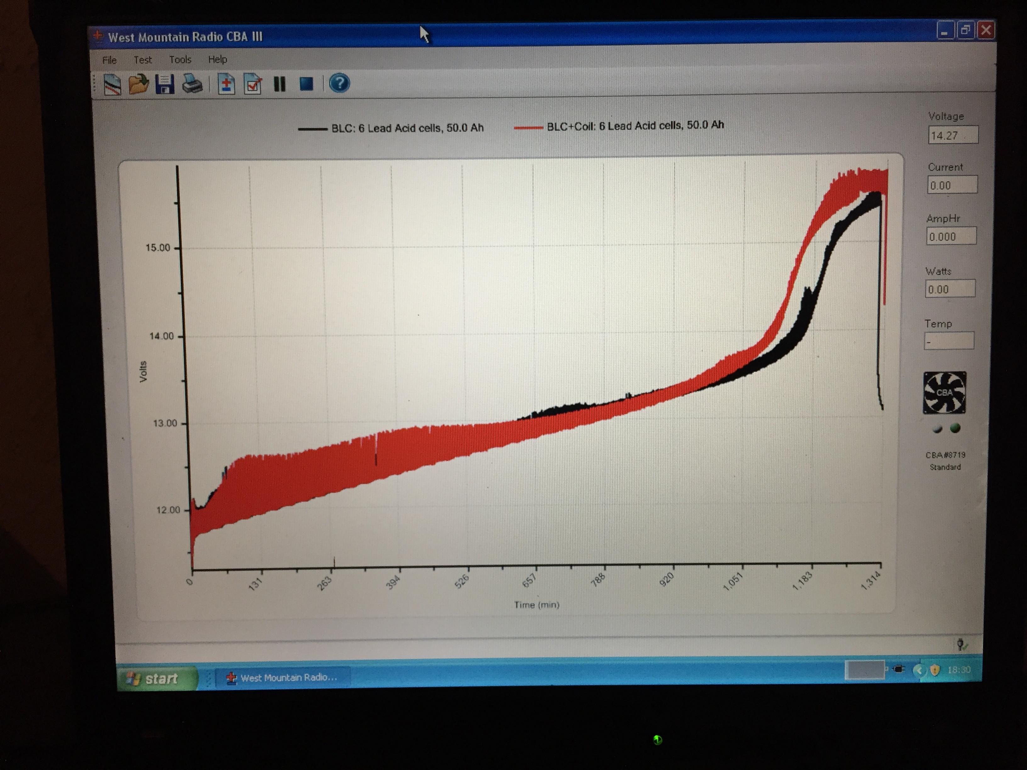

I wanted to prove whether or not pulsing a coil with a cap pulser was providing any extra benefit, rather than just directly charging a battery with a cap pulser.
Here's a charge chart that shows that pulsing a coil with the Bedini Large Comparator reduces the charge time with the same input.
The black charge curve is displaying the battery being charged with just the output of the Bedini Large Comparator (BLC). The input to the BLC is a lab power supply that has the current set at 2.0A. The BLC is set to discharge the capacitors at 25V.
The red charge curve is displaying the battery being charged with the BLC and the coil, as per the previously posted schematic. The input to the BLC is a lab power supply that has the current set at 2.0A. The BLC is set to discharge the capacitors at 25V.
As you can see by the below chart, the battery was completely charged about 1 hour faster by pulsing the coil with the cap pulser, as opposed to charging it directly with the cap pulser.

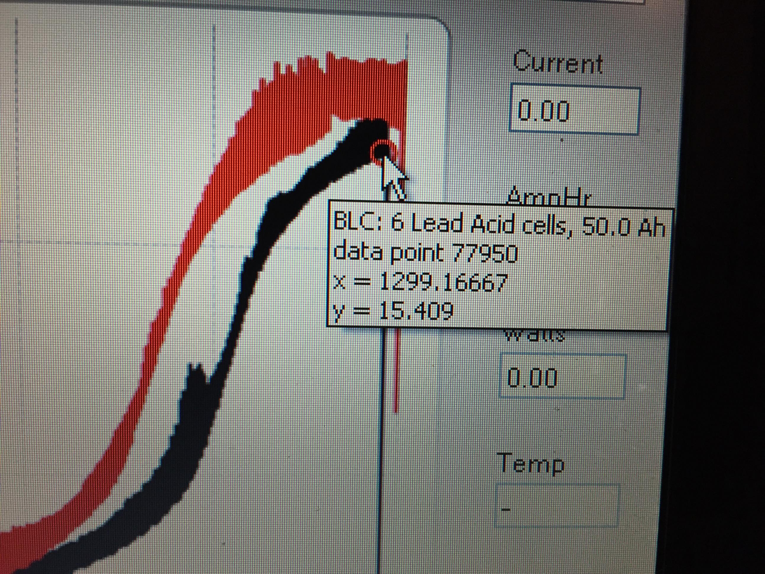

Below is an enlarged part of the last part of the black charge curve, showing the battery was charged to 15.409V in 1,299 minutes.

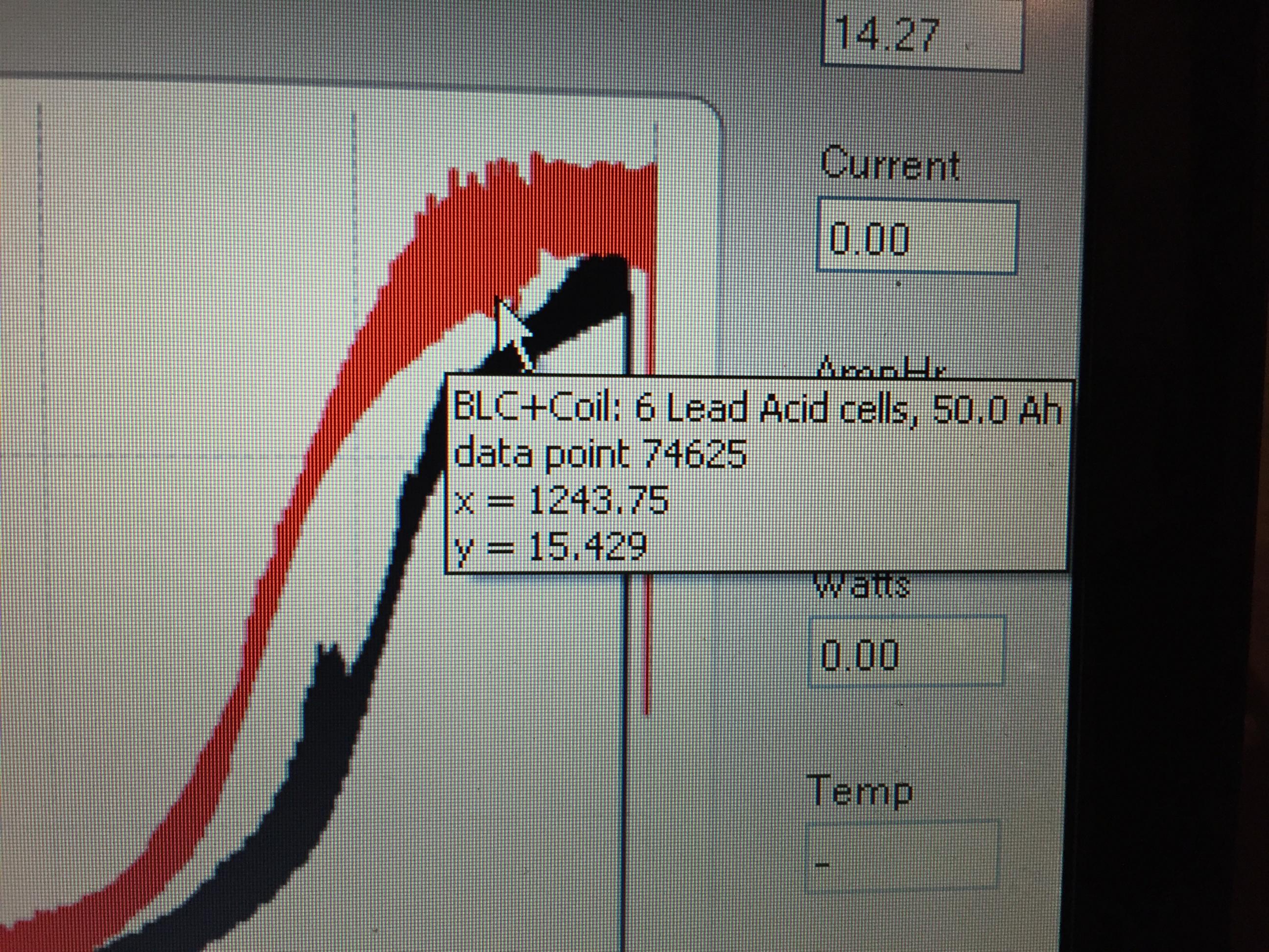

Below is an enlarged part of the last part of the red charge curve, showing the battery was charged to 15.429V in 1,243 minutes - a slightly higher voltage in 56 minutes less.
This a approximately a 5% reduction in charge time.
