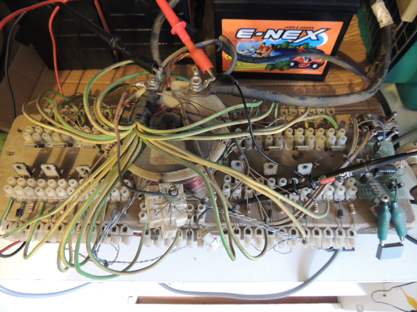

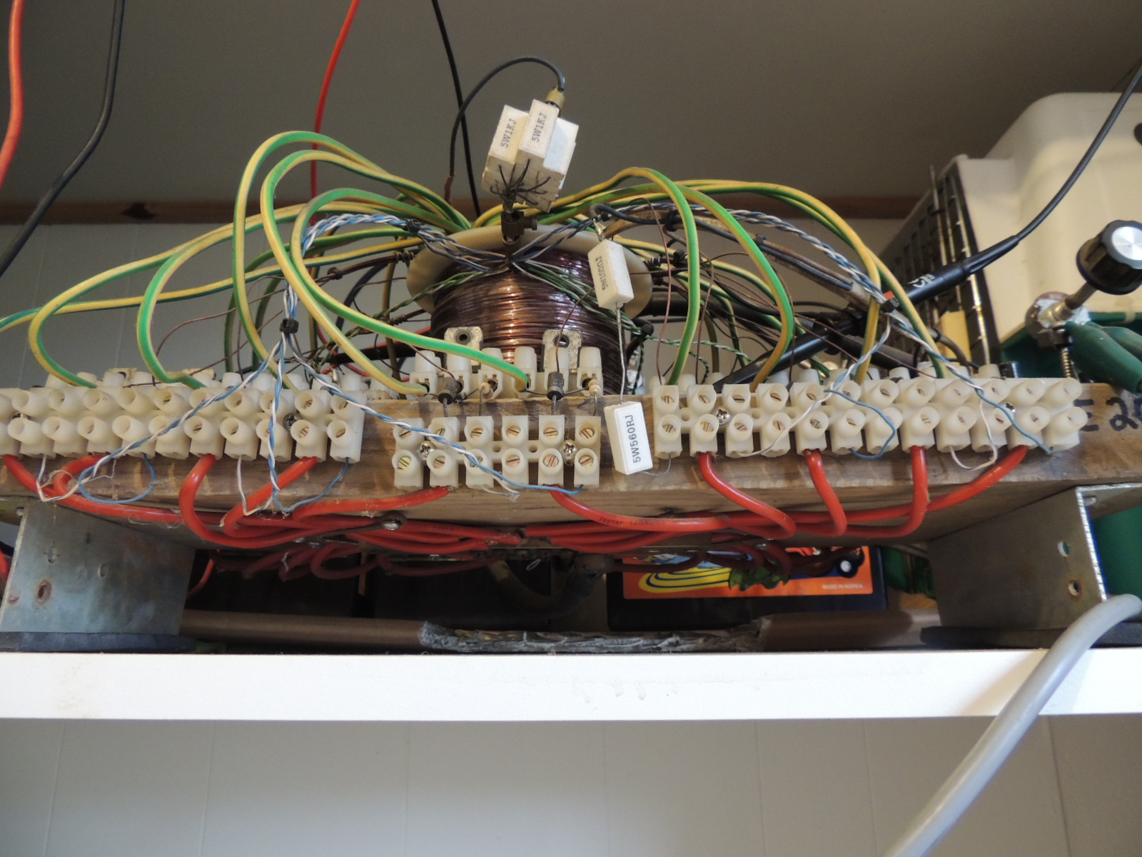

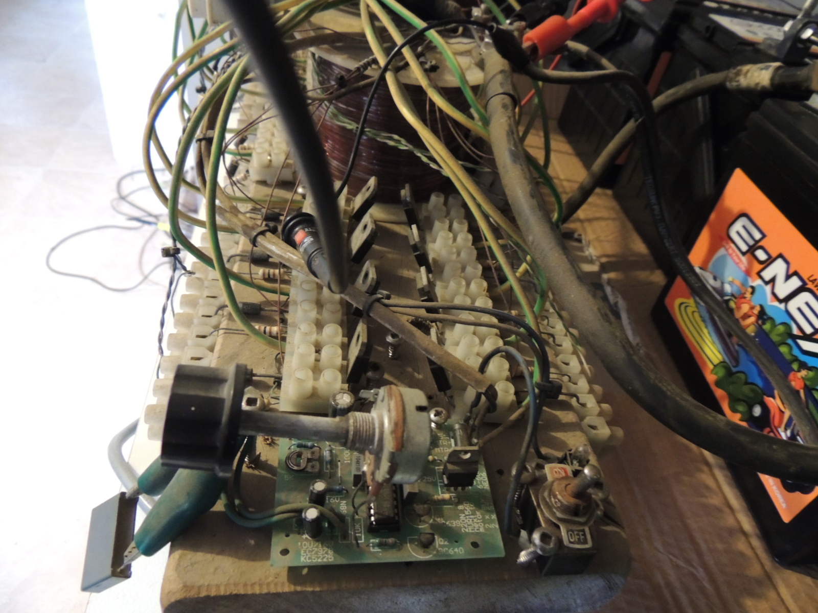

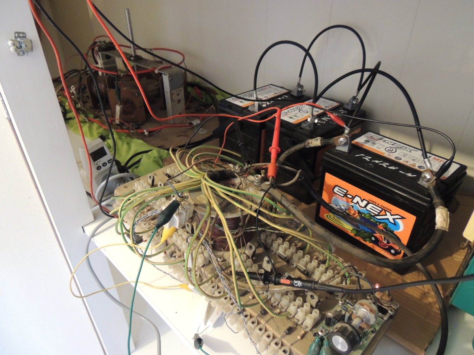

Hello John and the forum members hope your day of experiments are going well . Thought id start a thread hear since i only found out about this forum the other day and its been a while since ive talked experiments with anyone (just getting back into it) but i still have the passion . Here is a solid state Bedini i built years ago and its still my best preformer (very close to 1 to 1 ) i just want to talk with like minded people as i feel a bit on my own at the moment (no one doses this stuff where i live ) i read all day yesterday on this forum , great advancements going on and i love hearing your advice John if you read this ( i hate normal textbook stuff ) the energizer im showing is the SSG circuit triggered by a motor controller and is pulse adjustable . Dam it got to go my girlfrined is home with our dog (it broke its leg the other day ) be back soon as i can cheers jason
20 transistor solid state Bedini energizer
Hi Jason,Originally posted by Jason 7 View PostHello John and the forum members hope your day of experiments are going well . Thought id start a thread hear since i only found out about this forum the other day and its been a while since ive talked experiments with anyone (just getting back into it) but i still have the passion . Here is a solid state Bedini i built years ago and its still my best preformer (very close to 1 to 1 ) i just want to talk with like minded people as i feel a bit on my own at the moment (no one doses this stuff where i live ) i read all day yesterday on this forum , great advancements going on and i love hearing your advice John if you read this ( i hate normal textbook stuff ) the energizer im showing is the SSG circuit triggered by a motor controller and is pulse adjustable . Dam it got to go my girlfrined is home with our dog (it broke its leg the other day ) be back soon as i can cheers jason
Change your SSG into an Air core coil and watch the difference... I guess you are using the PWM out put of the Motor controller to drive the SSG coil.. what is the frequency..? Duplicate the coil ..this time in the reverse direction and use it in conjunction with first...watch for the results..! let us know how is your dog doing now...
Hi there Faraday88 and others im finally back , our dog grommet has a cast on his leg and my girlfriends a bit sad but all is good, back to the speriment talk , @faraday88 thats for some info there , to do air core ill have to make a new energizer design as i need the core to make the controller have enough inductance to fire the trigger winding , but i might build another type of design to do more testing as the two coils of opposite polarity sounds interestin ( equalization of waves ) i done something like this years back but i was not understanding things as well as i do now so it didnt work how i wanted so i gave up . Yes the motor controller drives a second winding to then pulse the transistor base winding (Dual trigger system ) the two windings are isolated from each other and at opposite polarity umm yep that how its set up . The adjustable frequency is from one pulse every two seconds to a few kilo hetz . if i want to go faster i have to add more resistance to the base to narrow the input pulses so i can get more in per time frame but you can only get so fast per time frame other wise it will just be straight current . cheers Jason
