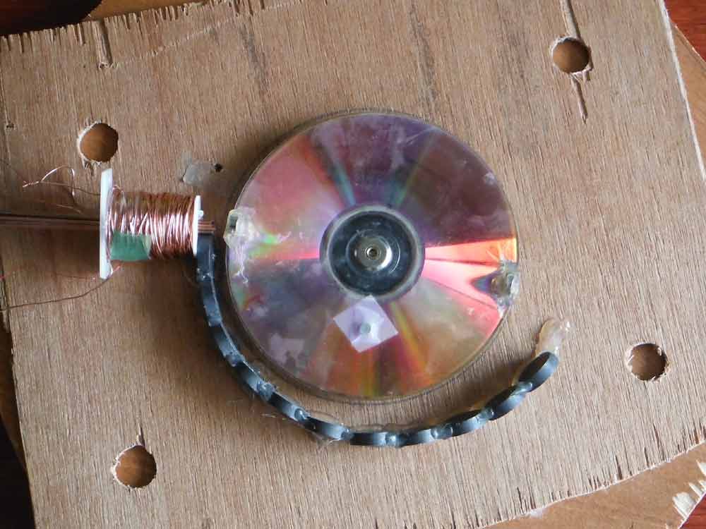

    I can't keep up with it all, but saw user "Bedini-Ukraine" was looking at superpole arrangements, something I have not done. Wanted to post this video of different magnetic arrangements in terms of rotational speed.
    Background:
    I first got this idea from video poster JZD14me https://www.youtube.com/watch?v=wBkvzbw5cDM he's got a physical bipolar commutator going on and I just thought this was interesting. Next Tom Bearden explained to me, in one of the energy from the vacuum series (will have to dig it out) that when you have magnets on a rotor offset from one another, a magnetic gradient is there that an electromagnetic core would "see". His explanation demystified the whole V-gate magnetic motor thing for me. He also mentioned that there were, before "hampered" attempts to commercialize this technology. I also saw 10 seconds of John Bedini having built something on this approach many moons ago. So I figured, really simple explanation that even I can understand, something like this was ready for commercialization, maybe even I can build something that would show a difference using super glue and masking tape. So this video looks at a progressive series of tests of further inset permanent magnets on a rotor.
    Discussion: I quite honestly, to my knowledge, and certainly never practically, have done anything over-unity. I realize more and more as I get into this why JB mentioned to just first do things exactly to his specs, I just have too much fun going all over the place. Don't know what would happen to the magnitude of the inductive spike with this set-up, that is an interesting question. Otherwise looks pretty good, in part 2 I will show how this set-up behaves at very low voltages, it just takes so long to video edit all this nonsense.
    On a different note, I have been thinking a lot about how to actually build this with some precision, when I talked to a machine shop I realized I was looking at 200-1,000 dollars for a stinking 6 inch rotor. I did a search on "Maryland 3D printing" and found that the county over from me started a 3d printing lab one month ago to increase the use and adoption of 3D printing. Also heard that a library in Washington DC has open time to print stuff on a 3D printer. So I am in discussions to actually do an improved version(s) of this rotor. More to the point, for maybe half of what people need to build that requires precision, there looks to possibly be an inexpensive way to do this with 3D printing.
    Here is the parsed video of the experiments
    Will post a video of this thing causing rotation at low volts next, but I think it is etiquette for stupid energy related videos to often have a bad soundtrack appended, to the extent possible will try to follow such in future. However, this girl went to high school a couple towns over from me, never heard of her until a few months ago, we lost her to melanoma a few years back so in place of a soundtrack to my video I give you the Great Eva Cassidy.

                    It has a lot in common with a Bedini SSG pulse motor/battery charger. In that machine as the iron core of the electromagnet comes towards a permanent magnet it is attracted to it, once past the magnet the sensor coil trips on the electromagnet and the electromagnet is now repulsed by the permanent magnet (in repulsion mode) hence rotation. The only difference here is that there is a ramp of magnets. The iron core first sees the most distant one and is slightly attracted to it. As it moves past that first magnet it then sees one just a little closer to it and so it is now attracted to that one, so on and so forth along the ramp of magnets until you are at the one right at the outside of the rotor and you do that same trick as in the Bedini SSG and just pulse the coil for a split second to get past the sticking point. As I figured that really gradually ramp up of magnetic field wouldn't work with a sensor coil set-up (I am not so sure now having played around with it for a bit but still don't know) I took a reed relay then used a second (double decker set-up) rotor, with just timing magnets to provide the pulse in the same place you would get with an SSG, despite there being this ramp of magnets. With just two single magnets, didn't write this down and might be making a big fish story from my memory but I think it took 1.0 or 1.2 volts for sustained rotation. It did better than that with more magnets added as a ramp and just the same two pulses each rotation. So in the Bedini SSG some of the rotation is from the permanent magnets and likewise with this alternative magnet arrangement. Not sure if that is any clearer but yes, you got it. its just like when Charlie Brown would always get a running start to kick the football than Lucy would pull it away at the last second. Can't say I have any copper magnesium cells, but an earth battery crossed my mind the other day, Saw a video where experimenter "lidmotor" ran a small SSG with one, would think this would run off one also. Right now though I am just sick of tying to place and glue magnets, hence the foray into 3D printing and hopefully I'll have a set-up where I can screw in and unscrew magnets. Of course the real magic with the Bedini SSG is with capturing that radiant spike and if for some reason this set-up doesn't produce a good clean spike then it might not work well as a radiant charger.

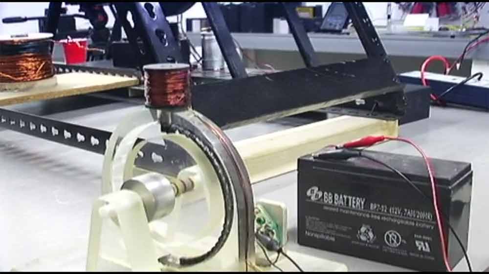

                        that is a wankel rotary magnetic motor concept. JB has one in his lab. small selenoid to push the rotor at the right time, his is built vertically, to harness gravity also.
                          Hi Tom,
                          I remember that one.
                          Energy From The Vacuum 16 Equilibrium
                          JB used repulsion, rotor is spinning clockwise.
                          Paul stick w/ your setup, I have not seen anyone do it that way. Of course I have not seen everything...
