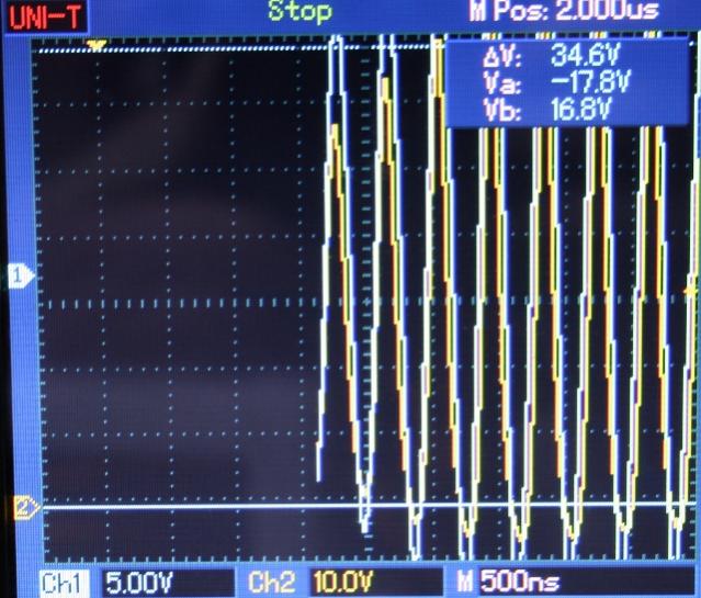

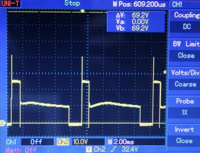

Photo 1 shows 'h' wave as produced from electronic trigger

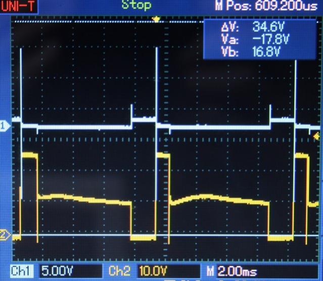

Photo 2 shows 'h' wave + trigger signal

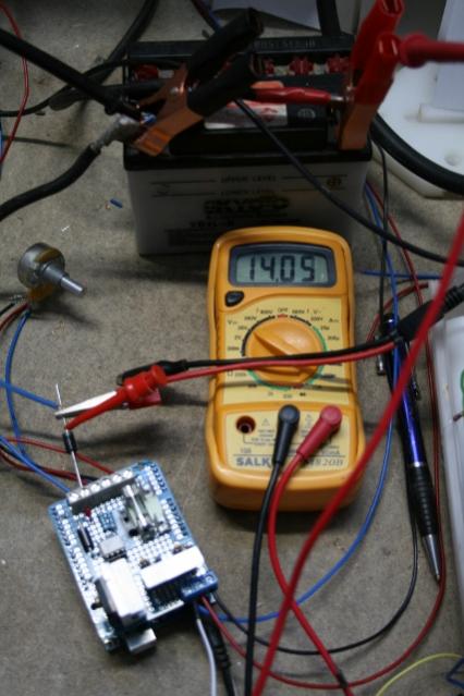

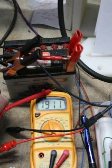

Photo 3 shows DMM reading secondary battery voltage

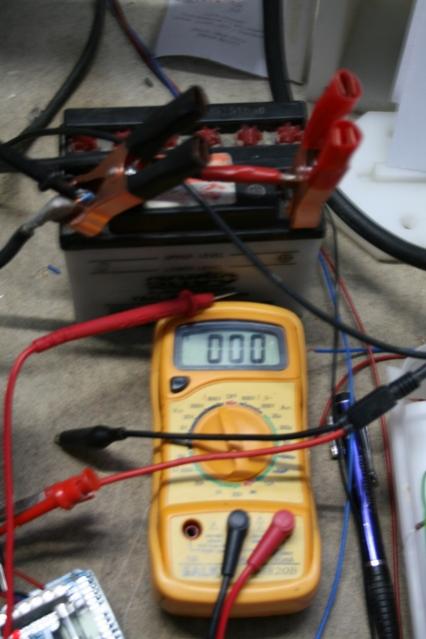

Photo 4 shows DMM reading 0.0 as the positive probe is disconected
Photo 5 shows DMM reading nearly 2000V with only the negative probe connected.
this does overload the DMM and a '1' is displayed.

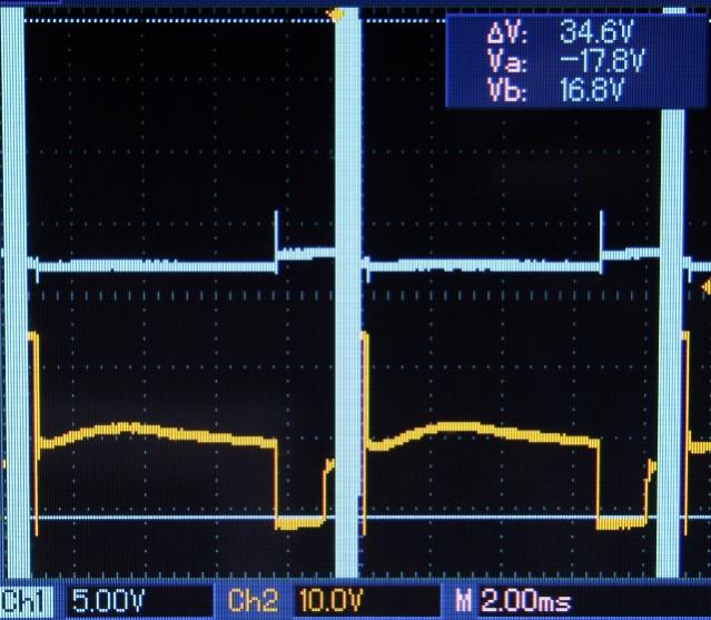

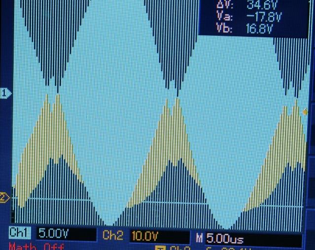

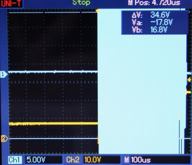

This anomaly happens at a certain setting on the potentiometer, as you will see in part 2 I have included further photos from the scope.
