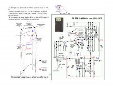

    I'm asked quite often about putting the plasma ignition on a motorcycle, but I'm always wondering about the CDI's that are so popular on bikes... can they be modified to produce the plasma like a car CDI?
    This site was sent to me that shows an example of a bike cdi diagram: http://mastercircuits.blogspot.com.a...08/dc-cdi.html
    The CDI module you see in those images or similar seem to be put on race bikes with no battery - my question is how is the cap charged with just a magnet on a flywheel that pass the coil 2 times per full cycle? It's normally wasted spark so it sparks on the compression and exhaust cycles.
    Does anyone know the setup for a bike CDI with no battery?

    Maybe some schematic is missing and the engine starts on inductive? Here a good thread on 1/3 of energy gos back too battery. http://speedtalk.com/forum/viewtopic.php?f=1&t=42274
      I know on dragsters my friends use magnetos, and many places on the internet says that motorbikes are powered by magnetos. That would then be the same principal than small generators and so on. But on our little Ryobi genie, it sounds like it spins at a very low rpm at start up, so I'm not so sure that the magnet spinning at that speed can produce enough umph, but maybe it does -very good question.
      It all comes down to that the faster the magneto spins, the more voltage the CDI primary gets, they say. Good for when the engine is already going, cause their is no load on the poor battery, if a battery is present.
      But because the magneto induces a (+) and (-) pulse into the pickup coil, one will have to make a plan with that pulse of the two that has the wrong polarity for the primary coil...
      Maybe have two parallel 1000A6 diodes inline to the primary coil, so that the wrong polarity pulse do not go to primar coil, but reflected off the diodes and captured by another cap, and that cap discharged though a bridge... so the primary gets sort of two pulses of only the one correct polarity (hopefully) - then a HV diode from secondary to primary (+) will make sense, IF the HV secondary output is (+).
