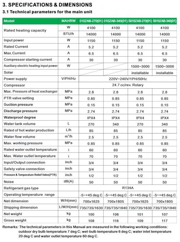

    The specs are below, basically it's 1150W, Rated current 5.2A, Max current 6.5A, Compressor starting current 30A
    Information about the power is listed below:
    Your Solarstream will require an approved, standard 240V 15AOn / Off switch or Junction Box in close proximity to the heater. It may be connected to a Standard Domestic tariff or Off Peak or Smart Meter connection. If the unit is connected to an Off Peak connection, the minimum power availability should be at least 6 hours per day.
    Can anyone offer some insight and recommendations on this idea? I'm thinking of getting a 24V 160A TST5 to cover myself for future power needs as well as this heat pump.

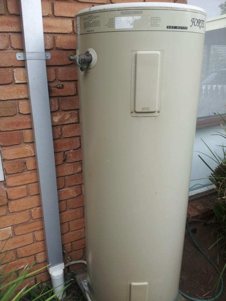

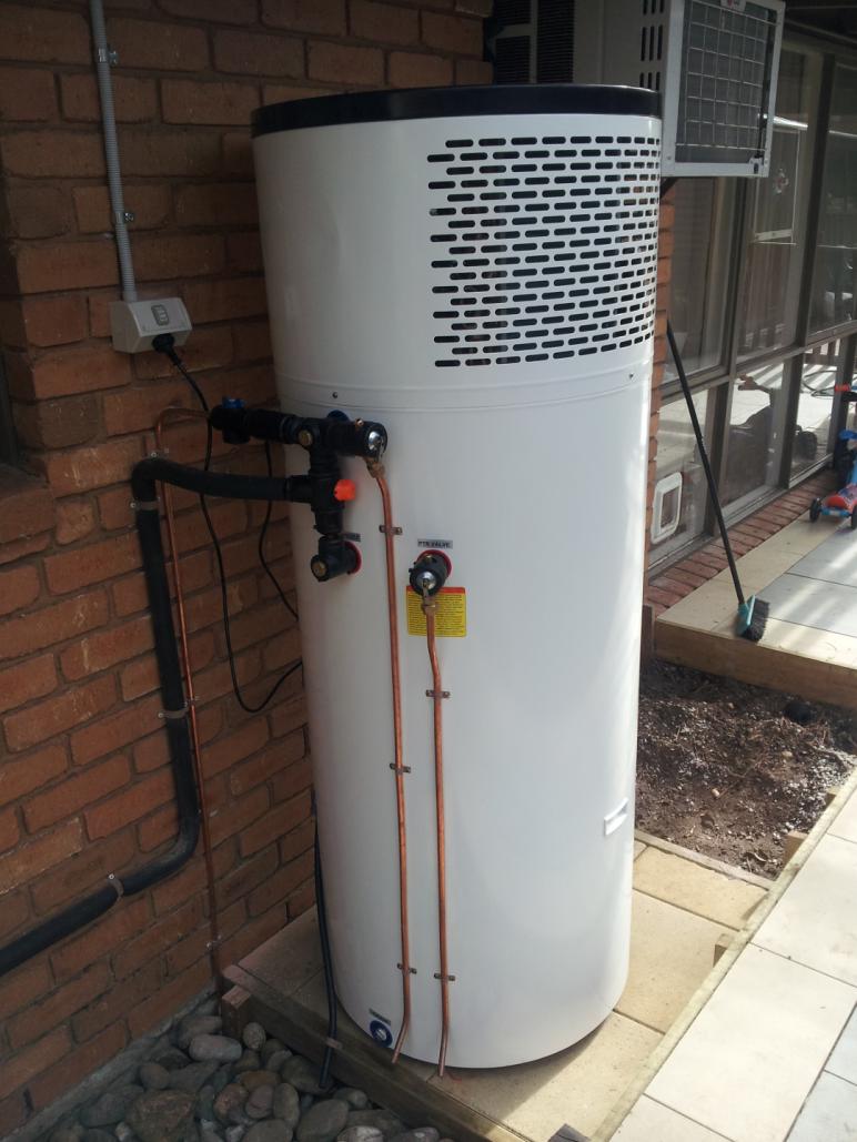

                  I got the heat pump hot water installed. Attached is pics of the new heat pump and the old decommissioned electric. The cylinder was $3400AU including fittings and delivery; I received a $1740AU govt rebate so my actual cost was $1660AU. The plumber charged $550AU which I felt was very reasonable for the work required. I dug a trench for the cold water inlet from the mains and created the pad for the new cylinder.
ID:	46402Click image for larger version
                  I had the cylinder plumbed into the pipes under the kitchen sink so instead of waiting 40 seconds for hot water to arrive from the faucet it's now 4 seconds! The old electric cylinder was positioned on the opposite side of the house away from all the household hot water outlets so that in itself would have lowered the efficiency. We aren't the original home owners, I have no idea why it was like that.
                  I am planning on insulating the new tank and may look at pre-heating the cold water inlet using black polythene pipe or similar systems used to heat water into swimming pools. But if I need to pump it up on the roof it might cancel out any energy saving benefit pre-heating provides.
