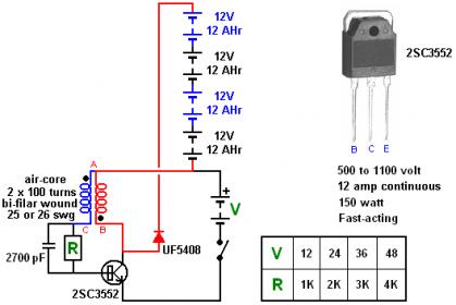

Then I built the self-charging one with bifilar coil and MJE13009, one battery charges 4 other in series. Everything was exactly like in the book except the following, my bifilar coil is smaller, the same one I used in the Joule thief described above AWG24 wire. The one in the book should measure about 300uH and mine is only 140uH. Also I did not have 4 batteries at the output but single one.
When I tried to measure the output, with or without battery, I have tried with cap in series, without cap, different ways but something was always heating up. Then I realized the bias resistor was wrong, I put 1k instead of 2k. But even when I replaced it with the correct value, result was the same. Then I decided to go for the nest one, upgrading the transistor to 2SC3552, and of course UF5408.

I will post a picture below, my circuit is the same except the coil is smaller and I don't have four batteries but one. Again the same thing, but this time the resistor is burning. It is 1k 1/4w. the capacitor is polyester film 2.7nF.
When shorted the circuit and measured current, it was almost 2A. I tried with a 470k for the bias resistor but it got hot too.
So I decided to ask for help, obviously I am doing something wrong but yet don't understand what.
