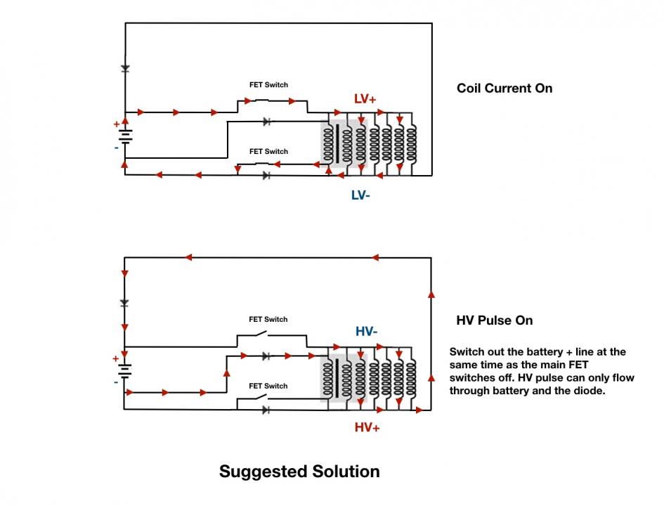

      What I have come up with as a 'temporary' solution is to incorporate an isolating FET switch between the battery and the top of the coil. I don't know if the FET needs to have its Source at 0V but I'm sure you get my idea. Maybe this can be done better with a regular BPJ such as the BC549 I am using now or a power transistor but this is how I see it working with most of it what is working now. I refer you to the attached pen modified drawing 'Revised Circuit with Isolator' and the 'BEMF Generator V3 (Revised)'.
      When the Hall output pin goes low the collector on the tranny goes high which sends a high to both FETs. This allows current to flow from the battery with the additional FET acting as a one way valve in the battery + line. When the passing mag field switches off the sensor and both FETs are off then the now HV positive at the bottom of the coils can only flow to the battery through the three diodes.
      As I say, it might be simpler to use a regular power transistor (I have a spare T13009) but then it has to allow up to 4 amps through it.
      If this works then at least I can get the battery responding to the pulses and tackle the question of discharging and charging simultaneously to later.
      Regards,
      Jules
      This still doesn't provide any path from the battery negative post back to the top of the coils when the FETs switch off. The coil high voltage discharge will not have a complete path and will probably "blast" it's own path somewhere you don't want it.

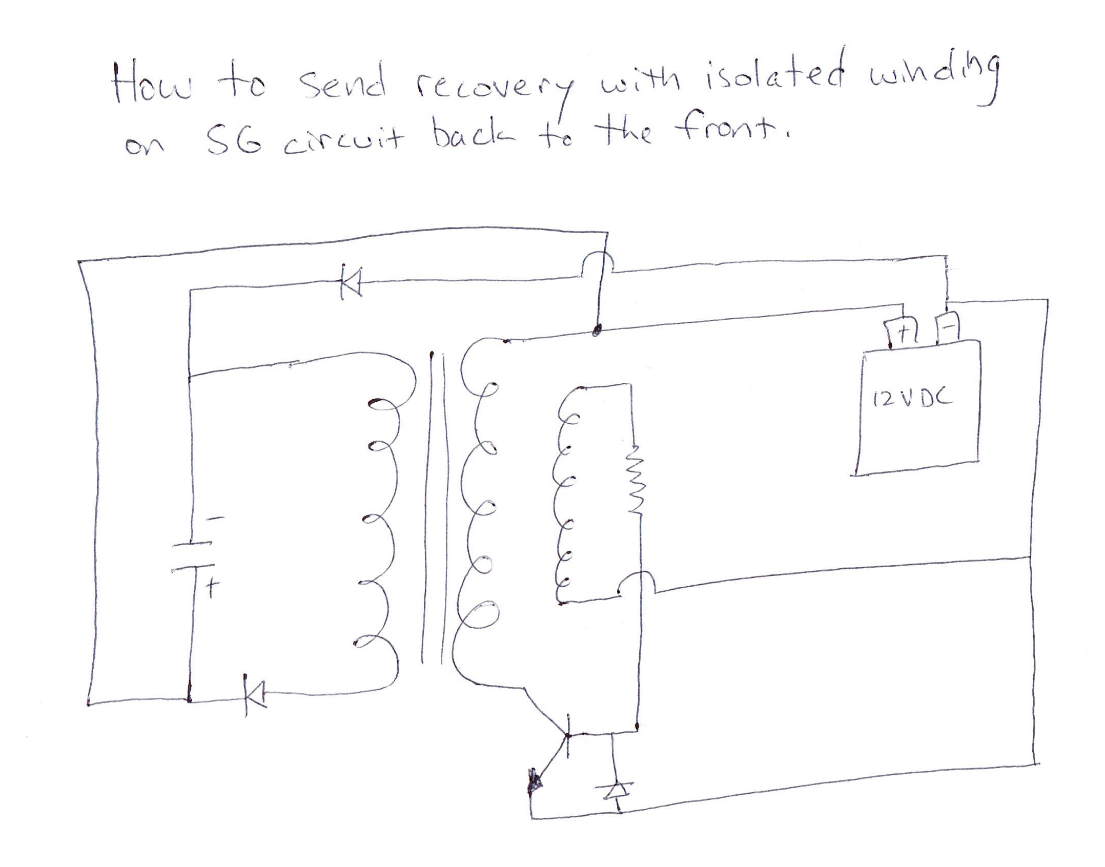

      • #33
        Hi Jules,
        Here's a method of "back popping" the run battery that Aaron originally posted.
        • #34
          Hi Jules,
          Drat and double drat! I will wait for inspiration
          Jules

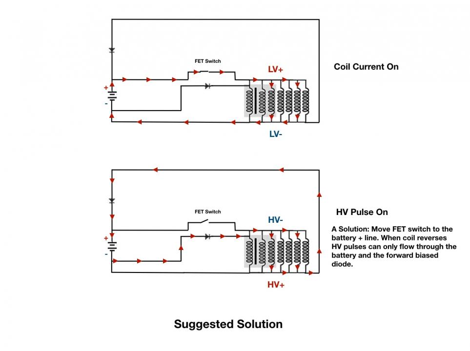

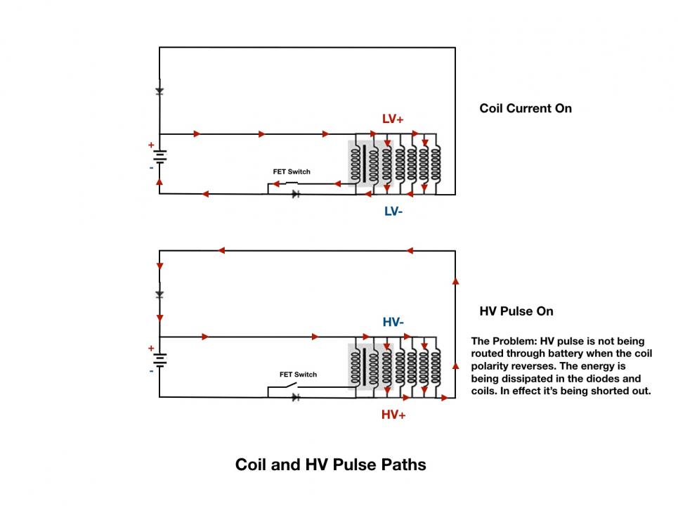

            Completing the circuit
            Hi Jules,
            Ok, so my solution to that is shown in the two slides where I illustrate the problem and a solution. Basically if I included a diode between the Bat - and the top of the coils, while this will be in reverse bias when the coils are conducting their current, when the HV pulse occurs and the coil polarity is reversed, then it should become forward biased as the batt - is now positive with respect to the HV- (I think).
            I reckon this should work.
            Regards,
            Jules

            • #36
              Hi Jules,
              Theoretically I think that should work.
              The main problem I see is getting the FETs and/or BJT to switch at exactly the same time. This may be difficult to achieve in actual practice. The high voltage spike you are trying to capture happens in just a few micro seconds after the current flow is cut off.
              You can try it and see what happens. Wishing you luck on the endeavor!

                • #38
                  Hi Jules,
                  [ATTACH=CONFIG]7092[/ATTACH]
                  Hi Gary,
                  Don't you think there should be a dump switch(mechanical or MOSFET) on the Positive line from the Capacitor positive to Battery Positive?

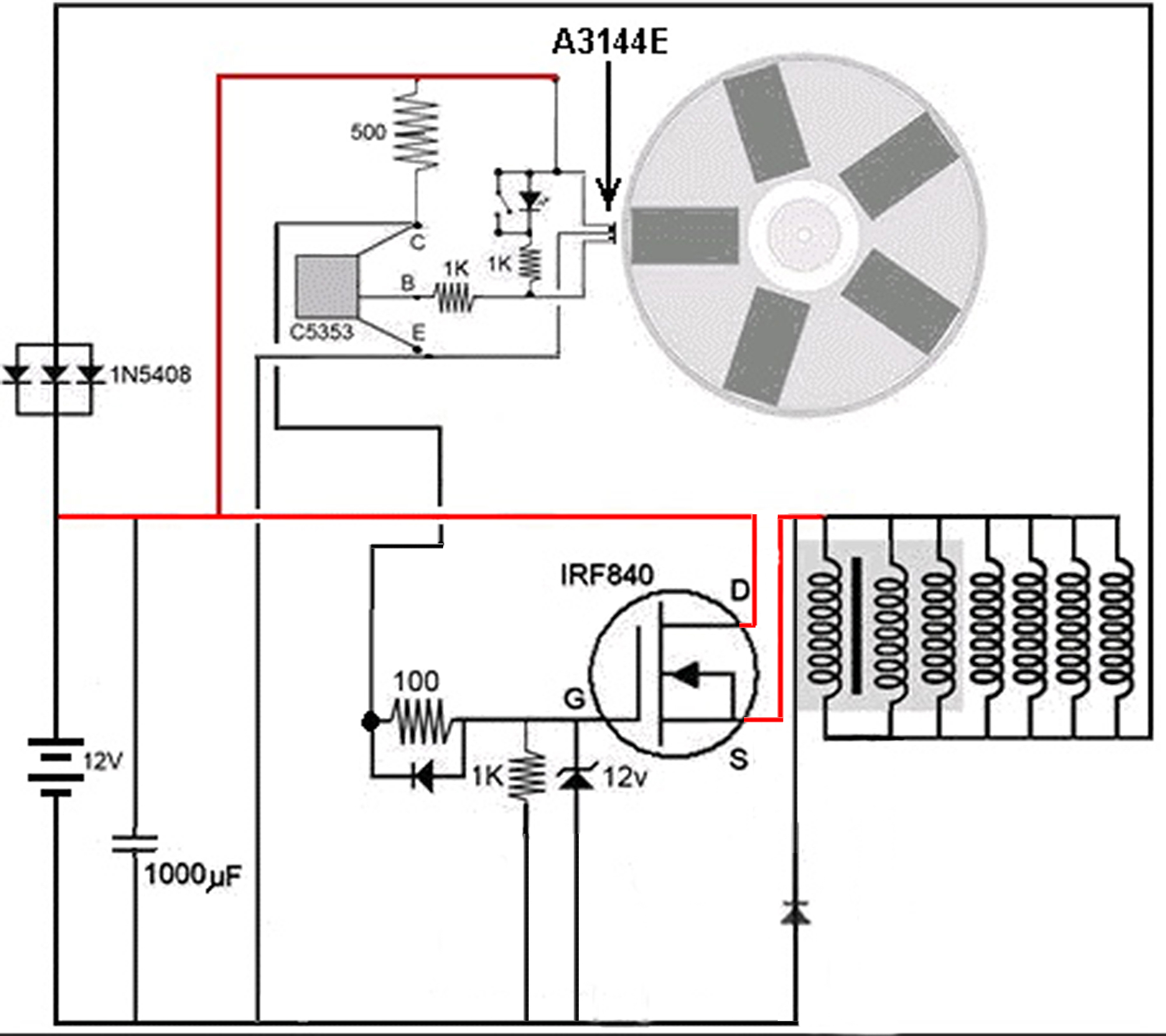

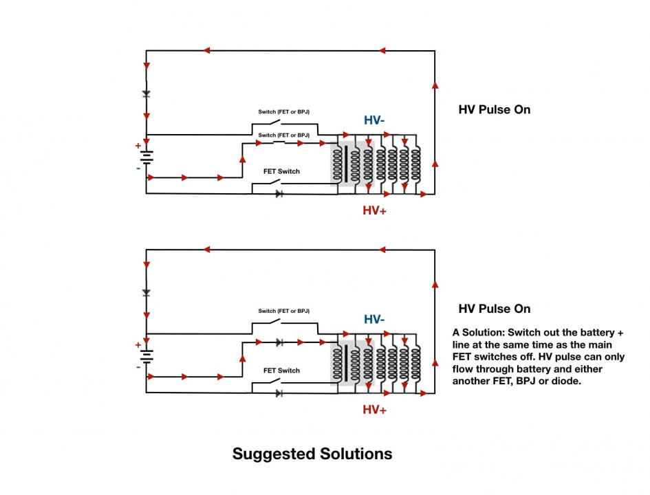

Name:	HV Pulses - Solution.jpg
ID:	50012 Click image for larger version
Name:	Revised 'Hall' Circuit 2.jpg

                    • #40
                      Hi Jules,
                      Originally posted by JulesP View Post
                      [ATTACH=CONFIG]7096[/ATTACH] [ATTACH=CONFIG]7095[/ATTACH]
                      Sorry!
                      Look at that a little closer. The new diode you added is connected directly across the coil in parallel, in a direction that will short out the high voltage spike. That will prevent it from going through the top loop at all.
                      There are a few ways to make a self runner with only one battery (or capacitor), but it isn't easy. What I have found that helps me solve problems is to put the whole thing out of my mind for a few days, take a vacation, and then come back to it with a new perspective. The sub-conscience mind will be working on the problem even while you are focused on something else entirely. Physical activity also helps me to refocus.

                          • #43
                            Hi Jules,
                            I wouldn't really consider this back popping the front battery. Instead, the output is allowed to charge the cap and when the circuit runs, the circuit preferentially takes what is in the capacitor first and battery second. It can reduce the draw from the front battery by 25-50% depending on the setup. If you don't need to charge a secondary battery, this is good but if you do, then whatever the circuit uses will take away from what goes to the battery. The best use of the output is usually to charge a battery, but this proves the point that you can put the back to the front without the front battery seeing it.

                              • #45
                                Thanks Gary, That looks very interesting. Aaron says (underneath diagram) that he wouldn't really consider it but it seems like a way avoiding the push pull on the battery and making the battery last much longer. But it may make for some useful research and experimentation.
                                Jules
