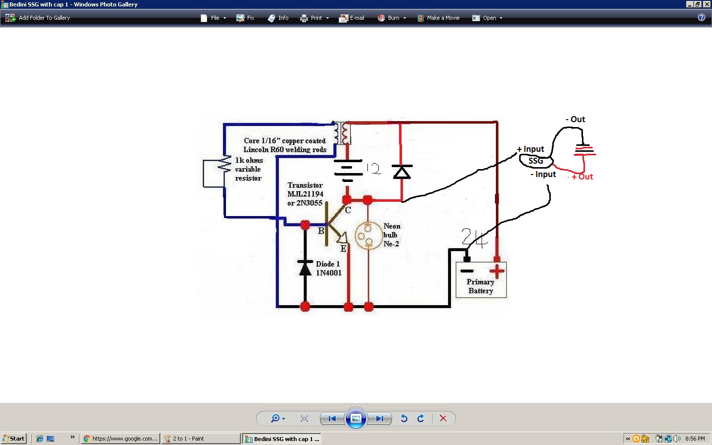

    Thanks for posting your circuit Peter, I've been wanting to experiment with it for a while.
    Here's one version I quickly put together. I already had the tape drive motor SG, so it only took a few minutes to get this running.
    It's charging the heck out of B3!
    I'm thinking about how I might be able use this in a four battery Tesla Switch

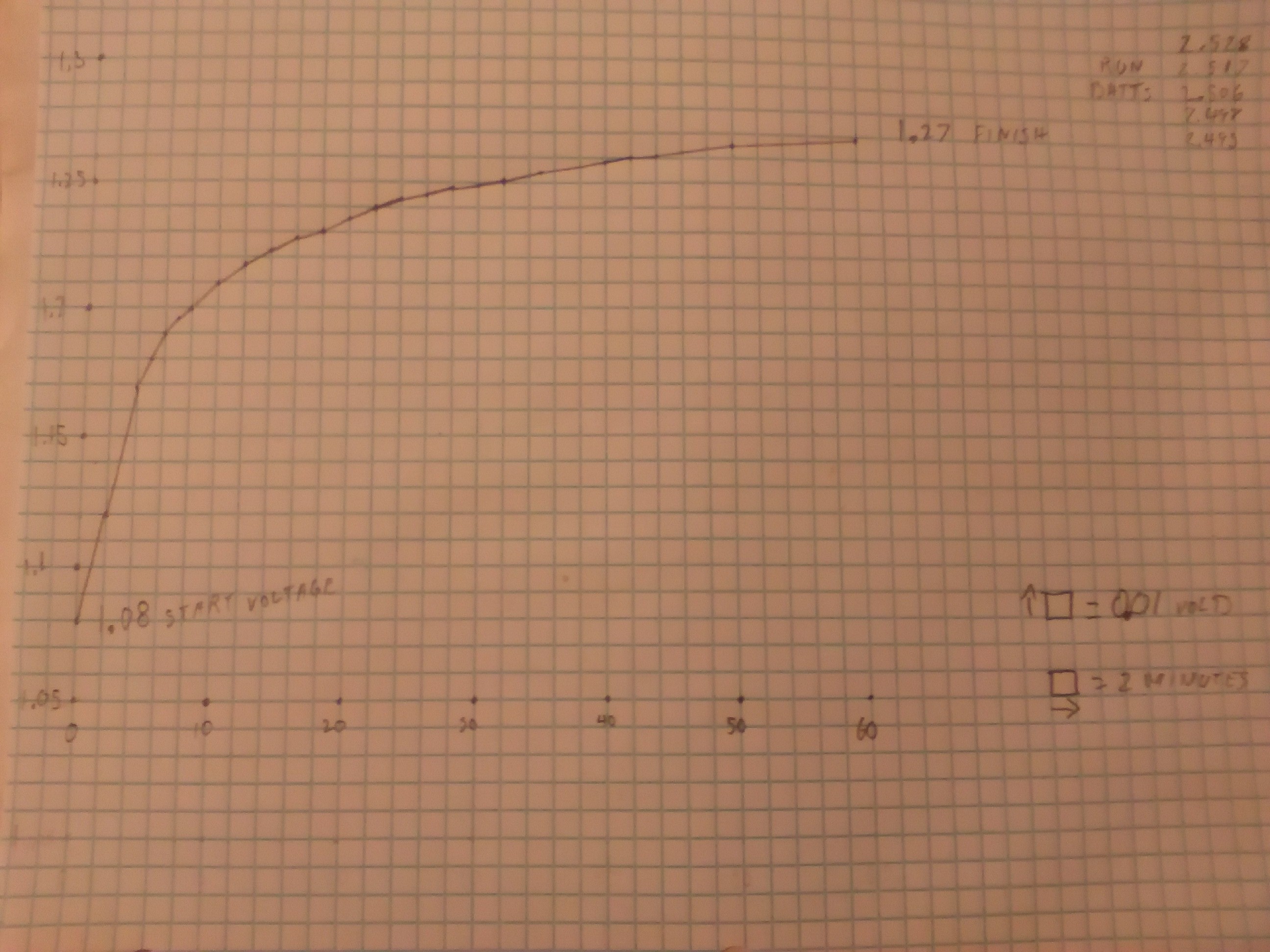

        • #19

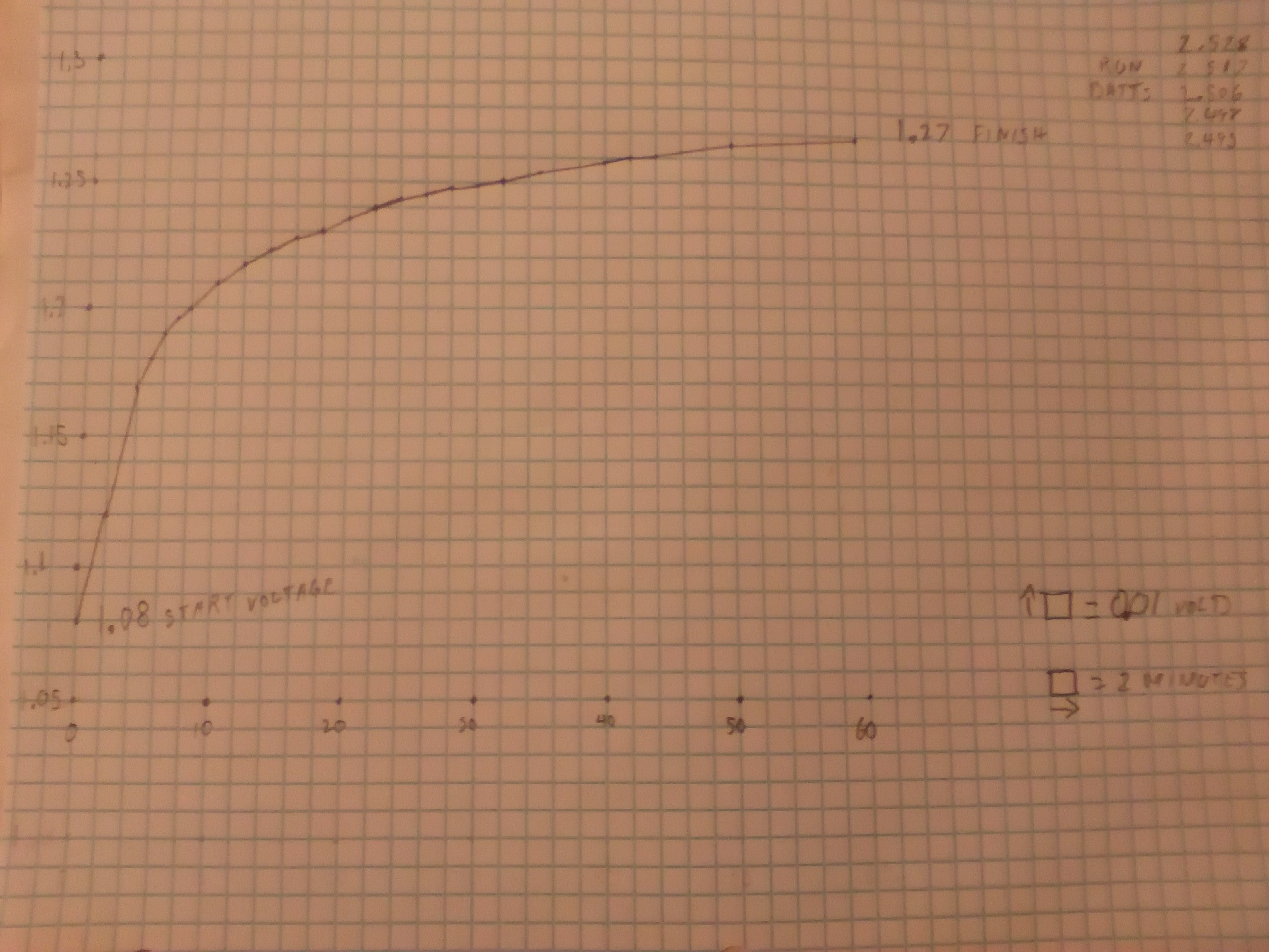

          graph
          this is the test i just completed. I ran the machine for one hour...the logger was having hiccups so I just did the gopro deal and graphed the data by hand. as you can see on the graph the charge battery started at 1.08 volts and finished at 1.27 so it raised a total of 0.19 volts. I did not graph the supply batteries because i only took five measurments during the run and they were 2.528 at the start (2.517 at 15 minutes) (2.506 at 30 minuntes) (2.497 at 45 minutes) (2.493 at 60 minutes) with a total drop on the primary batteries equaling 0.035. looking good so far...more "in depth" test to come!!

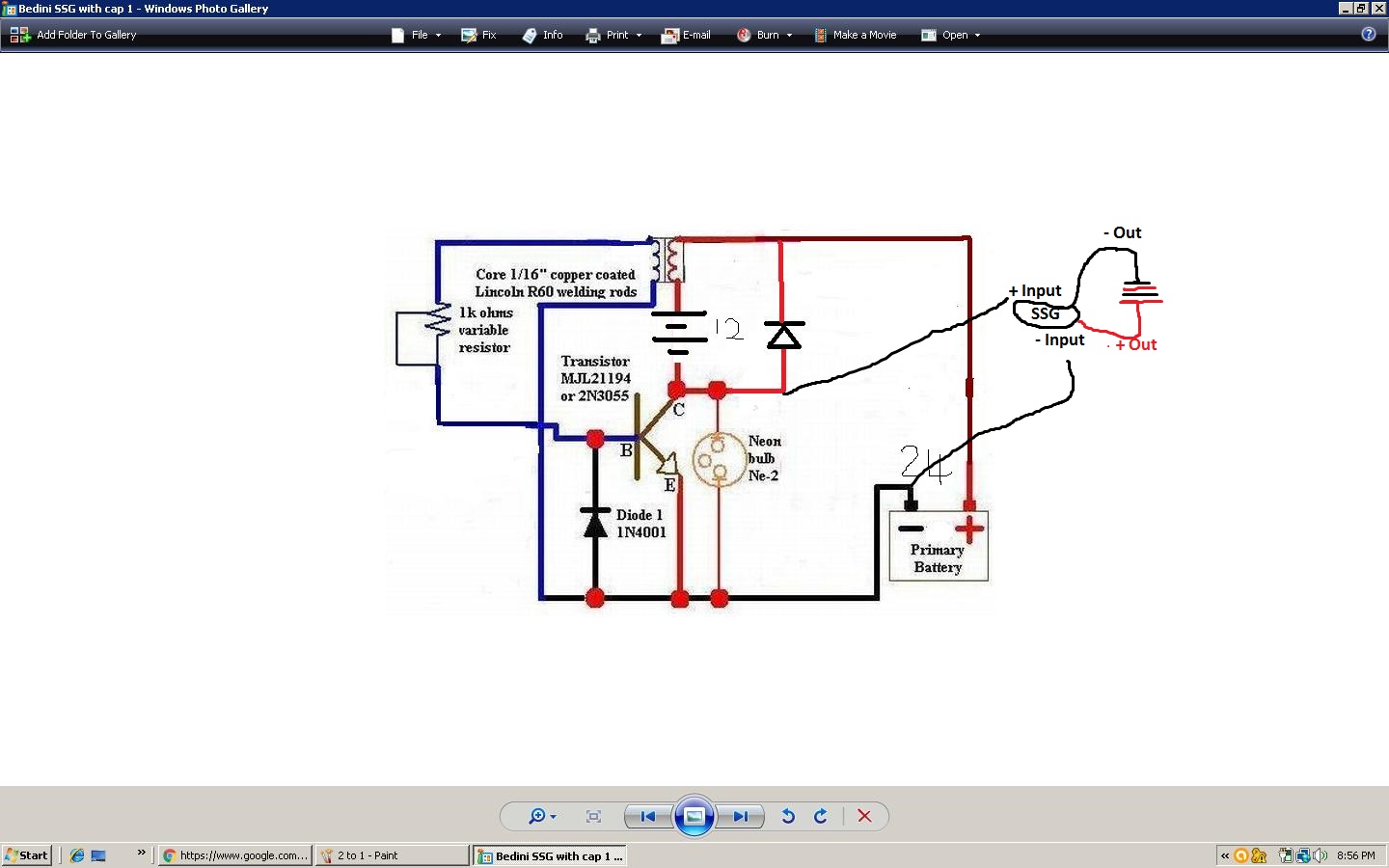

              Hi Bradley and All,
              2 years ago I found a schematic postet by Broadie G.Williams Click image for larger version
ID:	48827 and it describes a typical DCDC bucking (step down) converter explained in a lot of websites containing
              standard electronic circuits. You will find there the typical triangle wave you posted here. but congratulations to your finding ! stay on working on this and it will lead you to a sure and relyable method
              for measuring the input/output efficiency of any pulsed coil curcuit while observing the triangle on a oscilloscope. You can easily adjust to max power output !! in a few minutes...

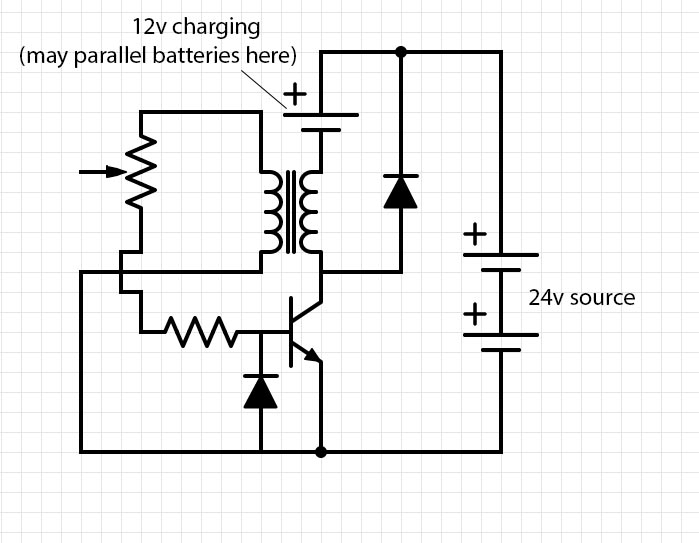

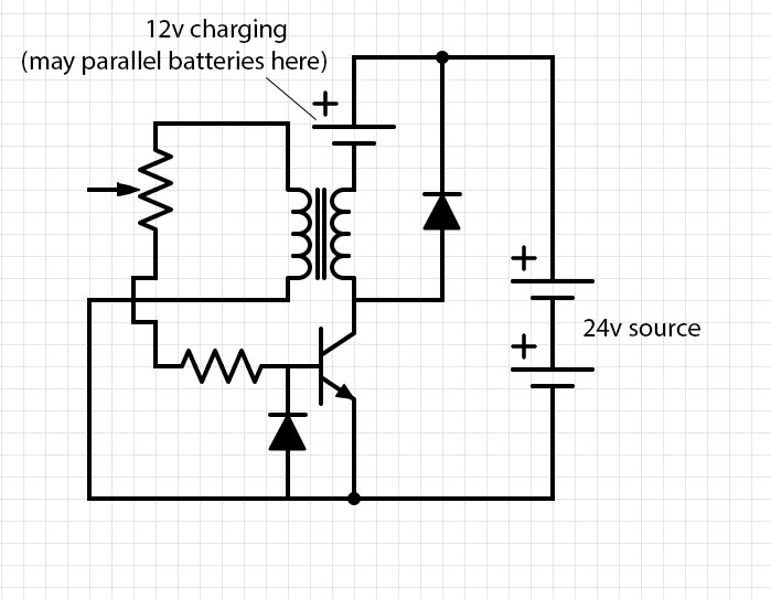

                it would also be really simple to change an sg into this type of configuration to see what differences it has.[ATTACH=CONFIG]5194[/ATTACH]
                Using the modification Bradley posted, (24v primary, no extra diode, 12 charge battery on other side of coil from primary), I have been running for a day and a half.
                Details:
                two new 10.5 AH batteries in series at 26.08v to charge
                two almost new 10.5 AH batteries in parallel from 11.89v.
                This is off one power wind of a 130' 4 filar 26awg trigger/20awg power, small 7 magnet wheel at 750 RPM's 190mA draw.
                I started the run at 2030 hrs on 3/23/16
                each drop of .2v on the primary(series) resulted in the increase of .1 on the secondary (parallel).
                This morning 3/25/16 at 0700 hrs primary was 23.94 and secondary was 12.88, it is still running.
                Broken down details
                starting:
                P=2 batts at 13.04 each
                C=2 batts at 11.89 each
                35 hrs later:
                P=2 batts at 11.97 each
                C=2 batts at 12.88 each
                Interpretation:
                looking like a free spinner with almost exactly out electrically what I put in on the first try.
                Could tidy up the circuit, lube the bearings, ad a flywheel, cap dump, generator coils, etc.
                Aln

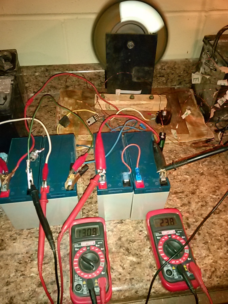

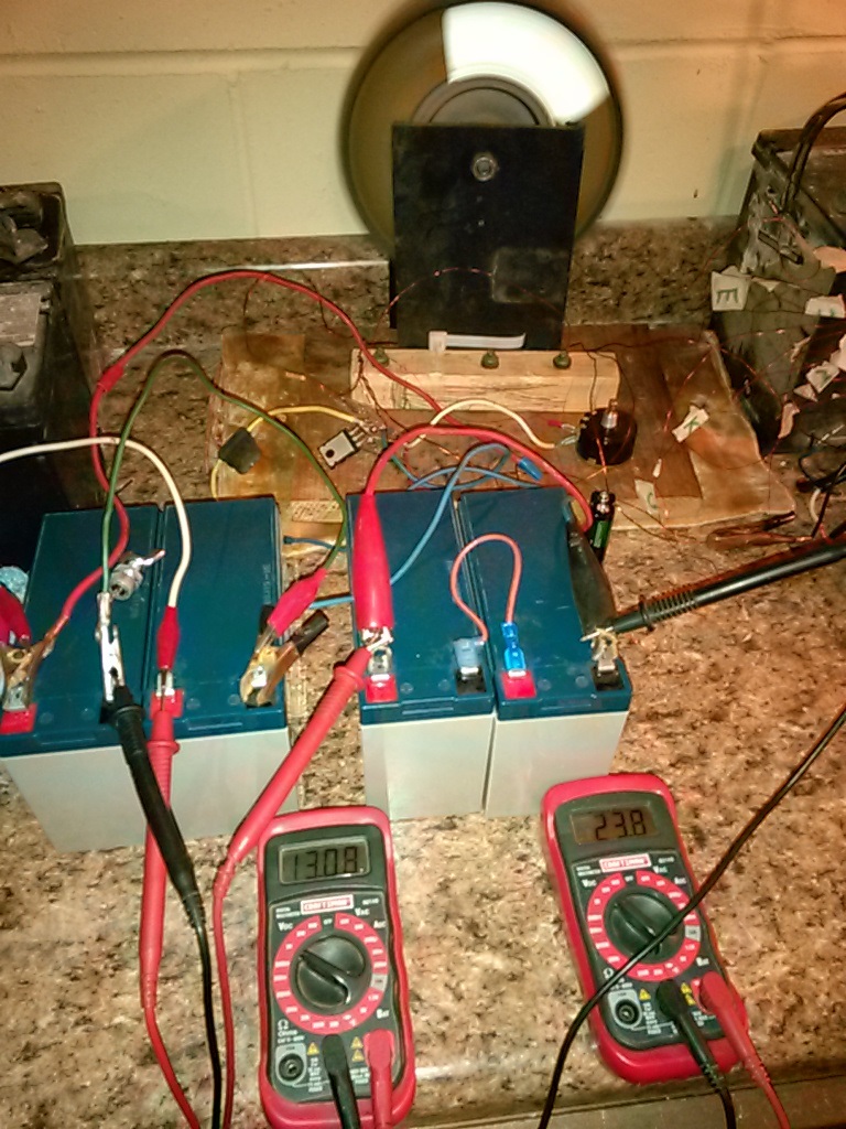

                • #23
                  A pic nearing the end of the run, I'll go a few more hours and then let them rest and see where they sit.

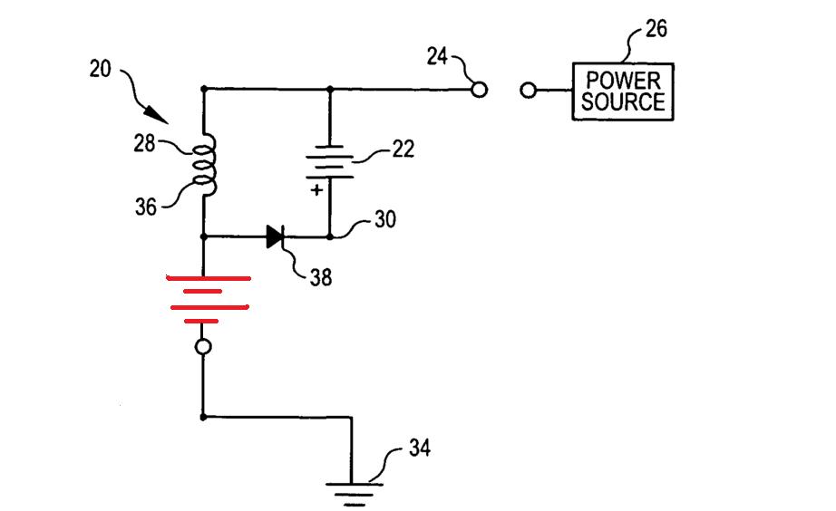

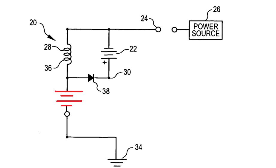

                        Hi All, You guys are close with that schematic...try a bit harder the exact configuration will lead you to the Advanced Patent 'CIRCUIT AND RELATED METHODS TO CHARGE A BATTERY'.
                        Good luck,

                              faraday..that patent is just the normal radiant only setup of a normal energizer wethere is be a forced oscillation or a wheeled version its still the same and does not use the current "into" the charge battery it only uses the back emf collapse in the coil to charge the battery i started this thread to show and talk about using current and the spike... so could you clarify what you mean by "try a bit harder the exact configuration will lead you to the Advanced Patent" because as i stated that patent is just the multi coil sg configuration.
                              Hi Bradly,
                              I repeat, please study the patent up close..i too was of the same impression 4-5 years (i have had my failures as well) back when i first started studying the patent..what you intend to show here by calling it the Current 'mixing' is the Gen. Mode of operating the SSG.. and yes it is relevant but what i insist is the proper use of the Node 30 in the patent...read it clearly says 'the receive Battery gets substantial Current pulse' and let alone this, there are much more other configuration hidden in conjunction with other Bedini patents on Battery charging..figure it out, i have them replicated but cannot post them without prior permission of JB him self..
                              very few have understood (and rediculed) it and called it as being just Soild-state and the rotored version of the SSG not so in reality.. The geometry is critical, air core or iron core is critical...how can 0.7 v charge a battery with 12v terminal Voltage....this patent does it...the normal SSG cannot..
                              JB calls it the Cable Oscillator...
                              Best Regards,
