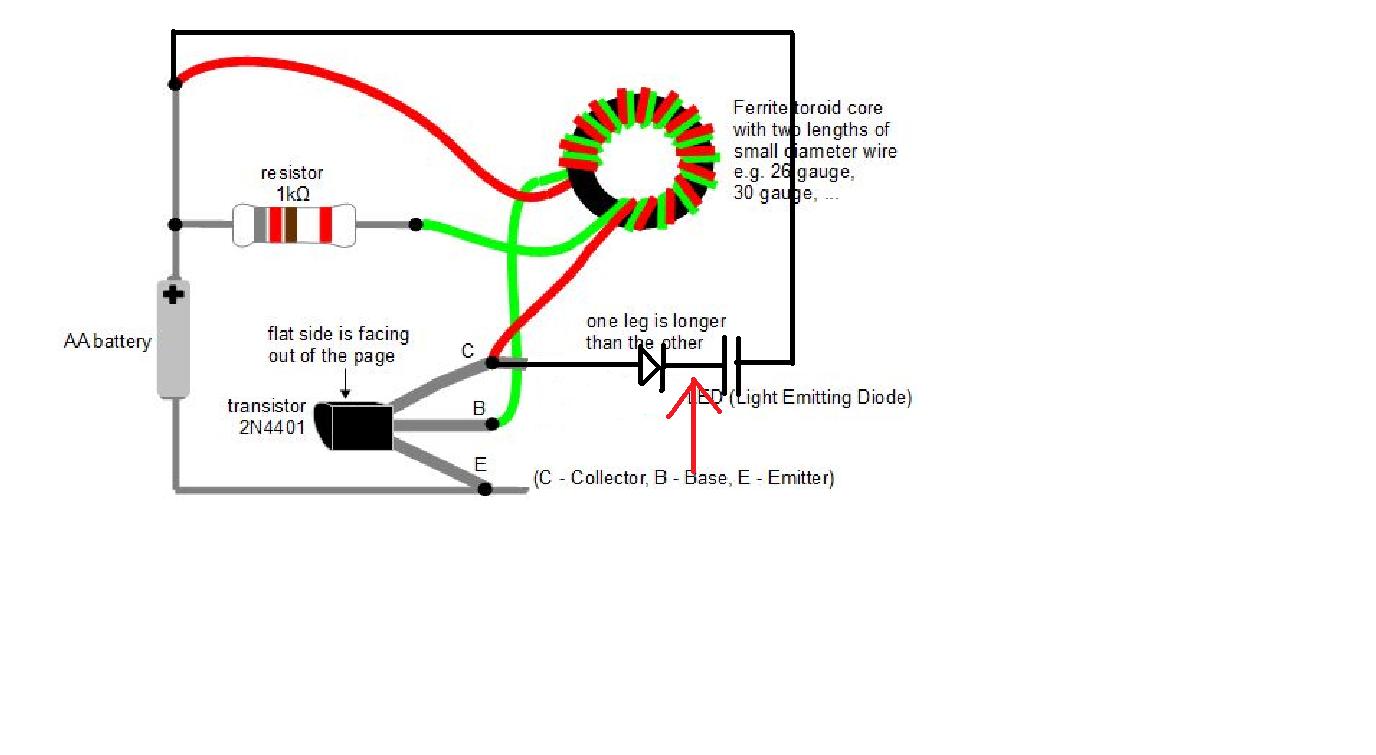

    I came accross something while tinkering yesterday and I for the life of me can not figure out whats happening. I wanted to see what effects could be had from a joule thief that ran on more than a AA battery. so I took the attached picture and modified the basic circuit to run 12 volts into a 3 ohm bi-filar 26awg coil. I used a 660 ohm resistor on the base, couldn't find a 1k, and instead of a 4401 I used a 3055 on a heat sink. I know the power supply has something to do with it and i'll get to that but for the sake of science...it is a "switching adapter" model-FJ-SW1205000T...it was in my junk box but I believe it is a laptop charger. it has an output of 12v 5000ma.
    everything works fine and the only thing that gets hot is the coil after about 30-45 minutes. When i use it to charge up a 16milifarad cap bank to about thirty volts the blue SNAP the comes when you discharge the caps sounds like a gunshot (scared the sh&* out of my brother). it also desulfates batteries rather well, I have a 100 amp hour car battery that would not charge by any normal means...but hooked up to this thing I have got it up to 12.86 volts over a few charge and chill cycles, But the key is...it is fixing a $120 car battery...I'm cool with that.
    The problem....while tinkering a hooked up different loads in place of the capacitor. one of them is a 95volt ac neon bulb. It does not light up while the circuit is running but does flash orange when I first hook up power and flashes purple bluish when I disconnect power. That is weird by itself. The craziest thing and the whole point of this post really is what happens when I disconnect the power. Here is why I said the power supply has something to do with it. I disconnected the positive from the PS and left the negative connected while I changed loads. when I hooked up the light it light up....with only the negative connected! BUT it only happens if I touch between the diode and the load (red arrow). So somehow the energy in MY BODY is lighting a 95 VAC lightbulb (not full brightness but you can definitely see it). if I connect the negative to a battery it does not do this. So it has to be something to do with the charger...But assuming that I would have to be the positive potetial and it the negative and it works even if i insulate myself from ground....so to my thinking its like a wire connected from the positive of one battery to the negative of another...nothing would happen untill the return path is made....So can one of you geniuses help a poor guy out...did I invent the human battery ....I don't understand it therefore it drives me nuts!!Click image for larger version

    I came accross something while tinkering yesterday and I for the life of me can not figure out whats happening. I wanted to see what effects could be had from a joule thief that ran on more than a AA battery. so I took the attached picture and modified the basic circuit to run 12 volts into a 3 ohm bi-filar 26awg coil. I used a 660 ohm resistor on the base, couldn't find a 1k, and instead of a 4401 I used a 3055 on a heat sink. I know the power supply has something to do with it and i'll get to that but for the sake of science...it is a "switching adapter" model-FJ-SW1205000T...it was in my junk box but I believe it is a laptop charger. it has an output of 12v 5000ma. Your schematic shows that you have wired the trigger in the Forced Trigger mode, secondly a Joule thief circuit has the Didoe connected in the ' Generator mode' (i.e between the collector and the emmitter) what surpises me all the more is that this circuit should not run in this configuration if the Transistor is NPN, because if it is than the Forced Trigger for it cannot initiate the oscillations. (since you say it is 2n3055)
    The problem....while tinkering a hooked up different loads in place of the capacitor. one of them is a 95volt ac neon bulb. It does not light up while the circuit is running but does flash orange when I first hook up power and flashes purple bluish when I disconnect power.This is simply the Inductive Make and break that you are manually causing with the Inductors, it is stronger when you break in an Inductive switching hence Purple Blue(Kind of Lenz Law is at play) That is weird by itself. The craziest thing and the whole point of this post really is what happens when I disconnect the power. Here is why I said the power supply has something to do with it. I disconnected the positive from the PS and left the negative connected while I changed loads. when I hooked up the light it light up....with only the negative connected! BUT it only happens if I touch between the diode and the load (red arrow). So somehow the energy in MY BODY is lighting a 95 VAC lightbulb (not full brightness but you can definitely see it). Please refer the Solid-state Oscilltor of Bedini which has resistors baised between the Collector -Base and Emmitter- base you body is providing these bias resistance to initiate the Oscillations and hence the Neon Glows! if I connect the negative to a battery it does not do this. are you saying it correct here do you mean to say Negative of the Power supply? So it has to be something to do with the charger this can happen and this how : the power supply does conducted emmission (harmonics of the fundamental frequency 50Hz, these are getting amplified and driving the Transistor...But assuming that I would have to be the positive potetial and it the negative and it works even if i insulate myself from ground....so to my thinking its like a wire connected from the positive of one battery to the negative of another...nothing would happen untill the return path is made....So can one of you geniuses help a poor guy out...did I invent the human battery ....I don't understand it therefore it drives me nuts!!Click image for larger version.

      Thanks again faraday. honestly this is my first joule thief circuit ...so I just hooked the charge stuff up the way I am used to...accross the coil. As i said it is bright blue when i discharge the caps and the only way I have ever seen that was with radiantly charged caps. I get the inductive make and break ... but don't quite understand how one is blue...even if it is more powerfull. As for the charger ...what i was saying is i can hook it to a battery with just the negative wire and nothing happens but when i hook the negative of the circuit to the negative of the laptop power supply...it does something to the circuit that allows the energy from me to jump the gap in the neon lighting it up. I have seen one wire transmission systems before I just can't imagine I stumbled on to one on accident. I will try to make a quick video later.
        I don't understand why you say it wouldn't work with a npn. if you look at the picture you can imagine the main coil is not allowed to conduct because it is hooked to the collector and the transistor is off. but it can flow through the resistor through the trigger coil and into the base witch would turn on the transistor. but when the energy builds up in the coil it shuts the trigger coil off thus starting over...oscillation. Am I missing something?

            Hi Bradley,
            I think what you have going on is a normal neon circuit tester function for 120vac. You have the neon bulb hooked to the positive output from the switching supply, and your body is providing the ground through the air to the other side of the neon bulb. The positive output in your switching supply is resistive, inductive, or capacitive coupled internally to the ungrounded (or "hot") side of the 120vac receptacle it's plugged into.
            It's the same as holding onto one lead of a neon circuit tester and placing the other lead into each side of the outlet to find which side is "hot" and which side is grounded. Your body completes the ground through the air.

              I can see that being a posibility but I have the negative hooked up not the positive. i checked the polarity with a meter just to make sure the outside of the plug is negative and it is. so with that being the only thing connected from the power supply then it would have to be the ground and the electric in my body must be the positive. Unless somehow positive is coming out of the negative...witch makes no sense.

                That's entirely possible as the source is ac. Either dc output polarity could be internally coupled to the ungrounded "hot" side of the outlet. Unhook everything, unplug the switching supply, and check for continuity between the "hot" side of the power cord and the negative dc output with the power switch on. And since it's a "switching" supply, it might be inductive or capacitive coupled. It probably will not be directly (zero ohms) coupled, but any resistance up to 1 megohm would probably be enough to dimmly light the bulb.

                  That makes sense because it does light up slightly....but its 12 volts not 120 and negative not positive....so I am still confused. Sorry if i am missing something obvious. and it does sound like what your saying but those are a few major difference that I can't get past. more tinkering is necessary!

                          Good effort Bradly, I can understand what this is ..yes try this out...take a Neon bulb hold one lead of the bulb in your hand and touch the other lead to CONDUCTING SURFACE of the body of any running transformer ( say 120V to 12 v eect) that you might have used fro your experiments.. you should see similar level of Neon bulb glowing.... this is due to the floating earth in the Power supply...
