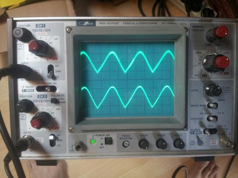

I miss a word in this hole thread and this is "create a standing wave" and how this is done.So far i am informed you need this state in nearly every Free Energy machine.I know how you create a standing wave in theory but on my device im not sure if i only have to hook up a dual channel oscilloscope and compare the to coils.And here it's not talked about the phase angles and the max.current and zero voltage that should come out of the machine.For the first i leave it by this questions.Here a picture of my generator wich is speeding up under load,but i dont have tuned it optimaly.I have 8pcs. 20 mm dia 10mm,2 stacked)neodymmagnets polarity changing,by 8.5mm airgap the speed goes from 1000 u/min to 1200 with 2.2 ohm resistor as load.The coils are bifilar 19Awg in series and not bifilar connected.the waveform is after the rectifier and the upper is the current and down is voltage.I thougt i can adjust the degree of the phases with a capacitor and i have tried various kind put there was no change. https://www.google.at/url?sa=t&rct=j...71198958,d.bGQ

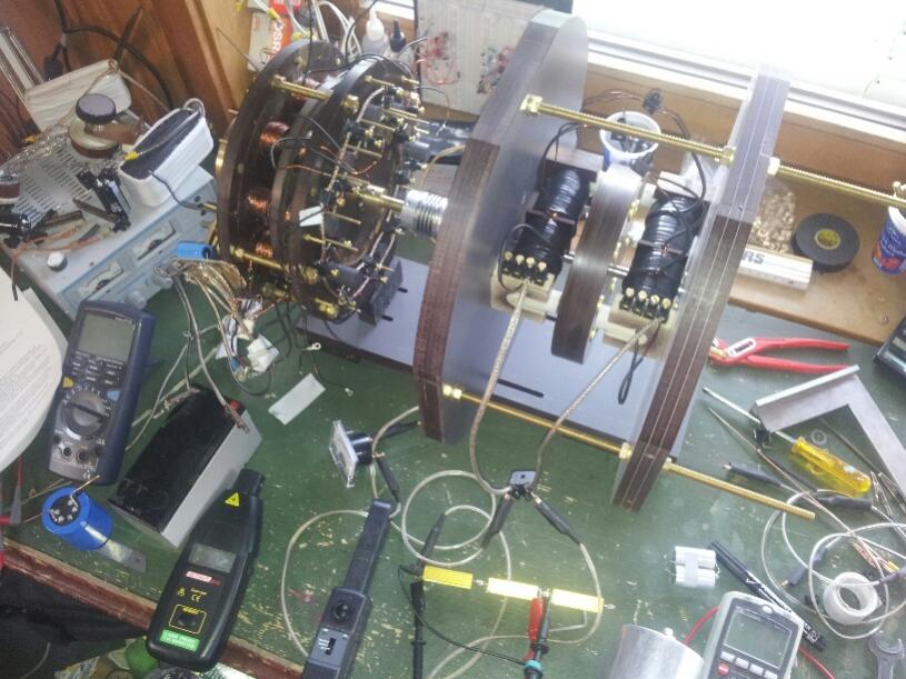

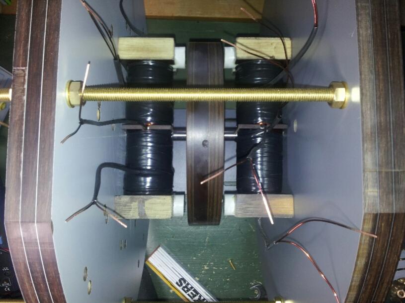

Still not posting pictures, erfinder? I think you did a really good job with your build forelle. However, it seems as though you also have aluminum directly touching the iron that the flux is being gated through. From what I understand, the flux going around in a circle is imperative to a properly functioning apparatus . The flux lines are straight, so the E field is being rotated in vortexes at 90 degrees to the iron bar, like a rotating magnetic field around a wire with current coming through which moves the magnetic field in vortices around the wire, only this is opposite, The coils manifest cold current but because the E field is not cutting through the wires, the flux and E field continue to circulate in a closed loop. By interrupting that loop and stopping the E field with the eddy currents and the conductive properties of aluminum, we are keeping the machine from functioning properly. I say this because my friends design (which can be seen at energybatlabs.com under projects called cold energy unit) is electrically isolated from the armature and the support structure, and it tracks no eddies because it is built with rubber. He is getting cold e output not exceeding input, but a conversion nonetheless. Check his pictures out, and keep us updated on any progress please. Thanks for posting some pics. The build quality is awesome!
I don't know you, and don't owe you anything. I gave my conditions.Originally posted by Ajay View PostStill not posting pictures, erfinder? I think you did a really good job with your build forelle. However, it seems as though you also have aluminum directly touching the iron that the flux is being gated through. From what I understand, the flux going around in a circle is imperative to a properly functioning apparatus . The flux lines are straight, so the E field is being rotated in vortexes at 90 degrees to the iron bar, like a rotating magnetic field around a wire with current coming through which moves the magnetic field in vortices around the wire, only this is opposite, The coils manifest cold current but because the E field is not cutting through the wires, the flux and E field continue to circulate in a closed loop. By interrupting that loop and stopping the E field with the eddy currents and the conductive properties of aluminum, we are keeping the machine from functioning properly. I say this because my friends design (which can be seen at energybatlabs.com under projects called cold energy unit) is electrically isolated from the armature and the support structure, and it tracks no eddies because it is built with rubber. He is getting cold e output not exceeding input, but a conversion nonetheless. Check his pictures out, and keep us updated on any progress please. Thanks for posting some pics. The build quality is awesome!

Hi AjayOriginally posted by Ajay View PostStill not posting pictures, erfinder? I think you did a really good job with your build forelle. However, it seems as though you also have aluminum directly touching the iron that the flux is being gated through. From what I understand, the flux going around in a circle is imperative to a properly functioning apparatus . The flux lines are straight, so the E field is being rotated in vortexes at 90 degrees to the iron bar, like a rotating magnetic field around a wire with current coming through which moves the magnetic field in vortices around the wire, only this is opposite, The coils manifest cold current but because the E field is not cutting through the wires, the flux and E field continue to circulate in a closed loop. By interrupting that loop and stopping the E field with the eddy currents and the conductive properties of aluminum, we are keeping the machine from functioning properly. I say this because my friends design (which can be seen at energybatlabs.com under projects called cold energy unit) is electrically isolated from the armature and the support structure, and it tracks no eddies because it is built with rubber. He is getting cold e output not exceeding input, but a conversion nonetheless. Check his pictures out, and keep us updated on any progress please. Thanks for posting some pics. The build quality is awesome!
The mounting plates are made off Hardpaper,this kind is used for covering the walls outside off a building,3 plates(8mm one)glued together it is similar with the brown stuff used in elektromechanic(pertinax),it is garbage because when the pieces are to small they can`t use it.I have only some brass screws,the shaft is also stainless(316)only to avoid problems which i dont know.The core is like bedini coils.I made this arangement because the blochwalls off the coils should stand in 90 degrees to the blochwalls off the magnet(i still dont know why) like bedini allways shows.
