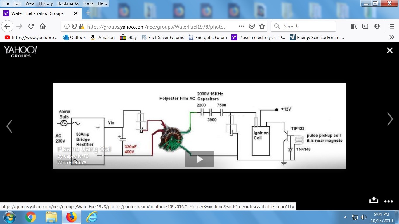

              Earlier data on the conversion circuit called "capacitor70" has been researched and recently partially bench tested. It was hoped that the use of this would aid the ongoing conversion of Briggs engine. The set up was a Capacitor70 pulsed step up transformer using PF capacitors in series and discharging into primary of ferrite step up torroid transformer. The positive ignition high volts entered accessory 1rst spark gap and charged up the PF capacitors same time, and then caps pulse discharged into primary to ground. The secondary side was higher voltage depending on the ratio used. Engine compression also raises up voltage at spark plug. The secondary positive higher volts output connected to the anode side of power supply bridge rectifier. The cathode side connected to top of spark plug. Therefore, the secondary side was in series with the bridge rectifier, and spark plug. Spark plug connected to casting ground, which is same as the ground for positive ignition coil. Separate wire at plug metal, with clamp, went up and was the return line to secondary, and was then on through secondary coil to anode side of rectification. (return line of power supply)
              This set up was to increase the voltage of ignition coil and to also eliminate the use of battery power wasting series string protective diodes bank. He said his earlier use of diodes had melted it's solder and was not good.
              After doing this set up, I found out 2 major flaws. The capacitor discharge circuit was operating in microseconds of time instead of the required milliseconds. Also the pressing of about 24KV against about 2kv diodes indicates only a very short useful time period, due to overvoltage damage. Any protective 75v enclosed spark gaps added on, would only not allow DC to proceed and find only AC. The high volts + DC current (with 100v) have to happen at the same time flowing through spark plug. Also, the initial Capacitor70 torroid shown in picture had only magnet wire on the bare metal surface with the flowing very high voltage. This overall, seemed not a viable circuit, and not done by a COMPETENT technician.

                    Another update regarding the S1R9A9M9 system. I rechecked the bench set up for the "capacitor 70" add on circuit . I got it working to fire spark plug at about 10kv in air. The secondary side was also through 2 FR607 series diodes and through the anode side, and through a China inductor 2.1millihemry. The Diodes represents 1/2 of a bridge rectifier from a dc power supply. The inductor is used as another required means for slowing the spark time. The value of PF caps in series increases the spark strength. First ADJUSTABLE spark gap tester fires from initial ignition coil. At same time also charges up the PF caps in series with primary 8 turns 20kv white China cable.on ferrite closed loop core. The other end wire goes to ground. Alltronics UU ferrite core set with measure and cut 1/16" peel and stick rubber to protect windings from the high volts touching metal core. The 2 halves are held together with 2 spring type hose clamps 11mmm center. The secondary was 30 turns #16 gauge solid hook up wire as it has to carry 6-7-10 amps. (Zero ohms small engine spark plug) As secondary fires, it is supposed to go through the PS 1/2 of bridge rectifier and on it's way through the S1R9A9M9 electromagnet coil, and the L coil and to engine spark plug. The methodology of this circuit is to allow for partial ISOLATION and eliminate the power/energy wasting series protection diodes bank that would be inbetween PS and ignition voltage.A higher PS output voltage needs higher current draw from battery. A lower battery draw is the resultant if using the Capitor70 circuit according to him. You need the internet calculator for L C resonance frequency near 649KHZ .Primary coil as 100 microhenries. A hand meter for capacitance and inductance is needed. In air, spark gap is 3KV per mm. A Briggs engine has listed as compression increase of 2-5 times higher voltage spark. The low cost China oscilloscope and probe divide by 10,000 allows for measuring the high voltage. DSO 138 and plug in PS ,and Hantek divider probe HT-25. Other items needed as jumper wires, dual set screw wire connectors, fuses / holder, and determination. I am hoping to integrate this new circuit into the original planned S1R9A9M9 final circuit on Briggs engine. (Questions??)
