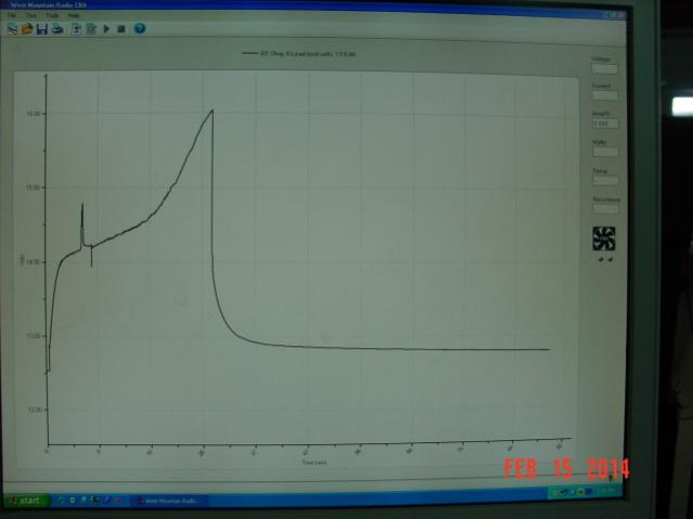

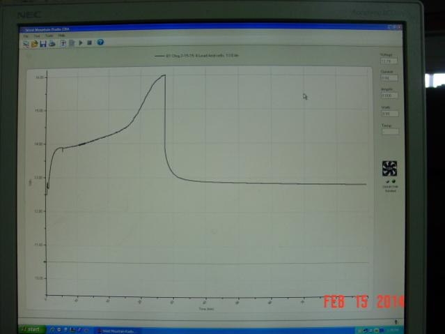

and if a video is postet from a member,it is expected as an answer to the question. But Patricks video isnt. It shows voltages over batteries like thousands other videos do. I have an old starter batterie and i can show you a similar video where the voltage goes from 12.6V to 16.5V after 5 minutes, recharged from my smallest SSG driven by a 12V/1.2AH primary battery on 50 milliamps. Wow! what a COP. But after half an hour the big battery is sitting back at 12.6V.
And if connect a little 2watt lightbulb the meter reads 10.4V.

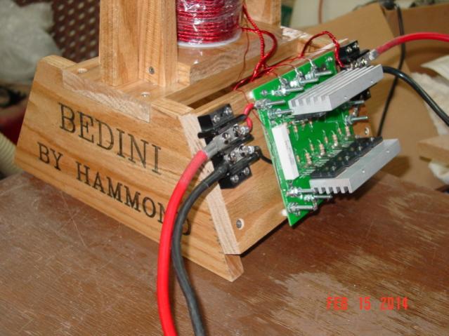

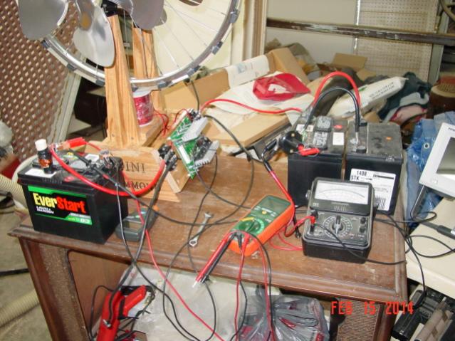

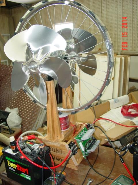

@GaryHammond
thank you for your detailed report, your description step by step is good for understanding by me, but you have not done the last decisive step.You have to discharge now the charge battery again of 1Ah and look at the meter after 1hour.Can you read 12.58 volts now?
If so,post a video showing these simple procedure you will be forelle's TOP STAR and the winner of this thread
Happy experimenting !
