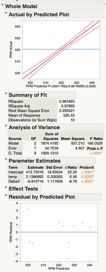

    Here's the model I have from my data that explains 98% of the variance. DeltaV is the difference between the charge voltage at the time of measurement and the starting charge voltage, so essentially a measure of time as well as a measure of the fullness of the charge battery.

      Sorry, hopefully this is a better picture

        Interesting observations. I'm not sure I fully understand what the DeltaV means, however it is well known that the speed of the rotor will increase as the charge battery voltage rises. This is due to the change of impedance in the battery under charge.

          I'm seeing almost the opposite. The rotor slows down as the charge voltage goes up and with just these few data points I don't see anything statistically significant, but it seems to slow down at night. No data on full moon phase yet.
          DeltaV is the difference between the voltage of the charge battery at measurement from the voltage of the charge battery at rest before charge run, basically the rise in voltage during the run to that point.
