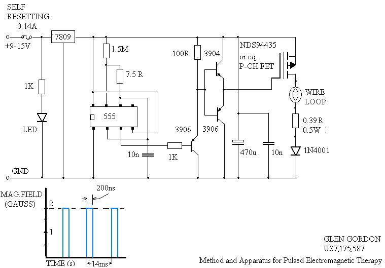

        Method and apparatus for pulsed electromagnetic therapy - Glen A. Gordon
        Patent US7175587 - Method and apparatus for pulsed electromagnetic therapy - Google Patents

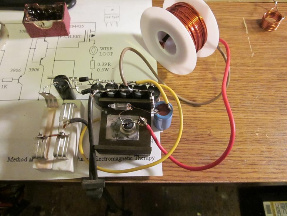

                I started building John's circuit and got most gen's running except those with 50 Ohm resistors. I have assembled most of the audio amp.
                I took a stab yesterday at Glen Gordon patent and got it running. It was late and I didn't finished checking everything. The pulse is small, suppose to be 2 Gauss at 1cm distance but waveform seems to be correct. I used IRF9630 since it was the only P channel I could locate in my parts.

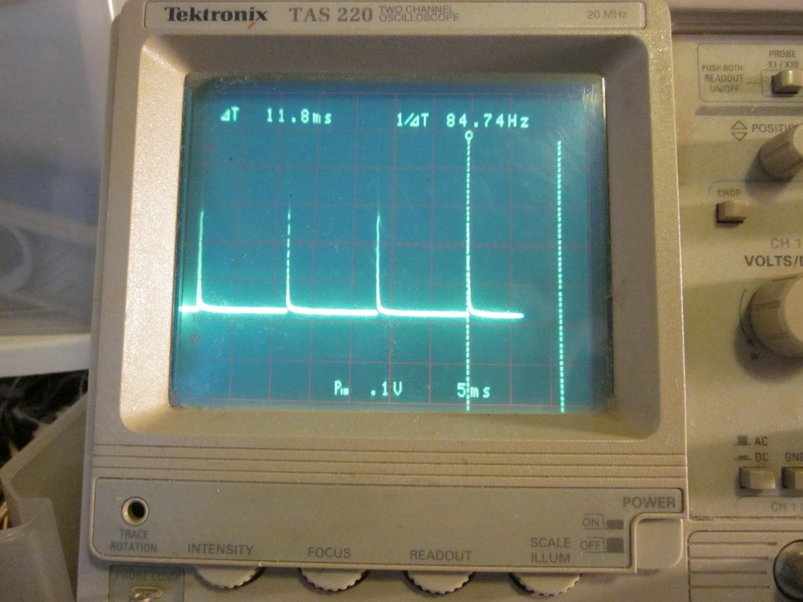

                Dr Glen circuit produces small but very sharp pulse in range of nanoseconds. According to Dr Glen the best frequency was 70Hz. Mine runs near 80Hz. I was a bit stunned with resistor values - 7,5 Ohm and 1.5 MOhm but it makes sense. I took a scope shot and will add when done with YT upload.

                      Glen Gordon device seems to be operating fine. I used a "sniffer coil" as well as AM radio to test the output. It is hard to see on the scope since the pulse is very narrow. I was hoping to get more amplification of signal coming out of 555. I have an idea of replacing "push-pull" driver with similar but mosfet. I was busy today finishing assembly of the circuit provided by John. Finally got it running. I have some questions to John but this should go to his thread.

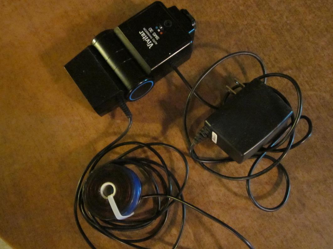

                        Hello. I was thinking lately about improving my magnetic pulser. The one I have is based on Vivitar flash and operates with manual trigger. I modified flash and it runs from 5V wall adapter instead of batteries. It works fine but it can't deliver faster pulse due to the capacitor charging time.
                        I started working on stronger unit, capable of 15 -20J pulses. This circuit runs from 110AC and can provide discharge at 7.8Hz or half of it. I used 35A thyristor capable of handling much higher peak pulse and bank of five 130uF 300V capacitors from disposable cameras in parallel. Right now thyristor is triggered by neon bulb but I'm planning to use IC555 timer later - same idea as John Bedini cap pulser. I need to iron this idea a bit more and will post the result when I'm done.

                            This is my Vivitar pulser and simple neon triggered SCR circuit - IMG_0494.jpgIMG_0493.jpg
