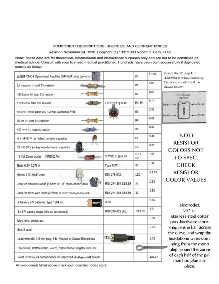

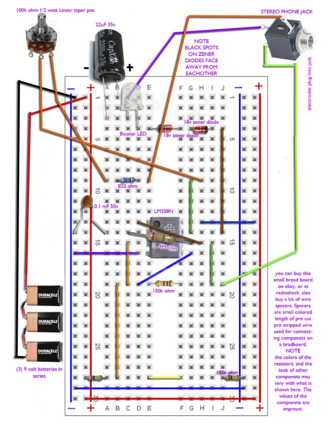

  • This may help the layer of the very New, 101 crowd. Here is a picture of the breadboard version for a blood electrifier only, id like in the future to get the Colloidial generator in this too. Enjoy..bb2.jpgbb1.jpg you Can also access these images over on archivedotorg

                    Also, 0.1uF cap in original circuit of Dr Beck Blood Electrifier is drawn as polarized (electrolytic) cap. I think it would be better to use non polarized capacitor instead. I had one device which was problematic due to the cap leakage.
