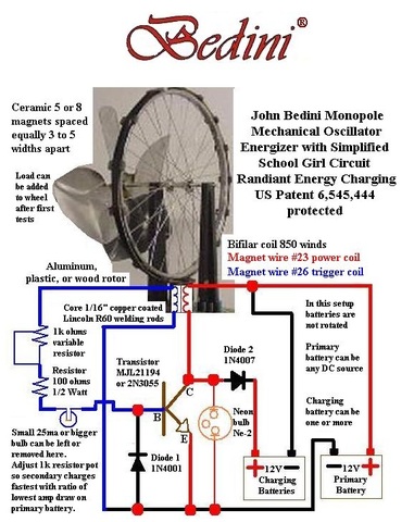

    Monopole1.jpgThe basic circuit diagram of the simple monopole energizer.

      This is most likely the ultimate newbie question but trying to understand the purpose of the wheel? Can't we just build the coil as described in the book (which I LOVE!!!!!!!!) feed it power, cut the power, collect the spike, and repeat at the fastest rate which the coil can regenerate the spike and not bother with the wheel? Or does the wheel do more than spring the trigger to cut the power which creates the spike? I guess better put I am under the impression after reading the book that it is the cutting of the power to the coil which generates the spike and the wheels only purchase is to switch the source power off? Where did I get lost? THANKS Rick

          You need a trigger for this device to work and make transistor oscillate. This can be done by means of rotor with magnets which induce current in the coil by means of fluctuating magnetic field. SSG will allow to be tuned in order to keep this current down to the minimum while being efficient. This can be done by adjusting base resistance for lowest draw from the primary and (at the same time) highest rotor speed.
          In solid state (without moving parts) devices trigger pulse is provided by adjusting environment of transistor to "force" self oscillation. Again, this should be tuned for best charging rate by providing optimal environment for the transistor to work.
          There is also a way of providing trigger pulse from external source - square wave signal to the base of transistor. And again, the frequency of pulse needs to be adjusted in order to be efficient.

            You are correct, the wheel has some differences versus solid state.
            The rotored machine
            1) The magnetics impart EM energy or potential to the SSG power coil so the primary battery does not have to supply as much to potentialize or establish an excess gradient upon the mass within the coil.
            2) You get free mechanical energy as the coil interacts with the magnets on the wheel.
            3)To make the rotored machine even more efficient we can also harness the mechanical energy and put it back into the system to add to the efficientcy via generating coils. Most forget or ignore this very important aspect of the rotored machine.
            Hope this answers your questions.
