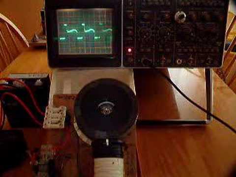

                            Below is the most informative vid I ever saw on choke/node inline w/ the trigger.
                            keep in mind the build is not to spec, he uses neos etc... but IMHO it does a good informative job w/ some of what is going on.

                              Mike you know what an inductor does, you know what a bridge rectifier does... when you put them together you get a node. I would encourage you to try one. as with all inductors (chokes) they can be wound differently and it will be different for EVERY BUILD.... I would not have recommended it if it did not make a difference... sometimes Tom C
                              • Originally posted by min2oly View Post
                                I think the 4 degrees is w/in tolerance - no
                                I can run it much cooler but it takes longer to charge. Remember, I am using 10 POUNDS of 18 AWG w/ 3 transistors. I'll try switching the charge bats and see if it improves.
                                My front end fully charged on wall wart to 30V - charges my C20 discharged to 23.5V back to 30V on one cycle - meaning my front end is fully discharged by the time the charge bats get to 30V.
                                4 cycles now.
                                I know - add more batteries on the back - best advice ever!
                                Kind Regards,
                                Patrick
                                yea that's from lee he does good work, his inductor has no bridge... Tom C
