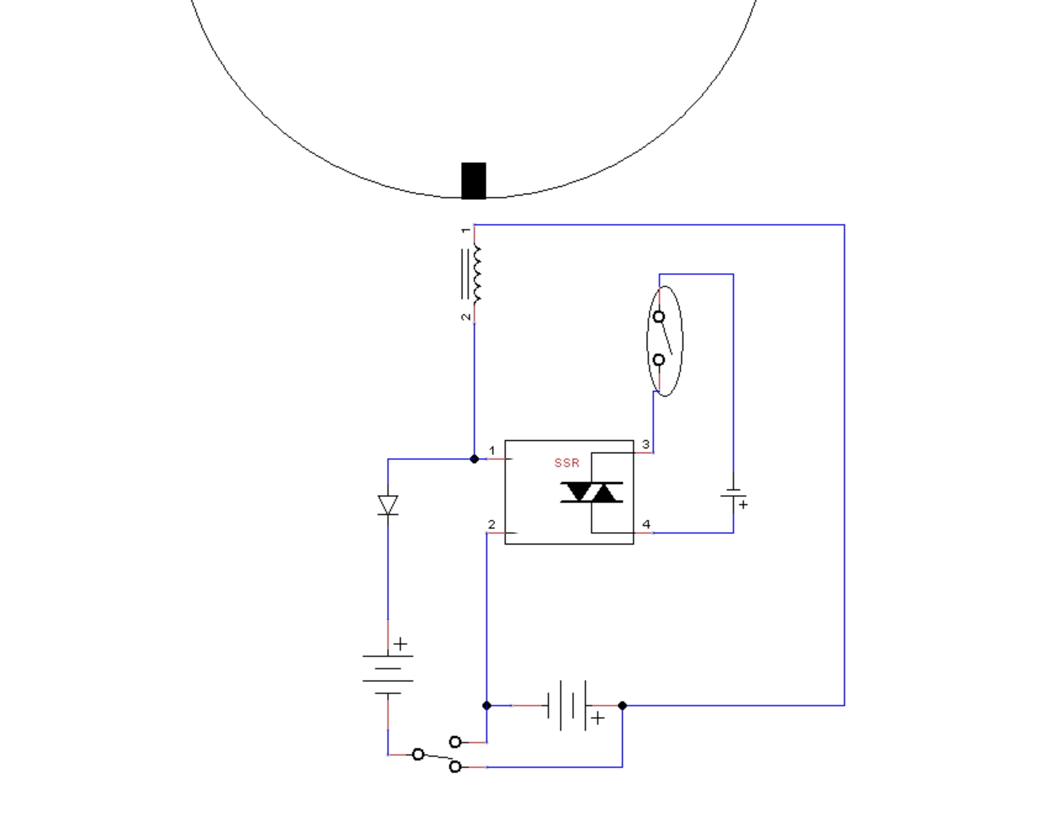

        • ok Bob,
          show me a Schematic of what this circuit is, so I can understand how it is different from a standard SSG, just using a SSR in place of a MJL.....
          • Originally posted by RS_ View Post
            ok Bob,

            I will try to put together some drawings for you RS, I get that you would want to see it in that form and I dont mind trying to draw it out for you. It does have some differences but mostly it is the same my friend and that is the point really. You had made a comment that SSR's suppress the spike so don't use them (paraphrasing here) and I felt obligated to show how I run on SSR's and know how to not kill the spike.
            You said how is it any different though,,, So it is a little different but yea it is a close replacement. The main thing to realize about this current setup is that all the coils are firing exactly the same time because it's a central switch. Basically as if you ran one transistor with multiple coils into the collector,, Heh actually I know John K does that alot. Anyway what else is different well its basically a FET inside so the trigger is very low consumption and with the SSR it's an optical switch.

                        • not meant as a attack on you Bob, but once again, show me a Schematic, so i can see how it is different from a standard SSG...... A work around is always GREAT......
                          • Is this it:
                            • Originally posted by min2oly View Post
                              Is this it:
                              [ATTACH=CONFIG]5617[/ATTACH]
                              Thank you Patrick, yes sir that is it. You even put the mode one/common ground switch in there, nice.
                              Of course there are more coils but I explained that and commented on how that is different. I will just say for convenience that they are all on the same single switch so you do not have the types of issues you could have with base resistors slightly off or mis-matched BJT's etc.. The coils are all the same length and measured of equal resistance but that is less relevant because they are all joined parallel to the same junction points.
                              RS there are a lot of differences but in many ways it is the same. There is no trigger coil for example so you do not have the same interplay between the power and trigger windings. Also as a result of not using a trigger winding and using a wheel and reed instead your trigger time is fully adjustable, meaning on a regular setup the trigger is fired via induction of the main wheel so there is a relation to the main rotor's rotation and degrees from the coil which is shared by the power and trigger, with this setup you can just back or advance the timing wheel however you like. I showed in that long video a bit about that.
                              Another potential difference going with something like this is the starving base issue with large setups or weak trigger coils. You know how if you have to many transistors and your trigger winding will just get to a point where is will not provide the current for all of the BJT's trying to fire their base from it, well FET's use hardly nothing so you would never be limited by your base current ( or lack of). I could go on and on pointing out how this is not exactly the same but I do not want to open new can of worms so I will leave it at that.
                              I will say again that this has never been an attempt to "do it better" it is only a way to do it different.
                              *EDIT*
                              Patrick just a side note that if accuracy is what we are after you forgot the diode on the common ground return,,, but I'm not nit-picking you, again thanks for doing that.
