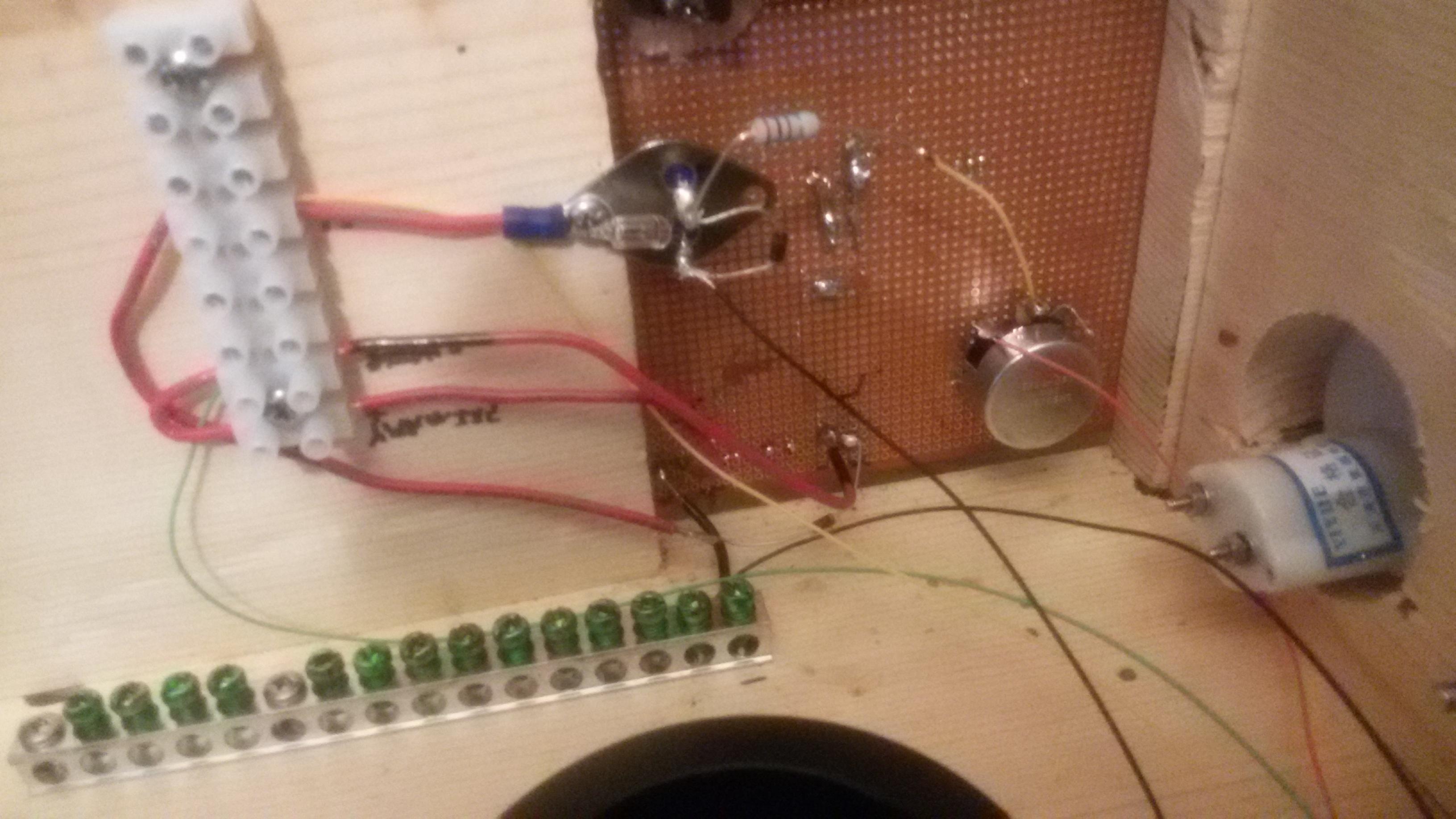

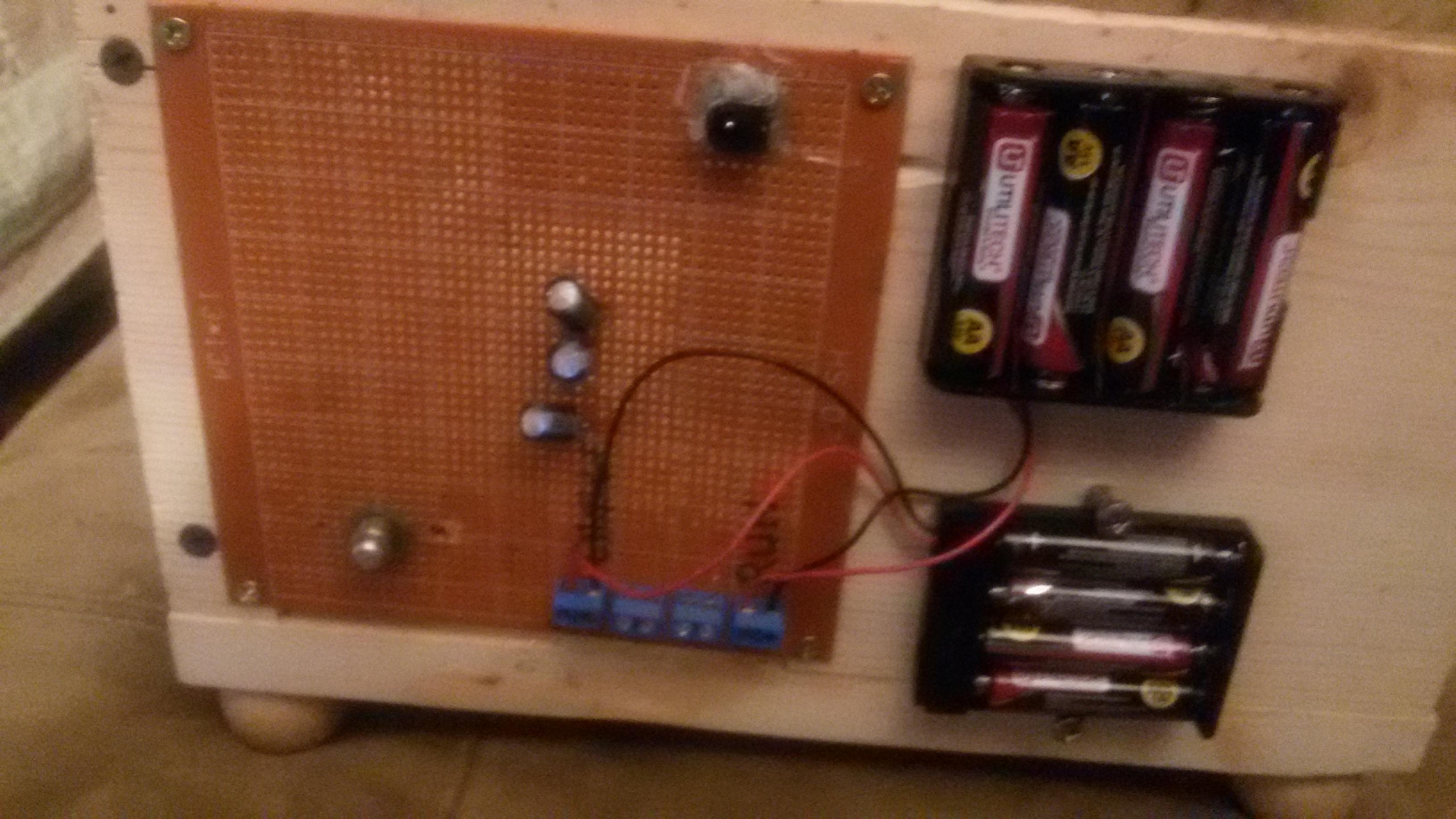

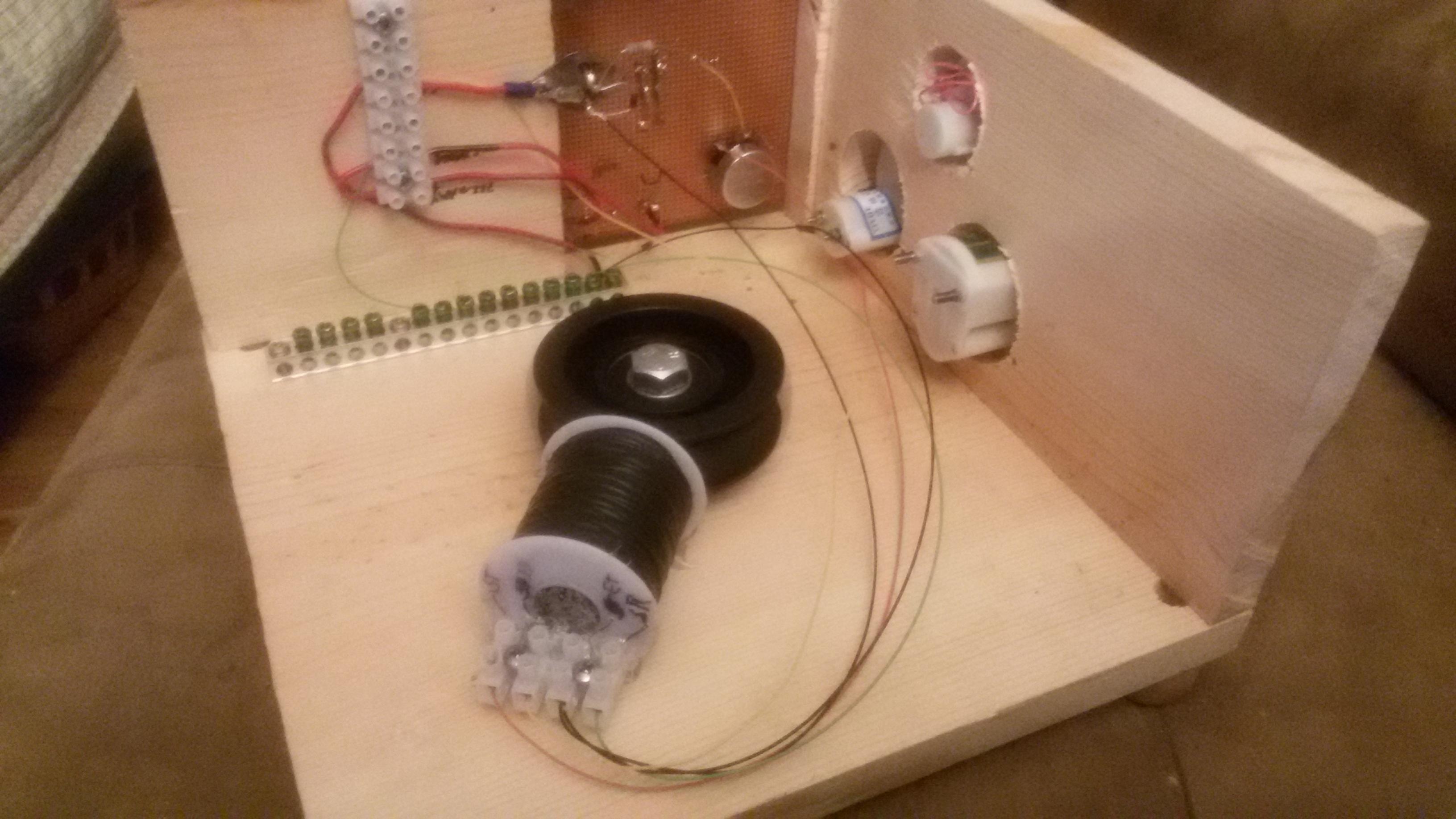

                            Awesome!! I am slowly getting the things I need to build the bigger wheel... in the meantime, I re-built the entire circuit for my little machine today. I used THIS schematic of the SSG circuit, cause I think its the same as Johns, but easier for me to understand than the other one shared with me... Definitely different than Daftman's circuit!
                            I have to say that my little machine is running very nicely!!! I really like this wire-wound 1k pot too!!! Its so much easier to use than the linear pots I got from the Shack! The "Sweet spot" if I'm measuring right is around the middle of the turn... its definitely not running at max RPM, but seems (if I'm reading it right) to not put out as much voltage at max RPM... It seems to be working great for a little machine with only 4 magnets, even though I have NOT had the chance to change out the core material with these welding rods yet...
                            I have 4 AA batteries hooked up as the primary, and 4 AAA batteries hooked up as the charging battery. At the moment I have all alkaline on it, but I'm here watching it at the moment. I can switch between battery banks as needed...
                            My real question here is this, HOW do you measure voltage and current being produced verses the amount of voltage and current being used??? I'm really confused about where to place my leads to get the right readings.
                            Can I get any help with where to place my leads to get accurate readings??? Please refer to the circuit schematic I posted so I will understand where you are talking about. I want to figure out voltage and amperage... for usage and charge rate.
                            Thanks!!!
                            Here's pics of the little box redone... I disconnected the DC power jack, and never mind those caps, there not hooked up...
                            “Whether you think you can, or you think you can't, you're right.”
