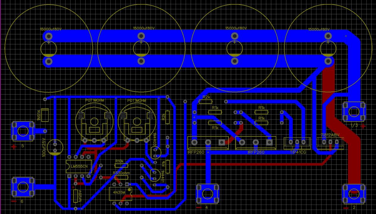

          • #20
            Hi Richard,
            thank you for your advice !
            Here the PCB corrected.
            Should the traces be even wider ?
            Any other suggestion ?
            In your opinion the chips are correctly connected ?
            Any other suggestion would be very much appreciated...
            all the best
            Cla

                • #23
                  Hi Claudio,
                  Have you built this circuit on a bread board to make sure it works as shown in the Schematic...?
                  It does not look like you have the cap pulser Mosfets hooked up correctly.....
                  The traces that connect the Mosfet's Source and Drain need fat traces too.
                  The 2 transistors that drive the opto are unnecessary, as the 555 can pull plenty of current to drive the LED in the opto.

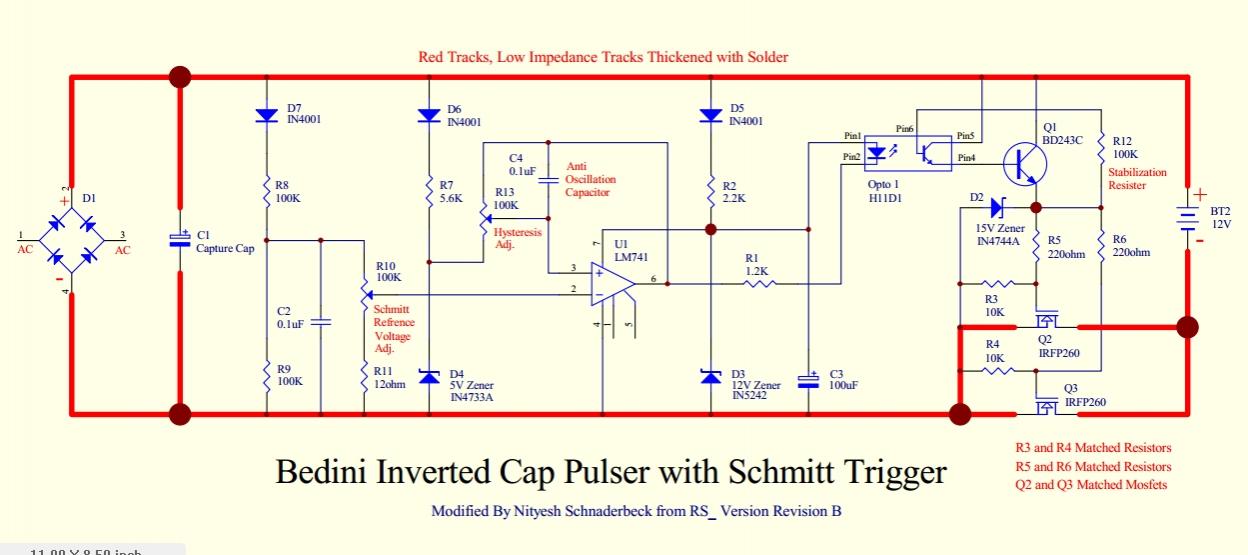

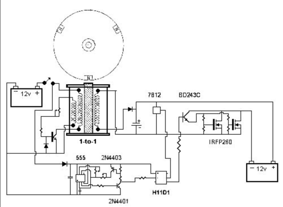

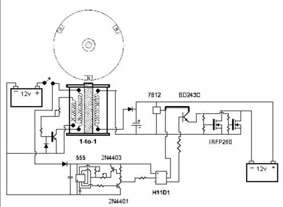

                    • #25
                      Hi Claudio, Gary,
                      After studying Claudio's sch a little more, the BD243C's collector is connected to the wrong place. It is connected to the Neg of the charging batt, and not to the output of the regulator, or the Pos side of the cap. There is no voltage drop/bias across this Mosfet circuit that can trigger the Gates of the Mosfets.
                      If this Sch came from a A&P hand book, I think it is wrong, and needs to be fixed, and a new one sent to everybody that bought a hand book.
                      Refrence the Compartor Circuit Gary posted above to see the correct bias to apply to the Mosfet Gates's...
                      Gary, Nityesh, The D2 zener is not needed, unless you are blowing up Mosfet gates when charging 24V 36V or 48V Batts. And if that is happening, then you need to connect the collectors of the Opto and the BD243C to the 12V connection that powers the comparator, and up the amperage of the D5 Diode....
                      If the the Gate Power Max V is 12V regulated, than a 15V zener is just transient protection for the Mosfet's gate's, vs being a current drain through the BD243C on the Capture Cap when the V is 30 40 V+ on the 15V zener, across that transistors voltage drop....
                      Nityesh, good job on tweaking out that Sch I derived from JB's presentation.....

                      • #26
                        Hi RS,
                        If this Sch came from a P&A hand book, I think it is wrong, and needs to be fixed, and a new one sent to everybody that bought a hand book.
                        That is indeed the sch shown on page 47 of the Intermediate Handbook! As you pointed out, the BD243 collector should be connected to the Pos side of the cap and regulator.
                        It's been a few years ago that I built this and don't remember now if I corrected that error or not. All I remember is that it didn't deliver a very high discharge voltage across the charge battery and with only two Mosfets it blew them both out after awhile. I tore it all apart after that so can't go back and look at it now.
                        I used four Mosfets when I built your Nityesh modified comparator as posted above, with only a few modifications of my own to add an LED that would flash each time it dumped the cap. I hand wired it on a perf board and used flattened out copper tubing to connect all the mosfets and caps with #8 cables to the charge battery. It seems to work pretty well and delivers a strong enough pulse to forcefully jerk a hand held magnet when held close to the 8 gauge battery cables.

                            • #29
                              Gary, Richard, RS_,
                              thank you for your inputs, but I am a little confused ...
                              RS_ you are saying that JB ad P. Lindemann are showing a WRONG scheme ?! I am sure you know what you are saying and you are far more advanced than me in electronics but is very hard to believe..
                              I will test the circuit on a bread board before send to manufacture a PCB.
                              I will adapt the copper gauge at best, maybe a good idea would be to leave the caps and the route to the batteries outside the PCB copper and solder them with 8 gauge wire.
                              About the BD234C, I think I correctly followed the scheme of the book, but you say it is wrong, could you please show me how (if possible) you would correct my scheme on the PCB ? I am putting numbers to help you explain

                              • #30
                                Claudio,
                                YES, that is what I am saying! and I am pretty sure that PL and or Aaron drew that out with cut and paste from JB's Drawings, vs JB drawing this out his self. and mistakes happen......
                                Here is a corrected SCH. I hooked the Collector of the BD243C to the 12V regulator.
                                Try that out, vs the original on your bread board to see what works or not....
                                On your PCB layout, i would rearrange the 7812, BD243C/TIP41 closer to the opto and timer, and push the mosfets over to the right, and then make the traces to the collectors and emitters fat, and as short as possible....
