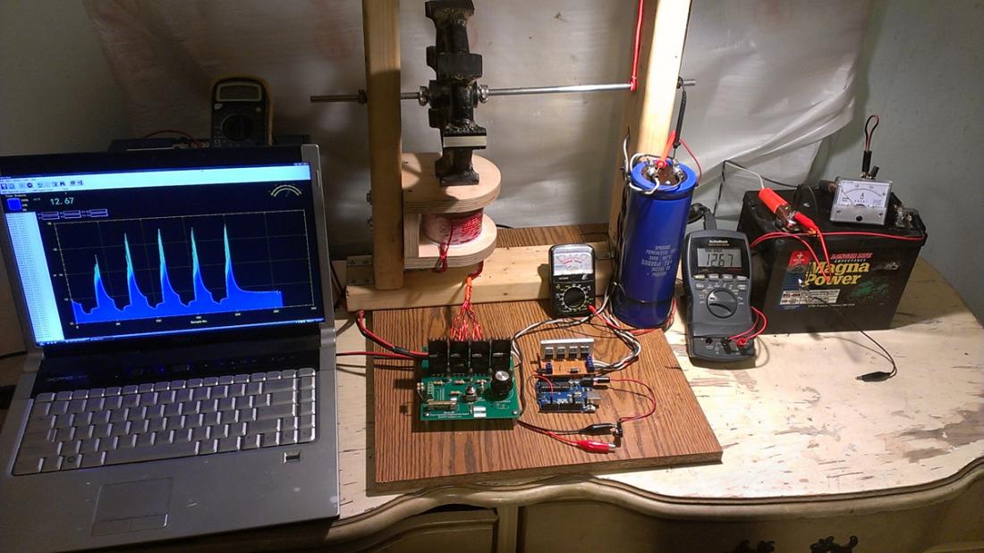

    I have setup my monopole in a new configuration based on the information Mr. Bedini gave in Part 33 of the energy series and I wanted to share.
    This is not a true Mode 3 because it is not using a comparator circuit however the results of what I am doing are pretty close. The difference is that my system is timed by a micro controller for which I can code the off period and the on period of the control signal which dumps the cap. The timing is completely adjustable.
    The following test runs were done to emulate what Mr. Bedini showed in the video as closely as possible. I am charging the cap to 25v and dumping to the charge battery on the negative rail, positive is connected parallel from the cap to the battery. The monopole is running in generator mode, so we have what Mr. Bedini showed with the acceptation that my cap triggering is different.
    The duty cycle is set as such (coded on micro controller)
    1.5 seconds OFF
    0.5 seconds ON (when on we are dumping the cap)
    At the speed I am running the monopole this charges the cap to 25v and then dumps a 4A pulse and then it repeats.
    I would estimate the primary draw is between 1A - -1.25A. It is hard to say because it jumps around on the meter. What is not shown in the video is the additional draw of the micro controller because it is hooked directly to the primary and not through the amp meter. It pulls around 40ma to power itself and provide the gate pulse to the Mosfets.

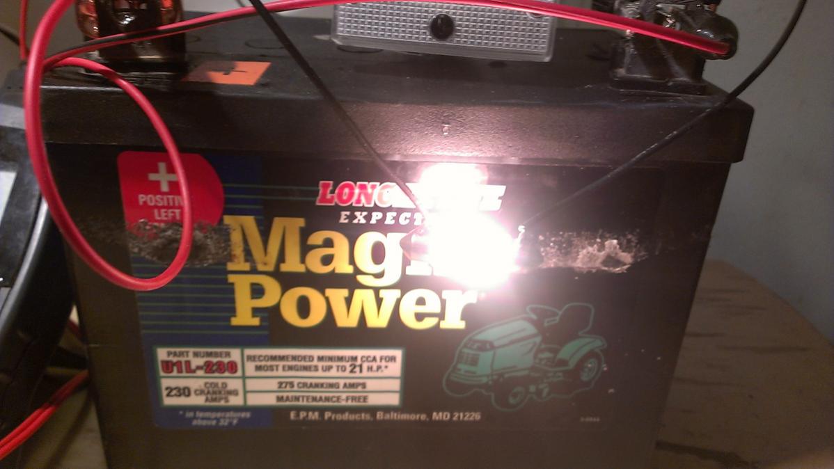

    The charge battery is a typical Garden tractor type. This battery was brought back from the grave by a different machine but I mention it because this is not a new battery. It was given to me after years of service in a friends tractor until it would not start anymore and the battery would not charge for him ;-)
    The load we are using is a 13.5v,,, 5Watt automotive interior lamp.
    The capacitor is 60k uf in a single package. Notice the shape of this cap, tall skinny like a flash cap.
    Here is a wide shot of the whole system on the bench.

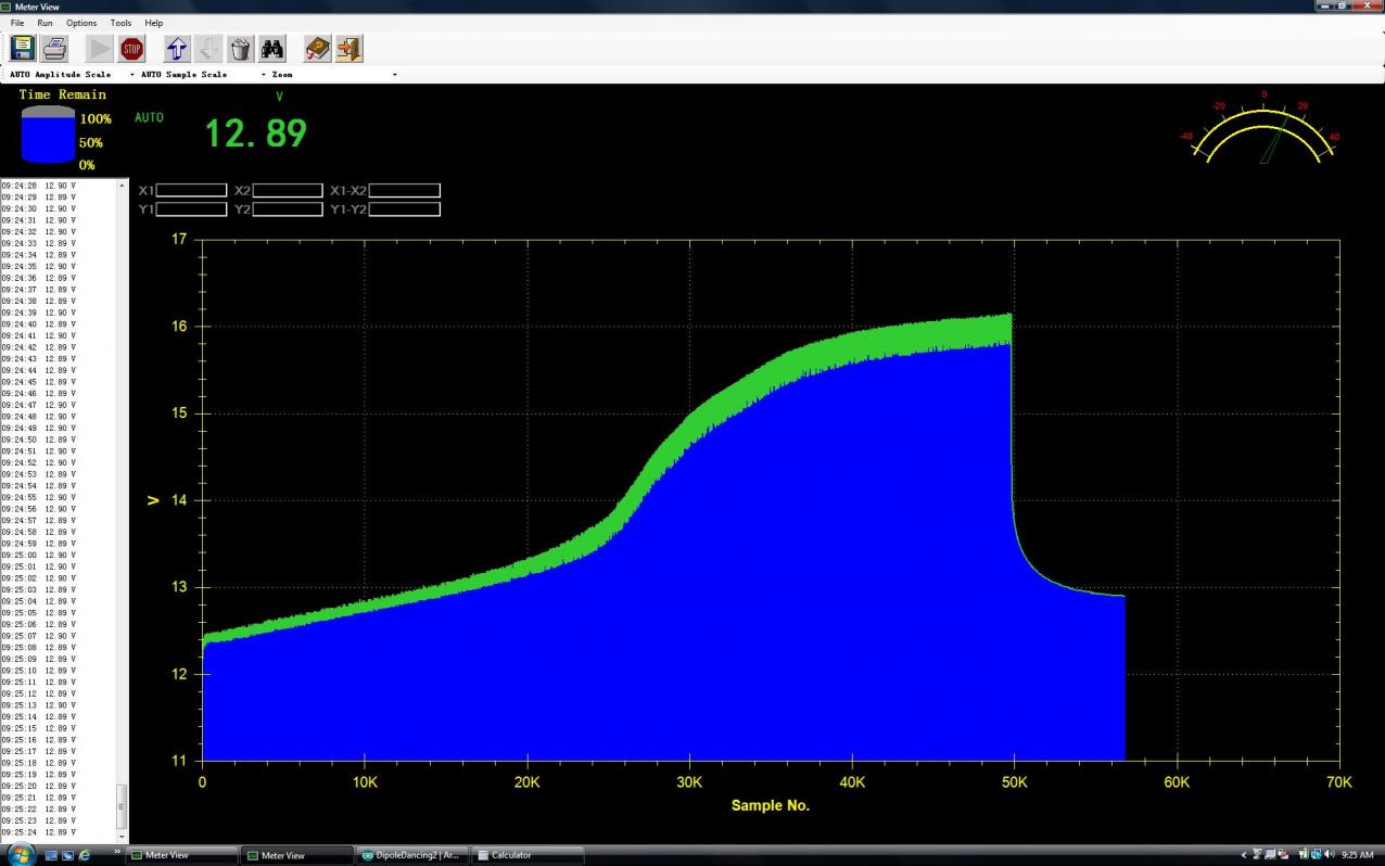

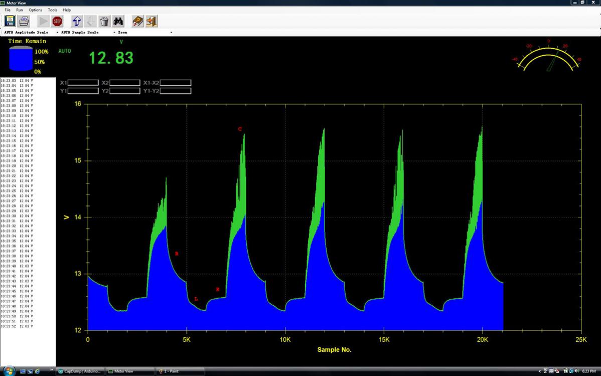

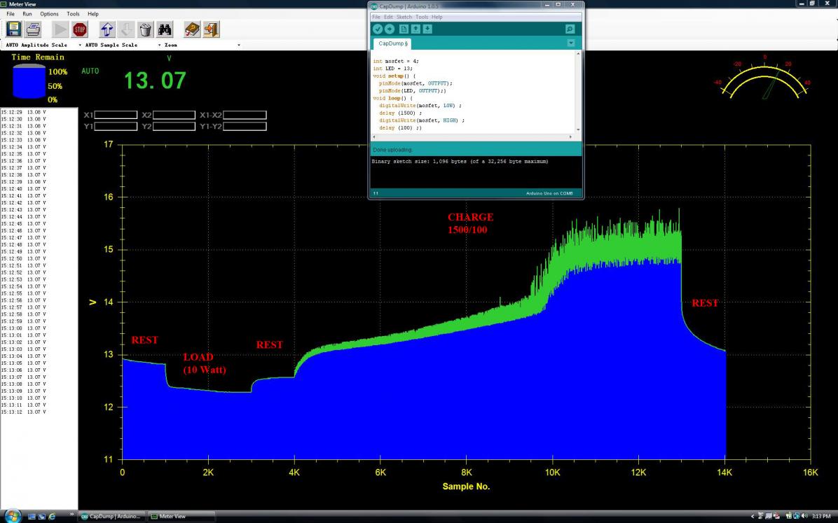

    The chart is showing five complete cycles done consecutively. Each stage is 1000 seconds which you can see at the bottom of the chart. That works out to be 16.66 min each.
    I have marked each stage on the chart so you can understand what you are looking at.
    “R” This is a rest period (1000 sec)
    “L” This is a load period (1000 sec)
    “C” This is a charge period (1000 sec)
    So that is a complete cycle of which we have five of them on the chart. The battery was pretty well charged to start with. This chart is to show pulling a load and charging back up then doing it again. It is not intended as a chart for looking at a full charge cycle from dead to charge. In fact I did not let these charges peak, it was based on the 1000 seconds per stage to keep everything even.

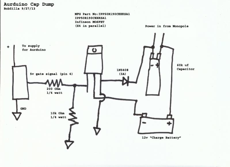

          One a side note would you be willing to post a brief schematic of your MOSFET dumping circuit. I'm working on building one very similar and I'm currently using it to time an SSR to dump into my Charge battery. However I'm quite sure the SSR is damping the peaks of my output pulses. I have some nice Power FETS but am having some trouble getting them to stay off. I can make a simple circuit and the work, even test it out with an Ohms meter but as soon as I put it in the circuit the MOSFET won't shut off.

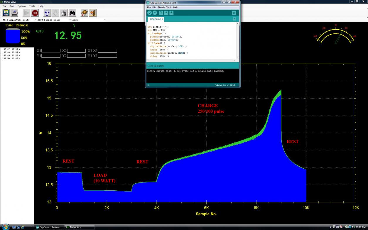

            I did some experimental test runs with different timing too compare the results. Now obviously there are other variables at work here and this is only two runs so it is not enough to be conclusive but I think it does demonstrate a basic behavior.
            First let me say that in these charts I have the machine running in regular mode 1 with cap dump. I wanted to compare this to the same runs under mode 3 but I have not had time to do the mode 3 runs yet.
            So in the first run I have the machine drawing at just about 1A. I have the timing set to 250ms OFF/ 100ms ON. That resulted in about 16v cap voltage with 1A dump current very rapidly. I changed the discharge load up to a 10 watt lamp this time and loaded for 2000 seconds. The charge came back up in 5000 seconds ( it’s all in the chart)This configuration charged the battery very well.
            The second test used the same load and rest/load times. On this run the timing was set to 1500ms OFF/ 100ms ON. This resulted in a cap voltage of about 25v and a 4A dump current. I wanted to keep the ON time at the same as previous for a good comparison of just the pulse frequency and not the amplitude.
            This charge took longer and in general just does not look as good as the previous one. I think what is very telling is to notice the green section that floats above the blue. This is a quick voltage spike. It looks to me like it must be excess that is not being absorbed. I suspect that this will change with different batteries but what is optimal is to find the frequency to where you are not over doing it. (more like the first chart)
            For this particular battery I think it is obvious that 1A pulses at a fast rate are absorbed much better than 4A at a slower rate. Look closely at those charts, especially the green section and hopefully you understand what I am saying.
            Joster,
            I will draw up the circuit and post it for you a little later. Keep in mind that I installed a switch on the monopole to go between mode 1 and mode 3, so I do not recommend powering the arduino directly from the primary. In mode 3 I was doing that just fine but I would not try it in mode 1. Just use a separate supply. I put a little 5ah 12volt on it for mine.
              Here is the circuit Joster, excuse the crude drawing ;-)
              Hope it helps!

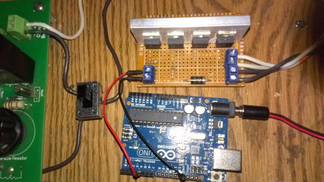

              And a close-up of the board although you cannot see the connections because they are on the underside.

                  I wanted to know where you got that wicked cap! and if it's an actual photo flash. I have 4 6800uF photo flash caps that seem to be working ok.
                  Regarding the schematic. I assume that that's the drain connected to the negative of the charge battery and the source is connected to the negative of the cap. I wanted to ask what is the purpose of the diode? The way it is drawn seems to be backwards but I must be missing something. I will be able to graph the charging with my CBA 4 when I attempt to duplicate what you have found.
                  cheers
                  Joe
                    It is not a mistake, but I knew you would look at that and ask ;-)
                    Just try it out bro, you can use any mosfet on a breadboard with a small cap and a small diode. In fact when I was testing it out I used a breadboard, a 1N4007 and a small 1500uf cap, my testing fet was from radio shack, just a run of he mill mosfet..
                    I know it look backwards but everything I drew is how I meant it to be and how my circuit runs.

                              What I have done is make a new cap dump board with only one mosfet and I upgrade the diode to a fast switching 8 amp diode. I wanted cleaner switching and I figured the four mosfets on the other board were probably not triggering at the same time, same issue we have with matching transistors. I am getting a little heat now because it is only one mosfet but it is still not bad, about 20 degrees over the rest of the circuit components. That is not the thing I want to share but it is worth mentioning for anyone keeping track of how this system is setup.

                              Here is another video so you can see it in action.
                              https://files.secureserver.net/0sq3iS0e5LrwVt
                              It is too early to say really if this is of great benefit but I am happy that I am able to produce the effect at will. I think what I may do is compare some runs like this and then lower my cap dump down to about 35V, just under where the spikes appear to see what effect it has on charging, and the primary. I have to believe that inducing these 400v spikes contributes to the gains but more testing to come.
                              SO many ways to tune these circuits! ------Bob
