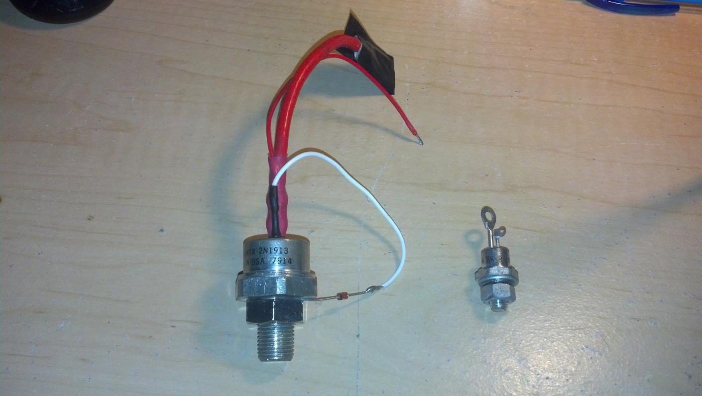

                            I've had good success using a heavy duty SCR and one zener diode. The sch is below. All I do to adjust the voltage is swap out the zener for a different value. Right now I have a 16V zener on there. So 16V + about 2V that the SCR requires and that's roughly 18 volts over the battery voltage. I felt that this was better than using a 12 V zener because I wanted the battery to always have at a minimum of double the voltage hitting it. When the battery gets up to 15.5V, that's more than the 12V zener would produce on this circuit. I've never blown out one of either of the SCR's shown below either.
                            Schematic:
                            A couple different SCR's I've used. The larger one is a 2N1913 and the smaller one says R16RIA60 on it. Found these at my local surplus store. http://www.skycraftsurplus.com/
