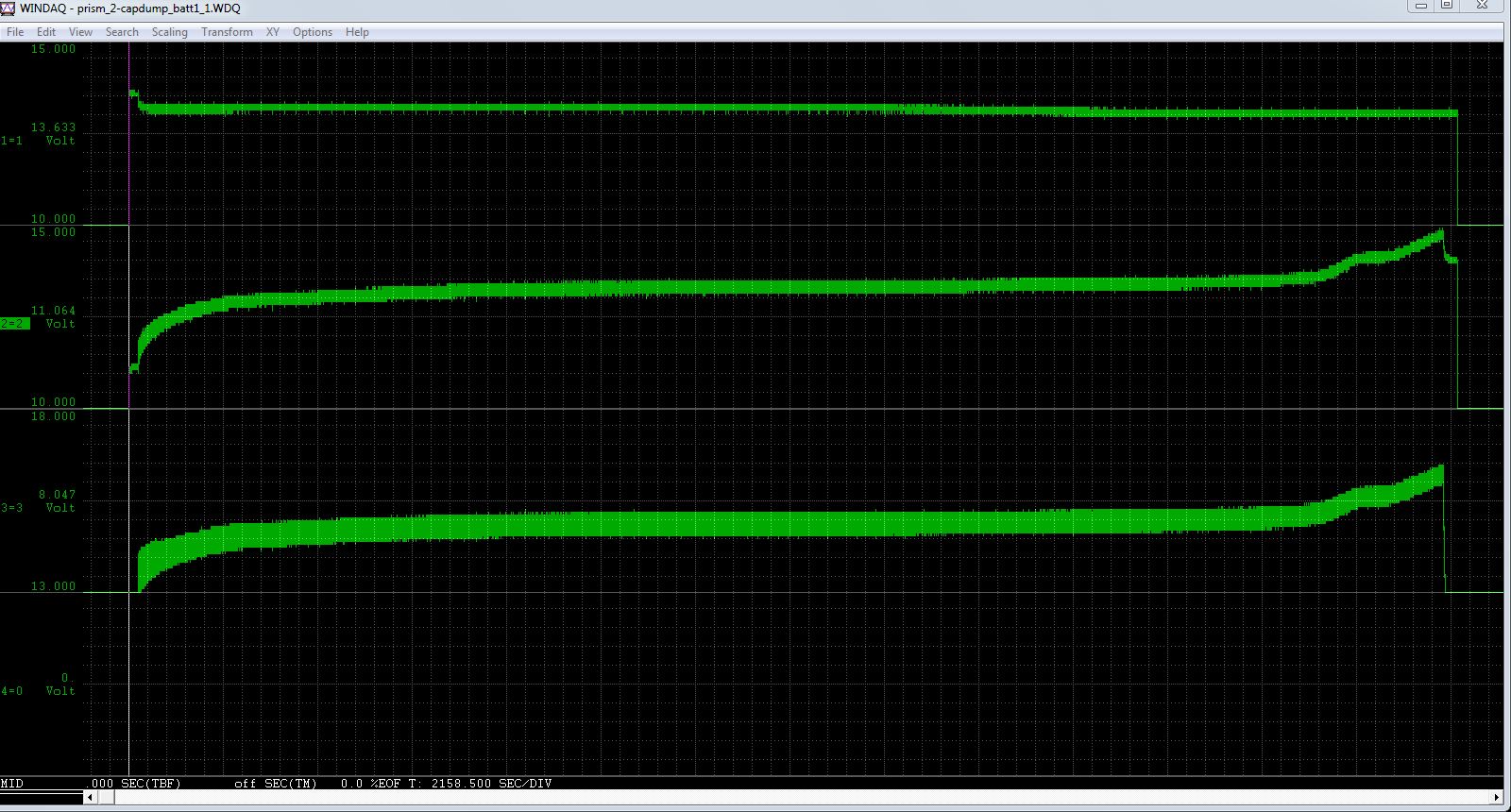

          I went ahead and did a full test run using the low voltage cap approach, same thing as the last short video but a full run to see if it would truly work.
          It did work pretty good but took a long time. I'm not sure I could tolerate doing this on a regular basis. This was just a small 20AH pack and I have much larger to consider. It as a good experiment though. I can charge the same pack with the lifepo4 charger and an inverter in about 3 hours because it is a 10A charger.
          Here is a chart:

            Hey Bob, that was a pretty good run. Even though it did take a while. You'll see a lot better charging if you fatten up and shorten the wires between the caps and the charge battery.
            I know it was an experimental test run, but I also would've run the SS SG a bit harder - around about 1A draw.

              John I had to run so low because of what I was trying to achieve with the low voltage cap dump. The issue is that once the battery is full I need the bleeders to pull off excess to maintain the 14.6 voltage. If I crank up the front then they cannot keep up and the voltage rises too high at the end. I described it a few posts back but I know it's not as clear in your thought as it is mine since your not working on it. I can charge them very fast relative to this run if I want but I have to catch it at exactly the right time and turn it off or they go way high at the end which is really bad for LifePO4. It's really just a matter of having a bleeder on the back that could drain off however much current I push once the top voltage is reached. I am trying to make it so that at no point in time the voltage those cells goes over 14.8 or so.
              I have thought about taking a zener diode and putting on the gate of a FET with the drain and source connected to the battery with a light bulb between. Put the zener to the pos and when the voltage is reached to pass through it then the fet closes and the light burns off the extra. Basically the same as the small bleeders do but across the whole battery. If I could get something like that working then I could increase the draw to as much as the bulb could keep up with.

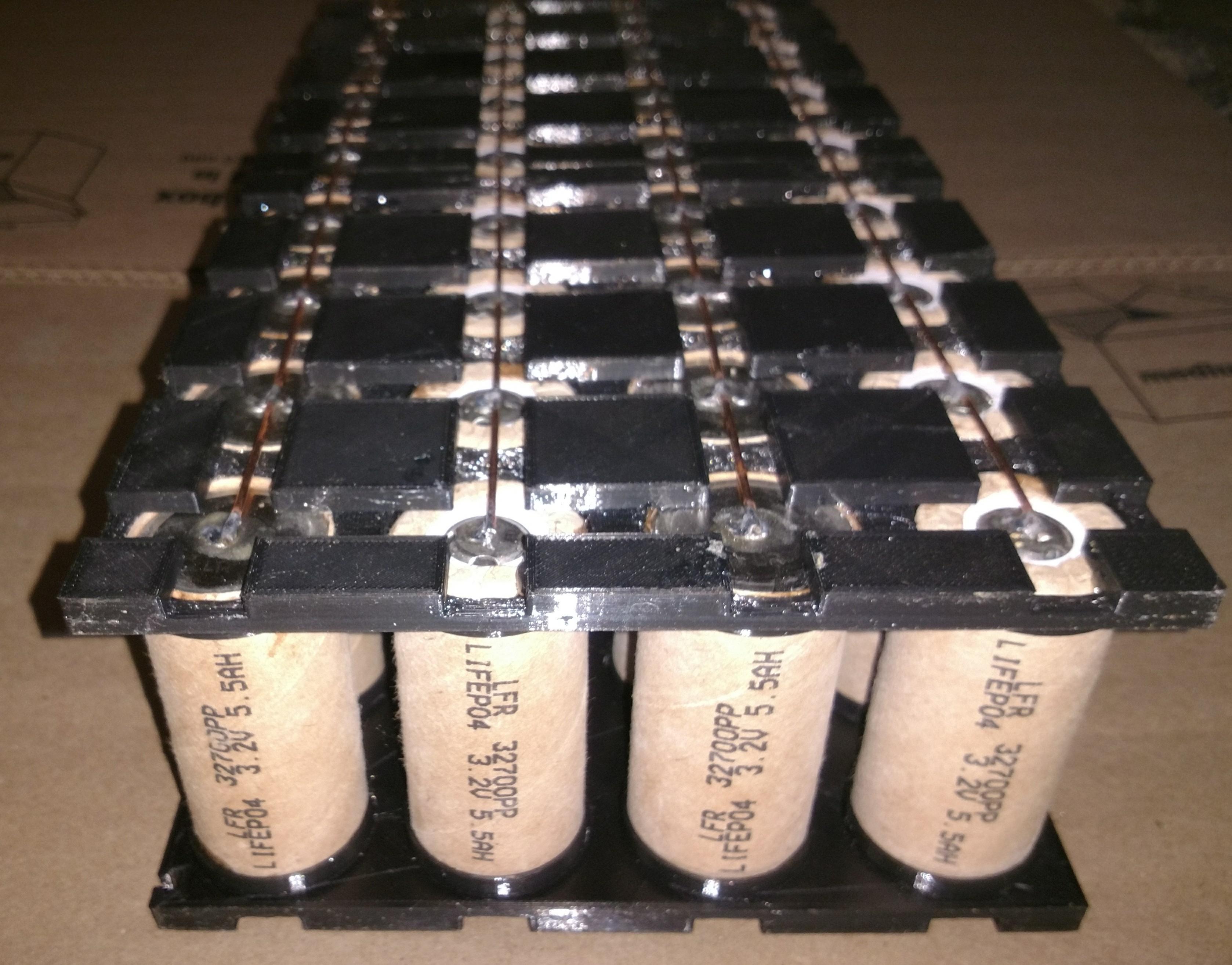

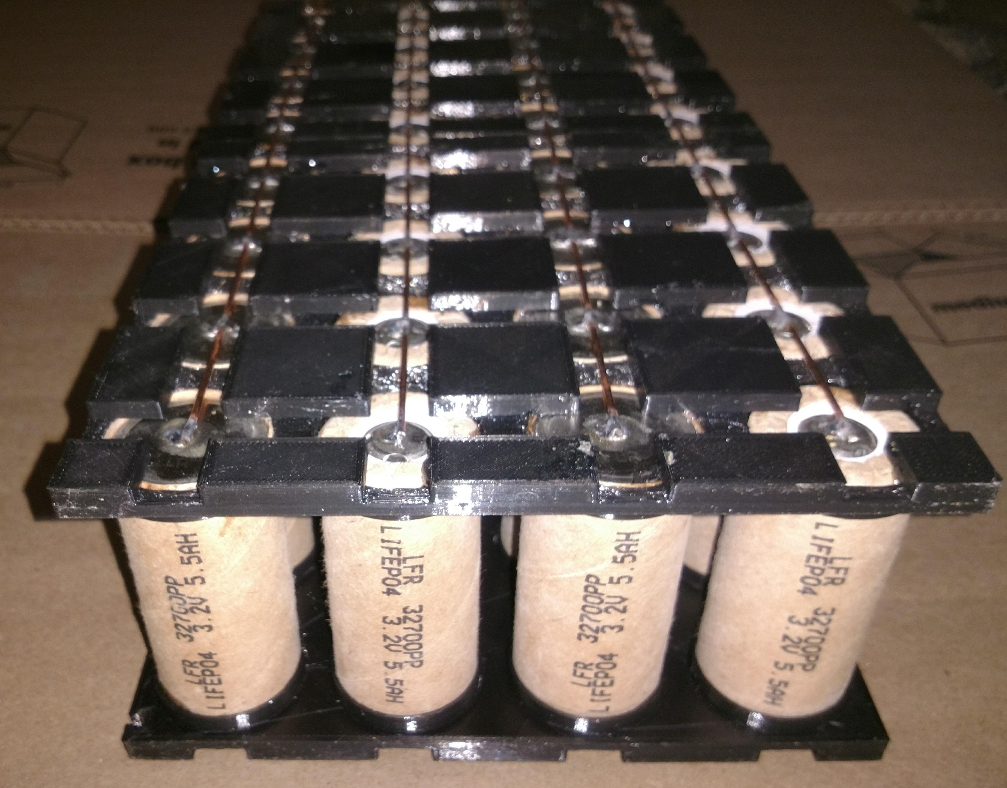

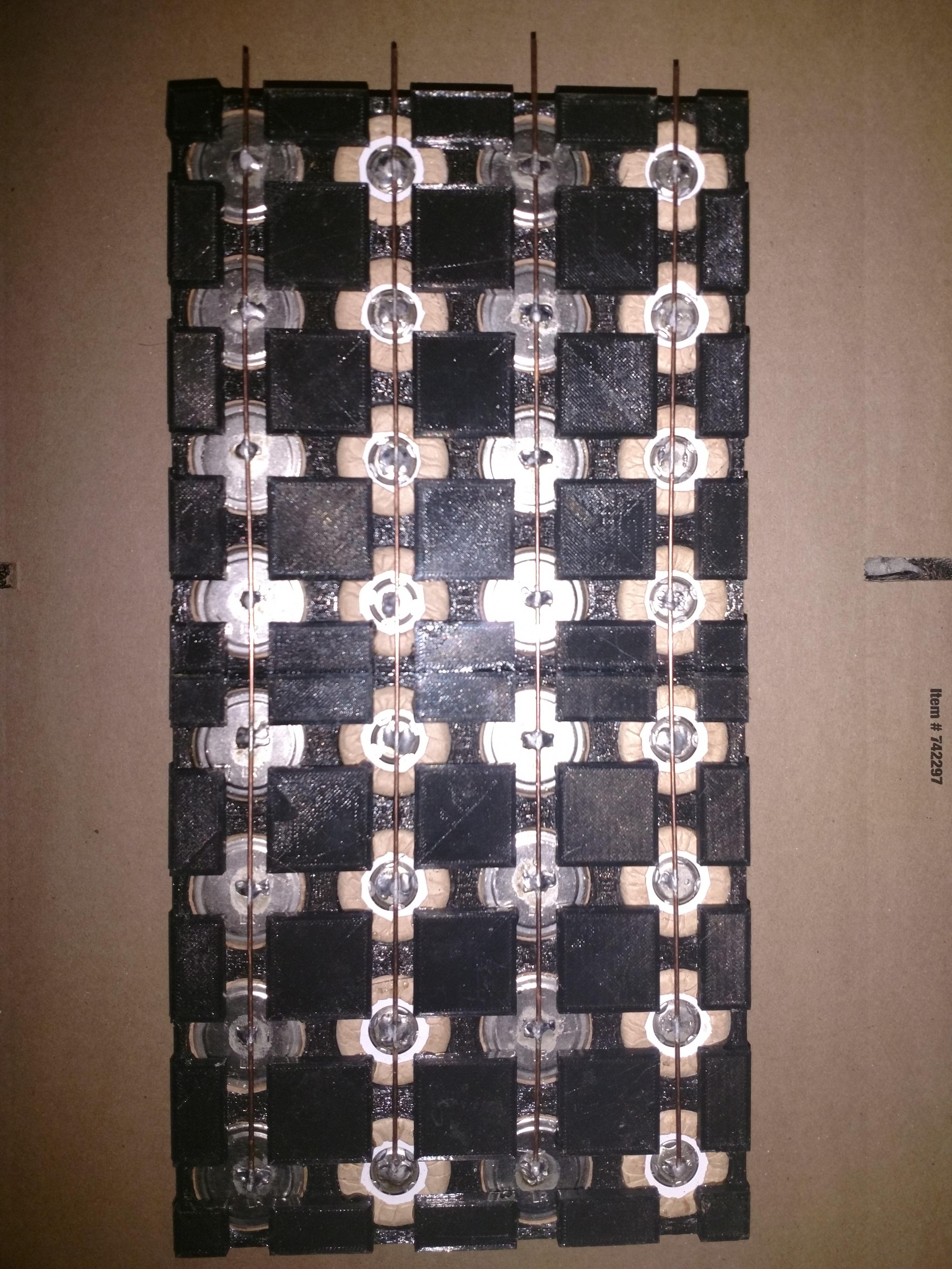

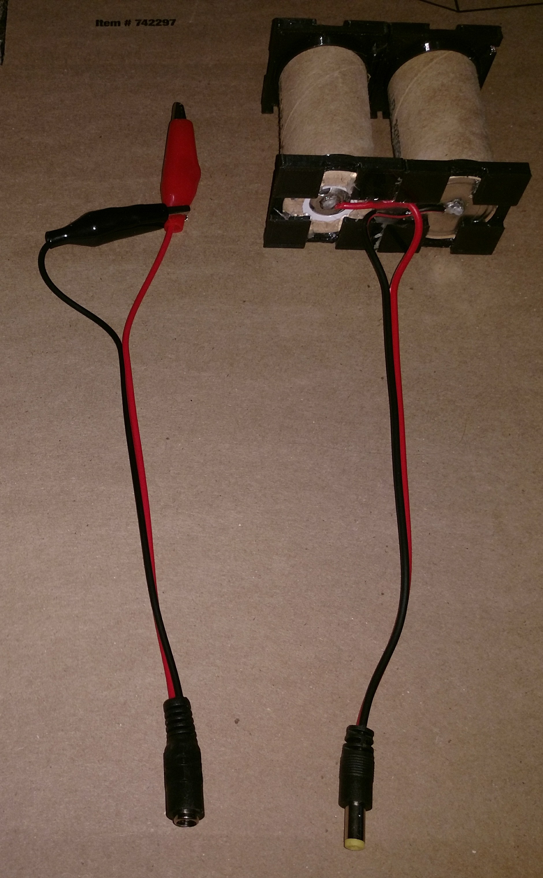

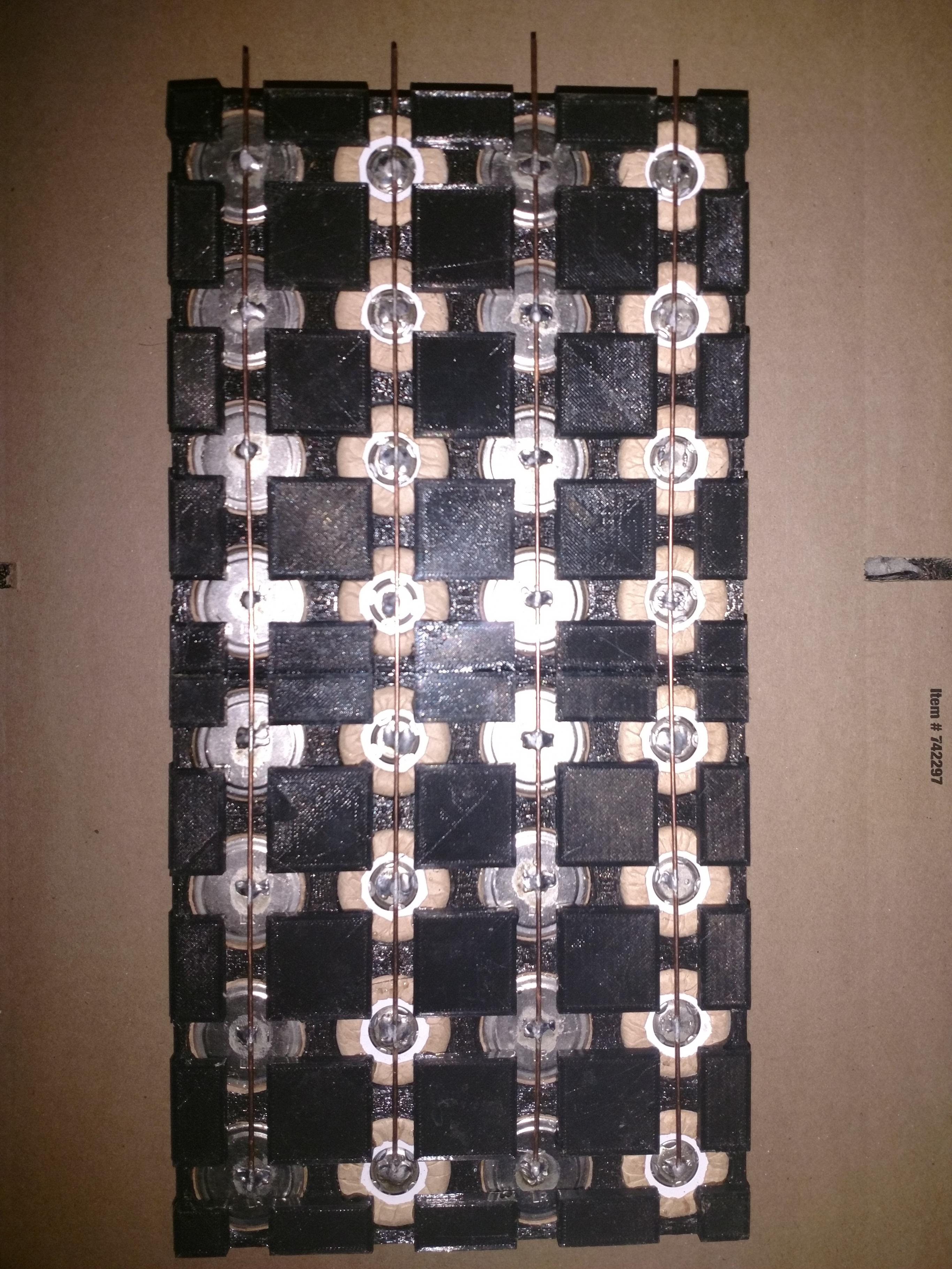

                            I have made some 3D printed frames for the LifePO4 cylinder cells. Below you can see a 44AH pack I am working on. It was made from four 16 cell trays that I printed up. I have made single, 4, 8 and 16 cell files both with and without tabs for joining together and making custom size packs. The cells are held in with a little 2 part epoxy and I am going to wrap and tape the whole thing as before. I like this design better than just gluing the cells all together as I did before.
                            I am not posting the files just yet because I still need to finish this one. I need to make a few pieces for mounting studs and get this one all finished up and then I will share the files if anyone is interested using them.

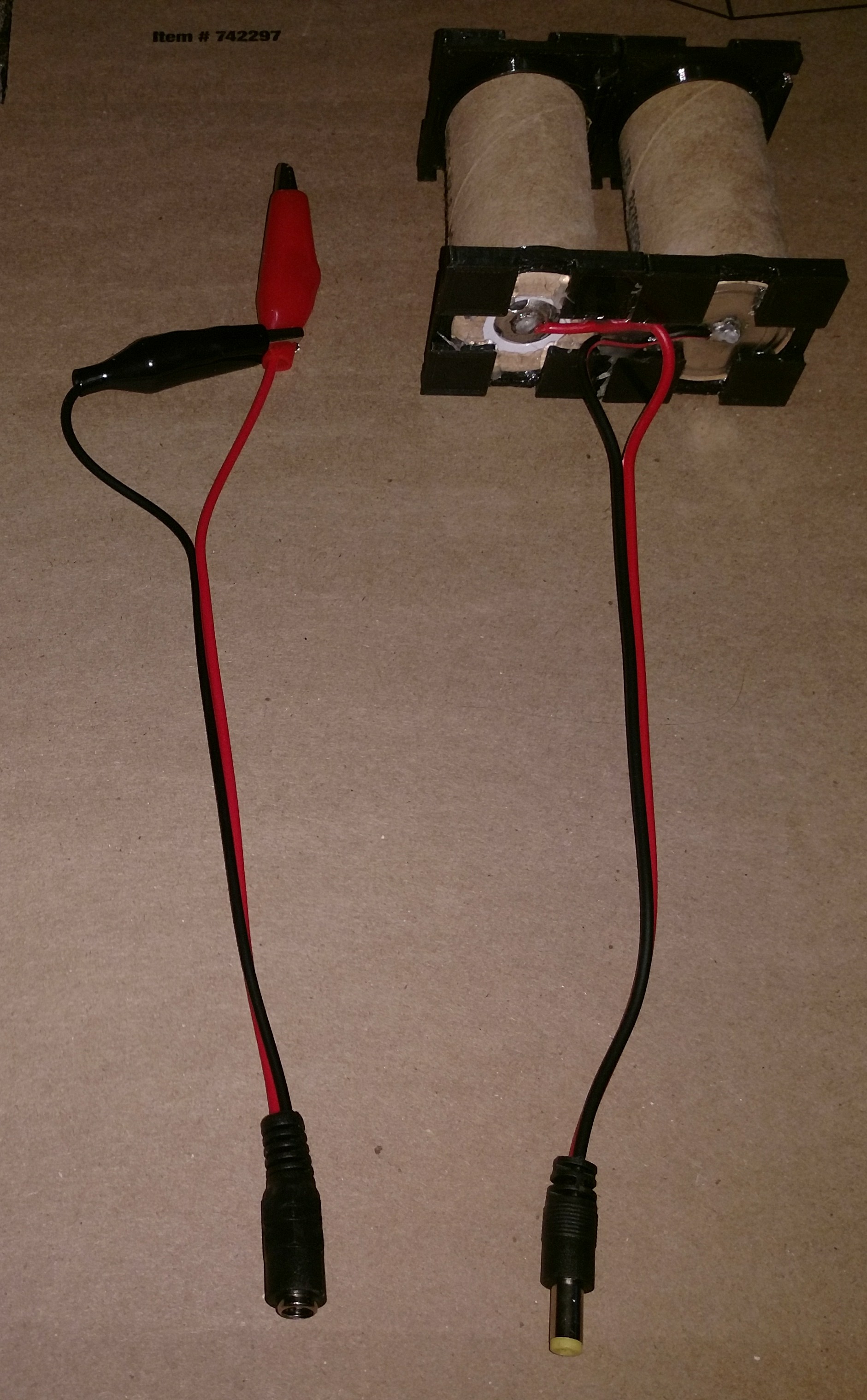

                            I made this little 6v pack to experiment with. I actually made two of them and I am going to take at least one of them and charge it only from one of my machines and see how it holds up.
                            More on this new big pack later. I am waiting on the studs and bolts to arrive for making terminals for it. I wanted this one to have standard posts instead of the Anderson plugs I used before.

                              Nice build Bob!! will be interesting to see what it looks like completer!!

                                I have wasted a lot of filament making mistakes but I am getting to the finished product now. I decided to make a side plate that will get glued on to cover the buss bars. I am leaning towards not wrapping it up with tape or foam now, it's just too nice to cover up like that
                                I discovered something awesome tonight with my printer. I never really played too much with the layer height before but I decided to give .35 a try and it is great for these larger parts. I can get these things printed SO much faster now and really they are just as good quality because of the simple boxy nature of these parts.
                                By the way guys I am using maker geeks recycled filament line and it is really nice for what it is. You cannot choose a color because it is made from scraps but last time I ordered some I got 4 rolls and they were a nice black. Anyway the stuff is worth checking out if color isn't important to you because it's good quality material and only $15 a kg. I have not had any issues like clogging or boogers on the nozzle.

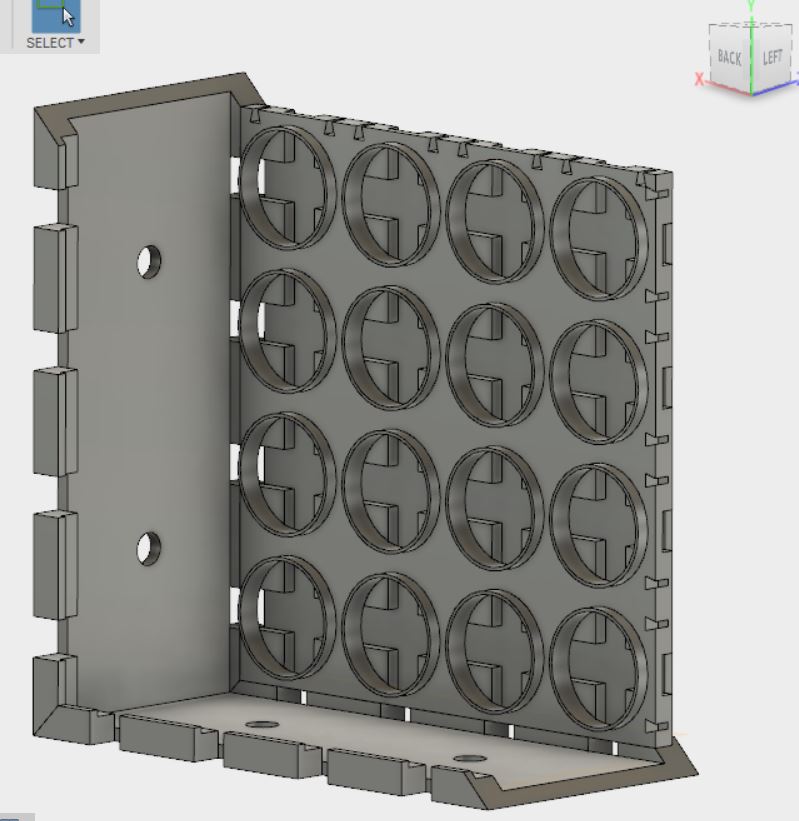

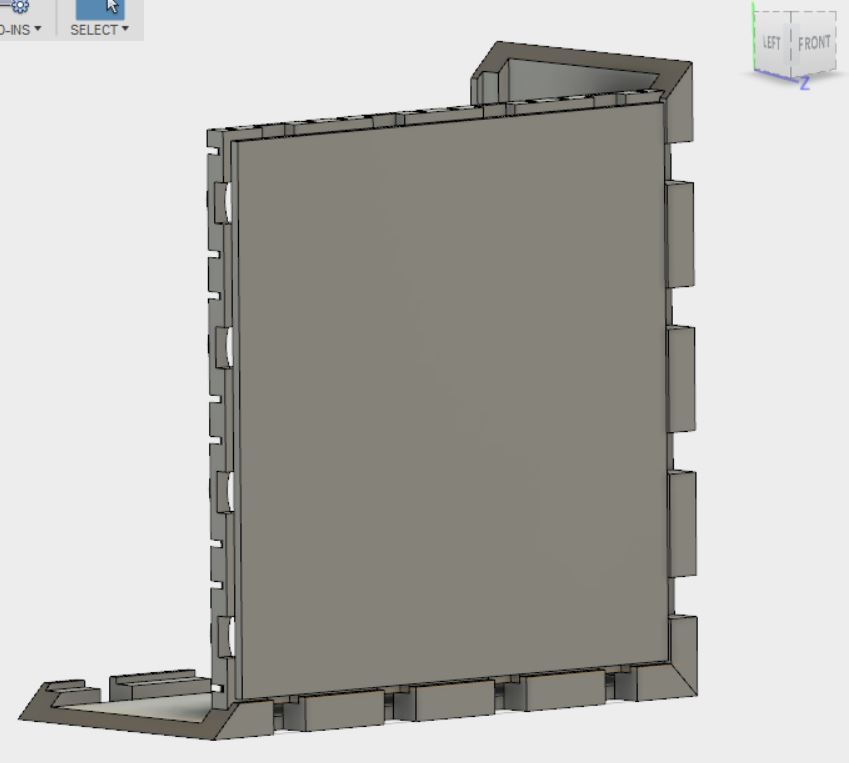

                                Here is a view from fusion of the parts. This is of course a cut away so you have to imagine the missing pieces with the cells installed.
                                I got the posts I was waiting on but realized I was going to need some washers and ring terminals so I'm waiting on another order now to finish building the large pack.
