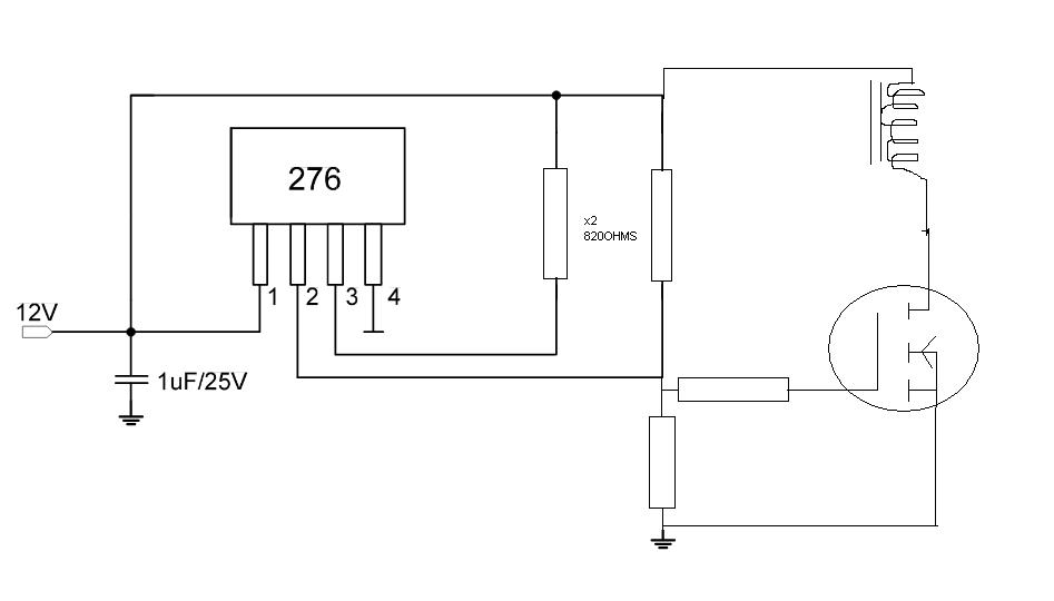

    decided to try out hall switching before my next build so i grabbed the junk box and pulled apart some fans and got the hall sensor out and connected them to a mosfet driving an SG bike wheel.
    seems to work as i expected, needs an astable, pulse width is quite long, charging seems good but the battery is pretty dry and sulphated.

    Have you schematic ?
      it needs a timer to change the pulse width, and an opto isolator if you are going to run higher than 12 - 14v

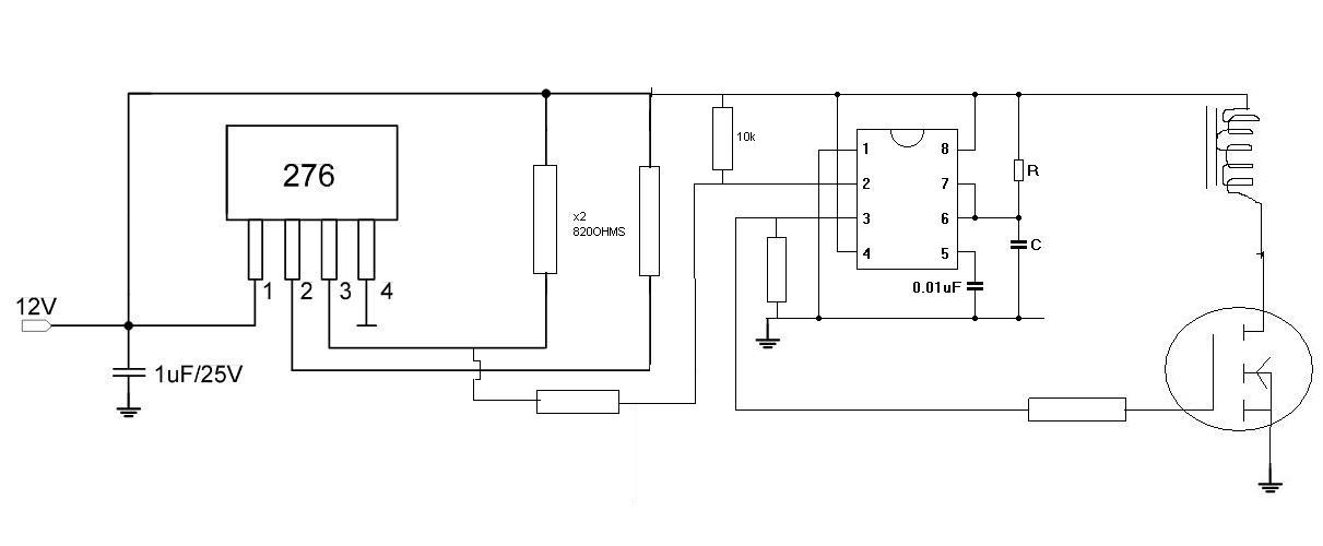

        circuit i will build next. one with resistors before holding pin 2 high is correct

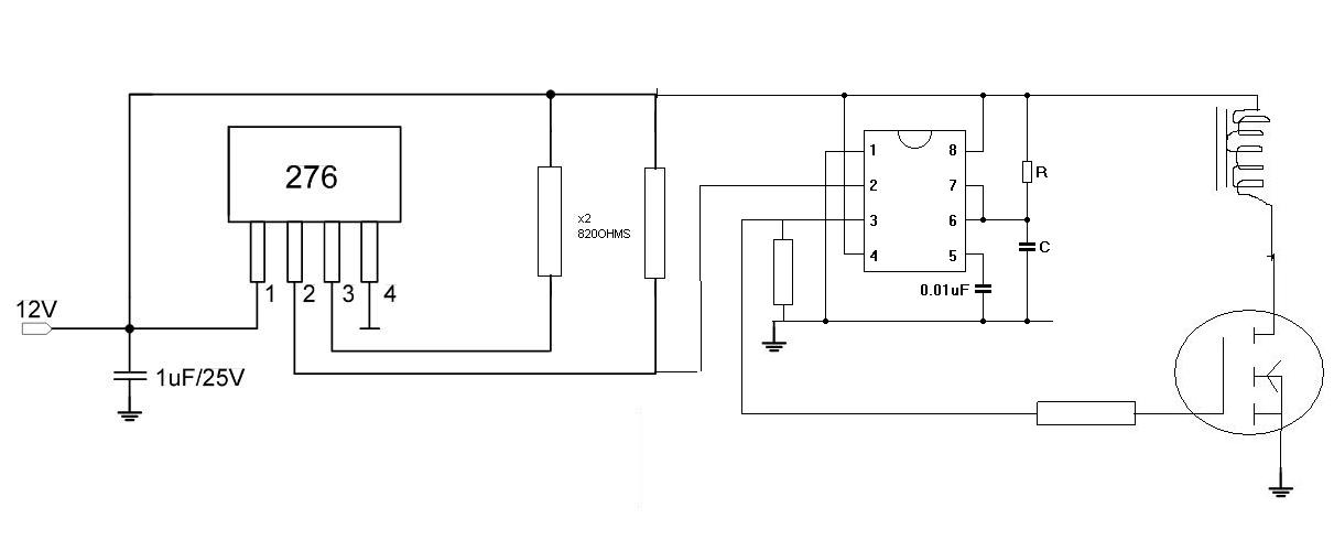

                      the monostable circuit is useless, the input pulse duration affects the output pulse duration, back to the drawing board
                        problem solved, mosfet isolation driver stage next.http://vid936.photobucket.com/albums...ps3cc1ee71.mp4
                          sucess, variable pulse width and timing, mosfet driven simply from optocoupler but not yet ready for high voltages, it produces the biggest spikes, and i cant dampen them enough with a battery to stop the neon protection on the mosfet from staying on, without the battery the neon is not yellow but bright blue / white.
                          the wheel spins a reasonable speed with a very small duty cycle at around 200ma including the switching and i only have a single coil winding out of 8 connected (140ft x 0.5mm)

                              I will post my final simple schematic so everyone can have a go, my first one was incomplete so dont bother with it.
