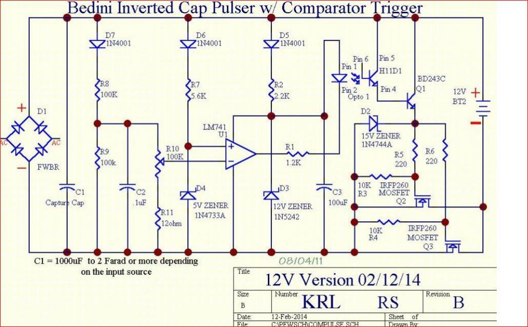

        hi rs,i am new to these forum and i want to replicate scheme you posted for 12v comparator,I'm not an electrician,could you please tell me what kinde of resistor(i mean watt)do you use ,and for zener diode too( Watt),and voltage for all 3 capacitor?iI would be very grateful...thenkscomparator.jpg
        • #49
          I use 1/2 watt resistors, I think the zener part numbers listed are 1/2watt, the capture cap should be 35 to 50V, and value sized to the input source. The other 2 caps should be 25V +

                      RS I would like to thank you again for your help on the circuit,i replaced that bd with tip120transistor and conect the colector to the +terminal before the diodes,and now the led is flasing properly and the caps are charged\disch corectly,and tr. stais cool.I also not used the1.2k res between pin 6 of the opamp because i tried with it and no diference,it has the 2.2k with the led already so no need for it.From Ron circuit i kept only the 2.2k and led on pin 1 of opto and power on led,and now its working very nice,and boiled the batt in 3minutes from 10v.... but i want to discharge the caps a bit longer, because they discarge very rapidly only 5v of 35v,so i want the ''on time'‘ to be longer..how do i do that?i use 3-4700mf,2-3300mf,2-2200mf 40v caps.
                      Cheers
                      Adys15 ,my BD243c is get very hot also within minute...you manage to solve this,can u explain more abt put collector to + terminal before diodes?if possible in details..
                      TIA

                            Sory for late reply,i had a lot of work and left the bedini stuff aside for a while.I changed my transistor that was trigering the mosfets to tip120 and staing cool now,i conected the colector just like in the latest schematic that RS posted.
                            NeonBlue84 i put another 10mf cap on pins 2,3 of the lm741 and slowed down the frq of the dump but the discharge cycle is still fast the caps charges to 28v and dumps at 22v....charging the batery but i think it could charge beter if the dump time was longer.
                            I observed something strange these days...i'm not sure if the meters are acurate but...i measured the input power of the solid state ssg which was 16v 0.3A,and the output of the caps is 28v 1.5A...the amps are there because i put a 21w auto bulb in series with the negative of the charging batt and it lights almost half brightness...so there is some amps there...how do you explain this?thanks...

                                adys15,
                                yup cap dumps AMPLIFY current. by discharging at a hi voltage into a low impedance load. you can see pulses above 100 amps on a cap dump if you can measure it, it is so fast hard to do. your meter is getting just a bit of it, depends upon how good your meter is.
