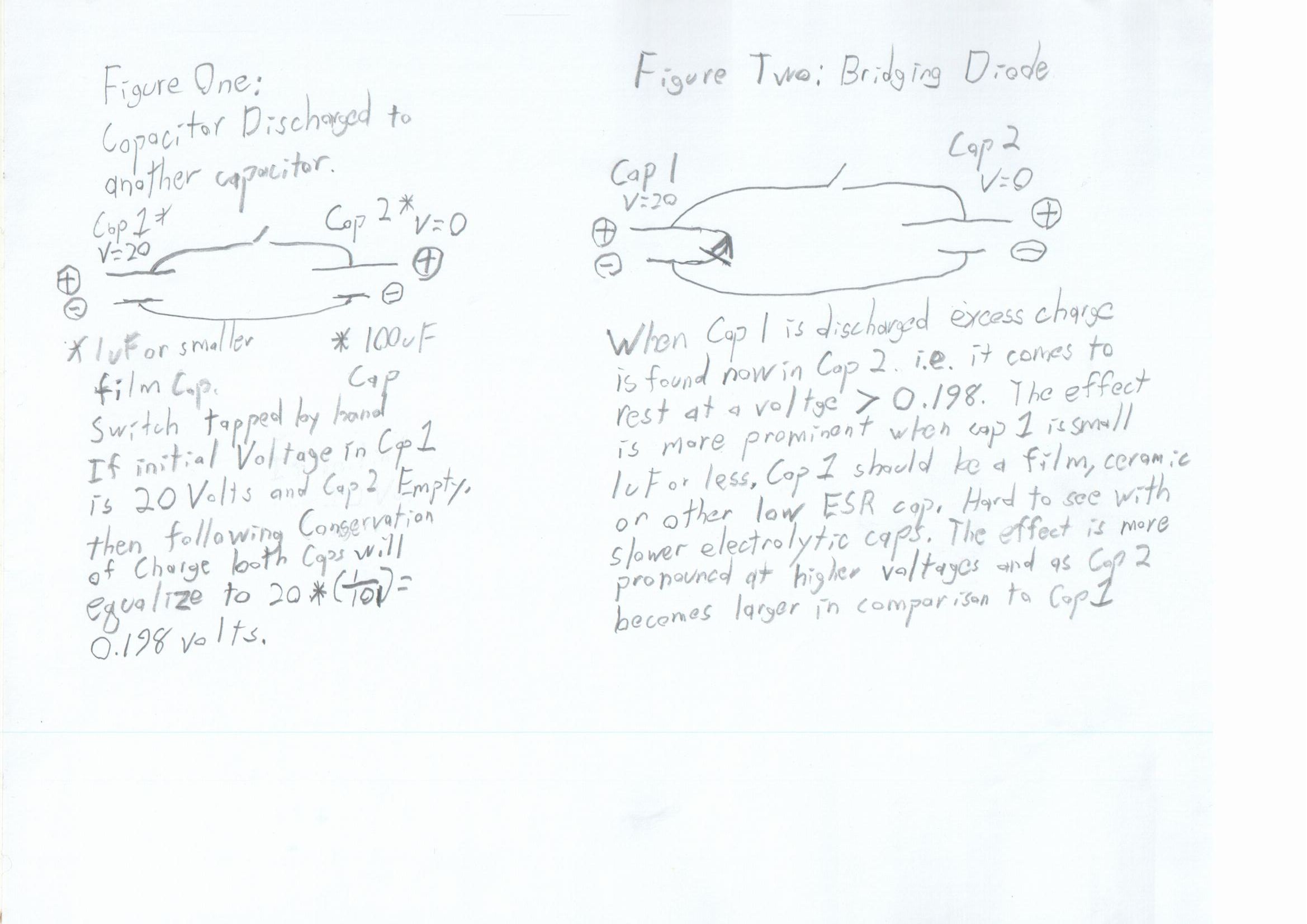

        I beg of you, kind sir; could you please sketch out the connections? Even if it isn't in formal schematic format, just draw boxes, label them, and run lines to represent your wires. I found it rather difficult to follow the "bouncing ball" in your 2nd video, but I'm left clueless in this 3rd video due to image resolution, or something. I will try to replicate what you post, make up a cleaner schematic for you, breadboard it, put it on my scope & share the waveforms (with your permission, of course).
        Yes, of course, great point Mike. I will hand draw the circuits that are tapped out by hand and either do the same or try the what is it "fritzing" program for the arduino circuits and also include the arduino code. It gets more complicated when we look at one wire stuff so very much worth doing. There is some high level weirdness with one wire rectification and things change in ways that are entirely unpredictable to me so worth at least trying to capture what is set-up. Just as one example, I kept seeing a residual 0.5 volts and was saying where is that coming from? Kept removing more and more components until all I had left was the inductor the diodes and the earth ground and it only went away once the earth ground was removed. So I would have to guess I am seeing the one wire version of an earth battery, one wire rectification of the telluric currents.

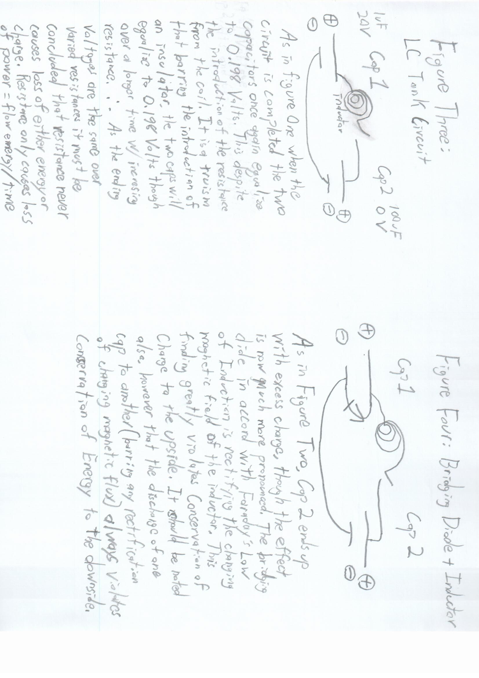

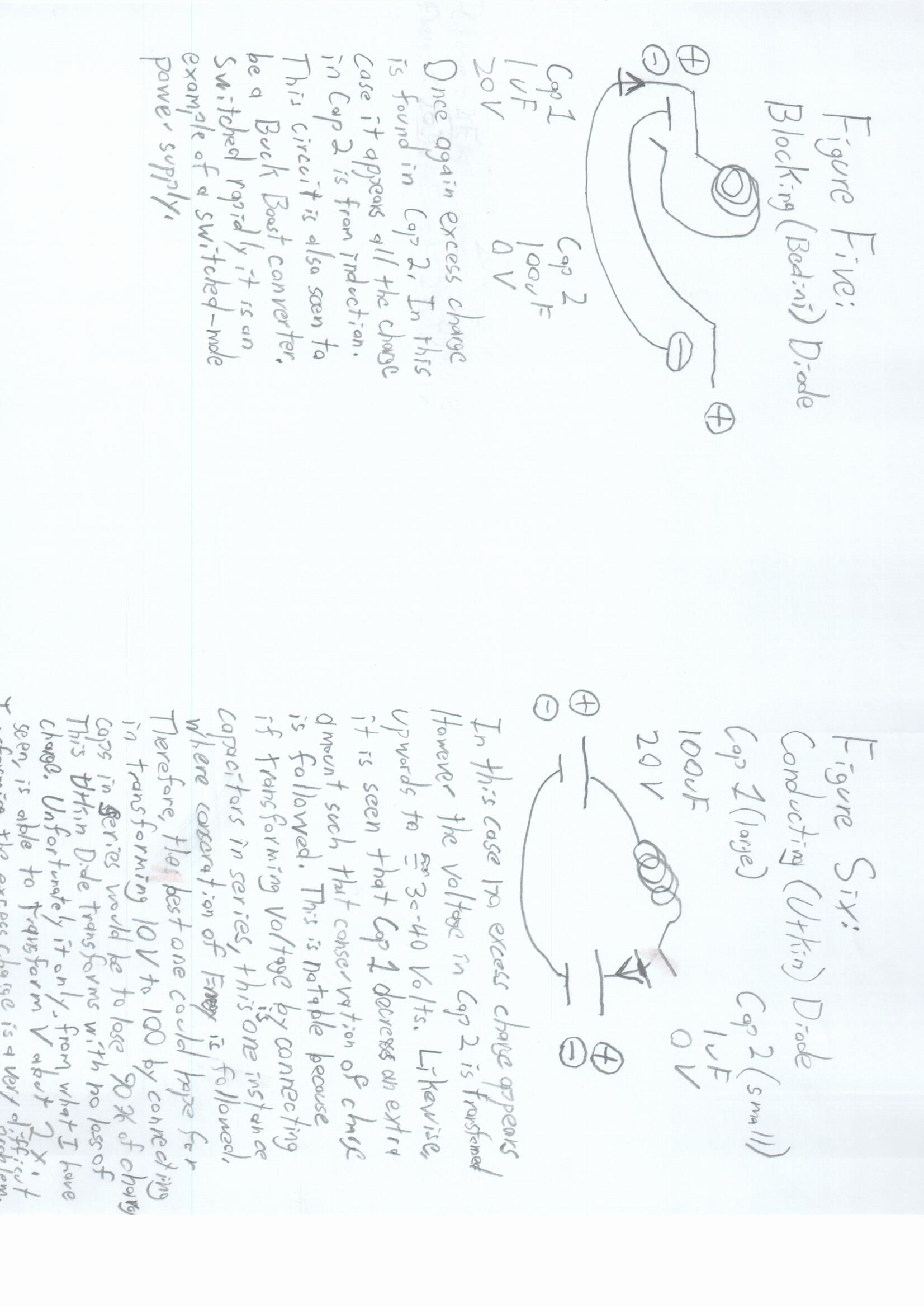

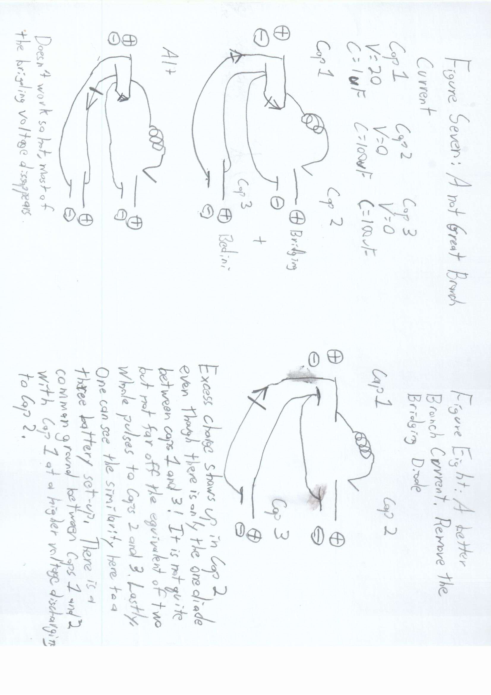

                Per Mikes comment here are a some hand-drawn circuits and notes. When we get to having a try at building a charger and/or various versions of a charger I'll use Fritizing to present something clean. Need to plow through the one-wire video, that will probably be some hand-drawn circuits as well, much of the time I was just tapping the earth ground around different places and saying oooh that's neat, how about that one. Don't want to get too deeply drawn into one-wire unless it proves necessary. Unpredictable, makes no sense, can't figure a way to conceptualize it, heard something about 1/4 wave ratios and a dark lord and the end of the world but please don't hurt me Gandalf not in any ways unnatural. Sorry, here are some diagrams, ideally I don't have any diodes oriented wrong, it is straightforward, the Bridging and Bedini Diodes are blocking diodes the Utkin is a conducting diode. Last image in next post

                          I will look over your diagrams and get back to that.
                          In reference to "recycling electrons" in your circuits, if you view things as taking a teaspoon full of water (electricity in this case) and dumping it into a bucket & then measuring 7 teaspoons worth of water, it is impossible within the laws of electricity as we were taught them. However, if you merely view the 2nd capacitor as a dipole, and the first capacitor "charging" or "stretching" the dipole, then my theory might have a chance.
                          You are effectively creating an LC Tank Circuit. Without the diode, you discharge the 1st cap through the inductor and the oscillations affect the whole circuit uniformly. As oscillatory swings go positive, the dipole charge on the 2nd capacitor increase. When the swings go negative, charge is diminished in the 2nd capacitor. When the oscillations peter out, the effective Coloumb charge from the first cap is dispersed throughout the whole circuit; equilibrium has been found. Measuring the charges work out mathematically.
                          By adding the diode, positive oscillations charge the dipole of the 2nd cap. When the LC oscillations between the 1st cap and the inductor go negative, the diode prevents the depletion from the 2nd cap. When the oscillations go positive again, this second round of positive charge potential adds to the dipole effect of the 2nd capacitor. Here is where the teaspoon & bucket analogy no longer works.
                          You have noted that as the charge potential of the 2nd cap builds higher and higher, the effect diminishes. This is because the source potential from the 1st cap doesn't have sufficient delta to have much of an effect on the 2nd cap. Your LC Tank Circuit with the added diode merely acts as a charge pump to polarize the dipole in the 2nd cap. Effectively, you could harness this energy usefully. The high gains could add to the efficiency of a larger circuit with a load so long as the voltage difference between cap1 and cap2 is sufficiently large.
                          A suggestion might be Bedini's "2 batteries on one side and one on the other" design. Charge a parallel array of larger (2nd) capacitors to a low voltage from a primary LC/diode oscillation circuit; your experimental circuit. When you have, say 10% of the target voltage on the array, stack them in series to deliver a full voltage charge downstream (to the load).

                            I thought of another way of explaining my theory. Don't think about filling a bucket with teaspoons. Instead, think of it as stretching a rubber band, or maybe winding a clock spring. With every positive cycle in the LC Tank oscillations, the rubber stretches a bit more. Or you could say with every positive swing of the LC Tank oscillations the clock spring gets wound a bit tighter.
                            With the diode, every time the LC Tank oscillations go positive where the positive swing voltage potential > (2nd capacitor voltage + the diode drop), the 2nd cap gets "polarized" a bit more. The amount of polarization = the voltage/coloumbs of energy contained within that swing cycle (- diode forward voltage).
                            You only fail when you quit!
