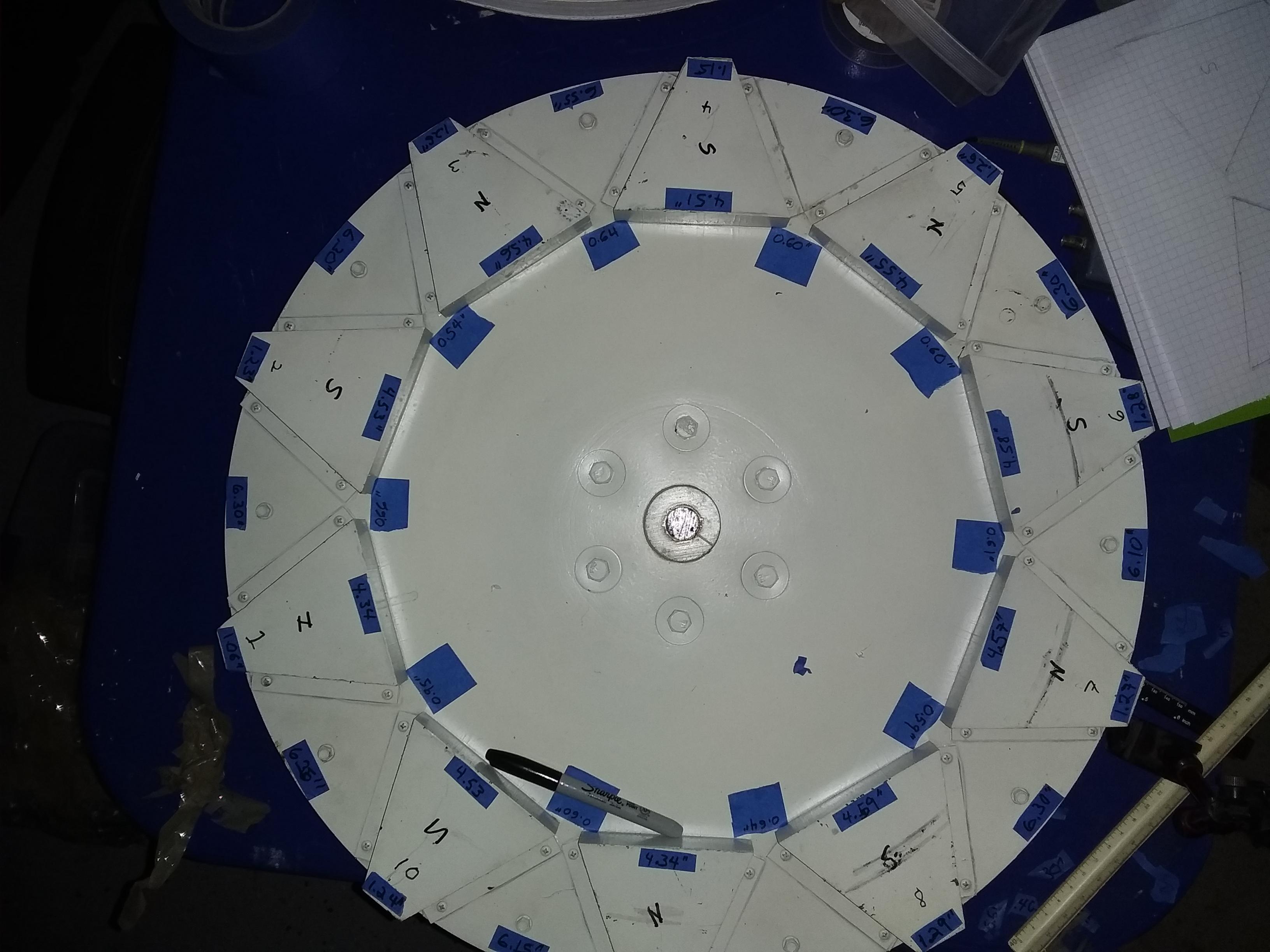

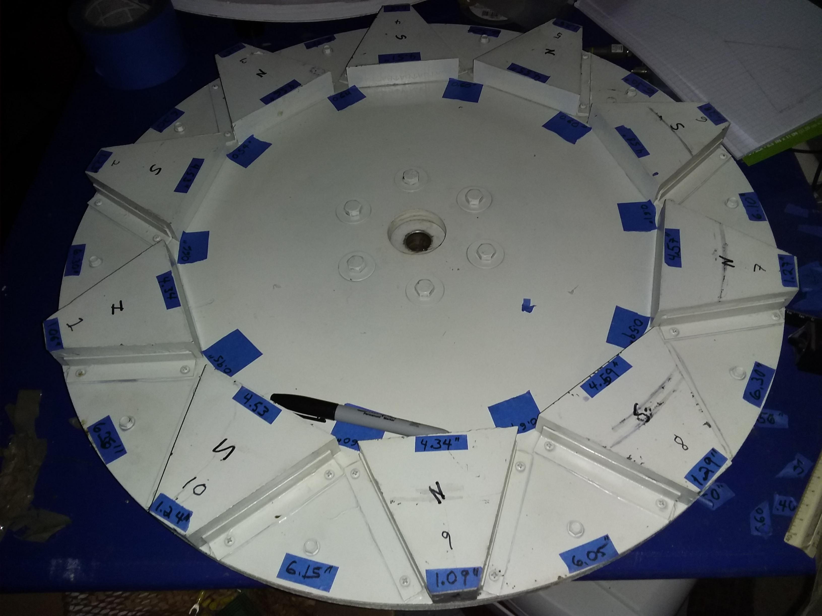

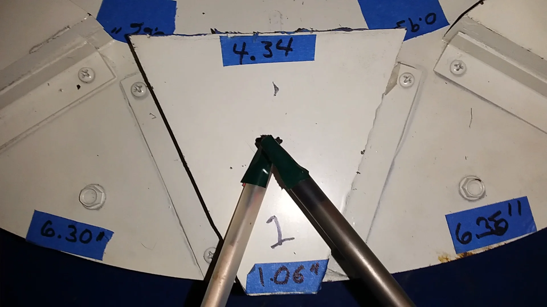

    Hub Motor pics

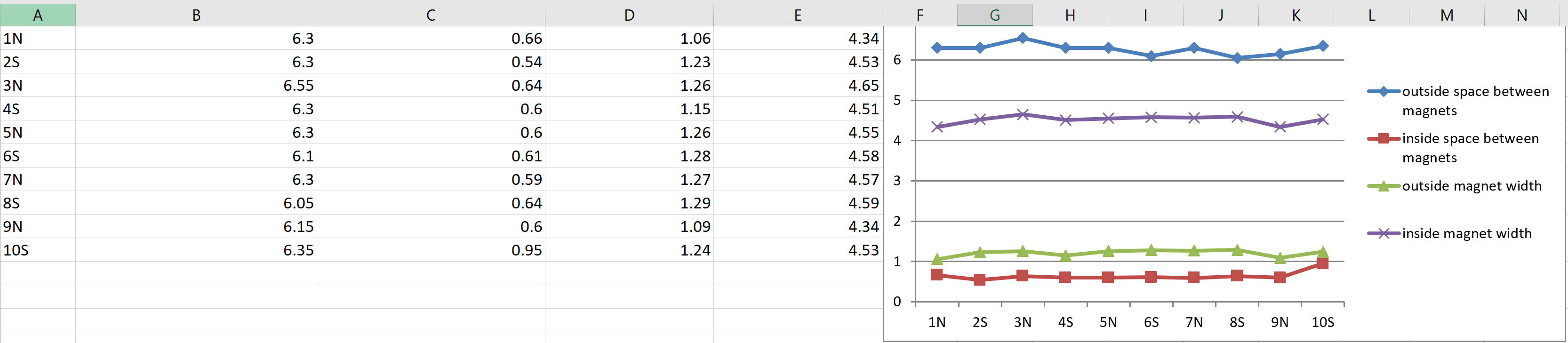

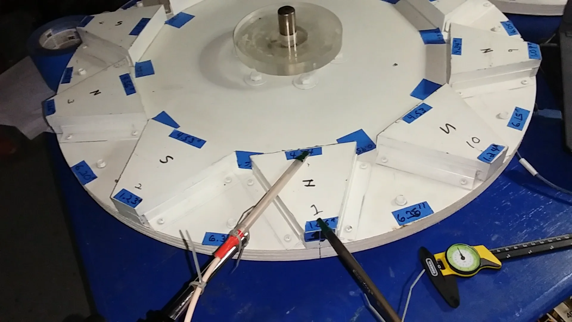

    here are pics of the Hub Motor with my measurements of the magnets & space between magnets on blue tape

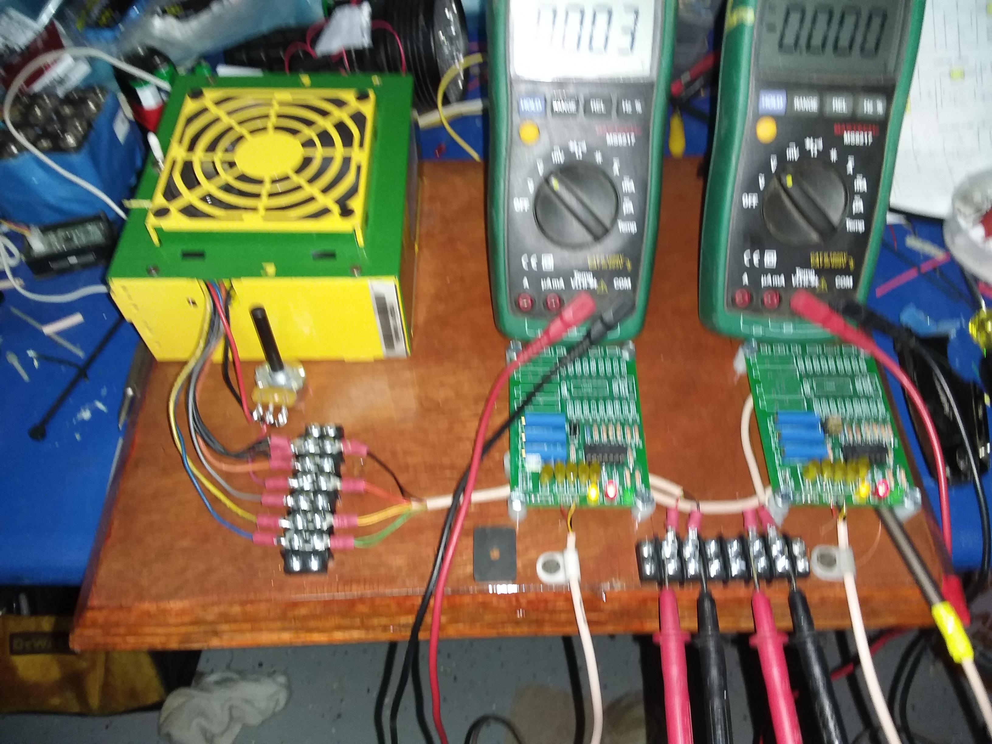

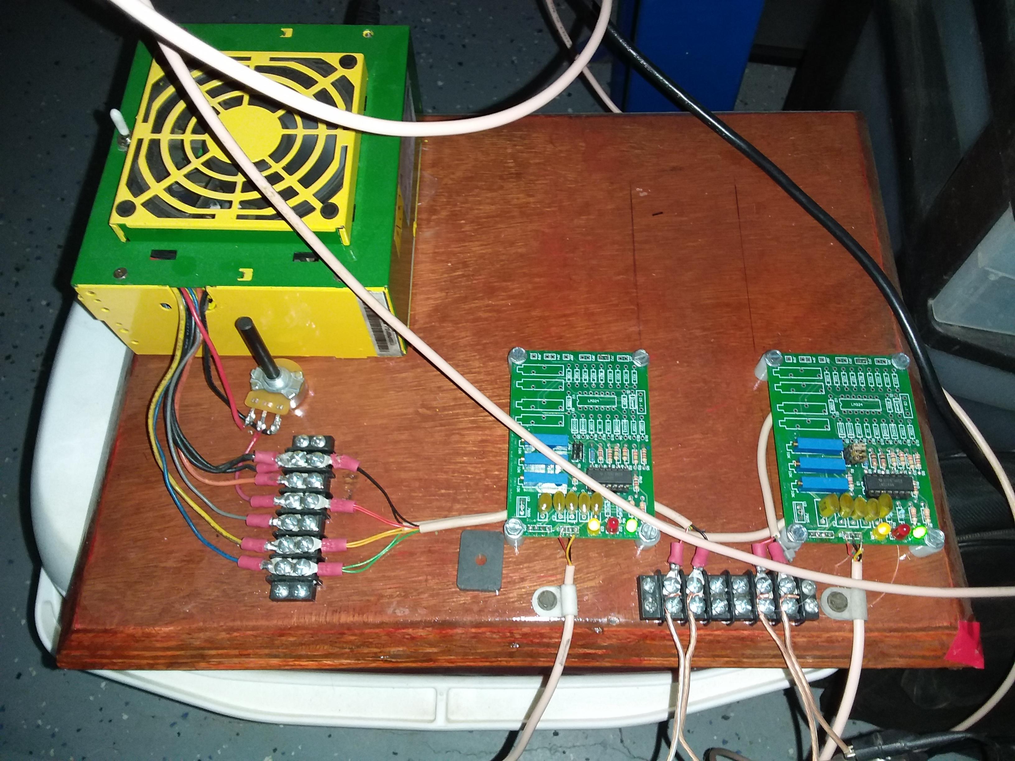

      For this series of experiments on the Pie Shaped magnets on the FW Hub Motor I used the Linear Hall Effect magnetic field sensors A1326LUA-T A1324LUA-T.
      The A1324/25/26 feature factory programmed sensitivities of 5.0 mV/G, 3.125 mV/G, and 2.5 mV/G, respectively.
      https://www.digikey.com/product-deta...433-ND/2728148
      https://www.digikey.com/products/en?...0A1324LUA-T%20

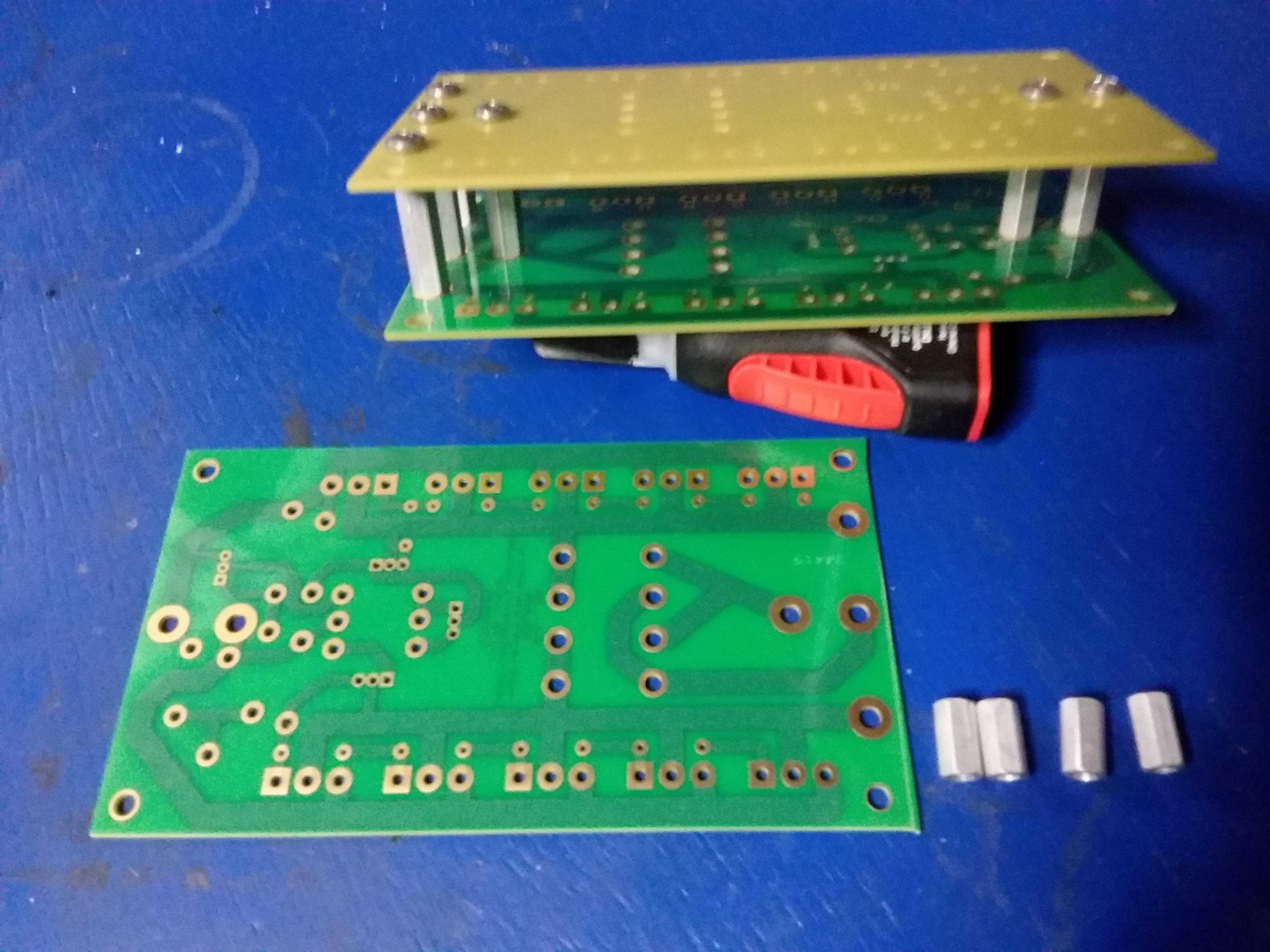

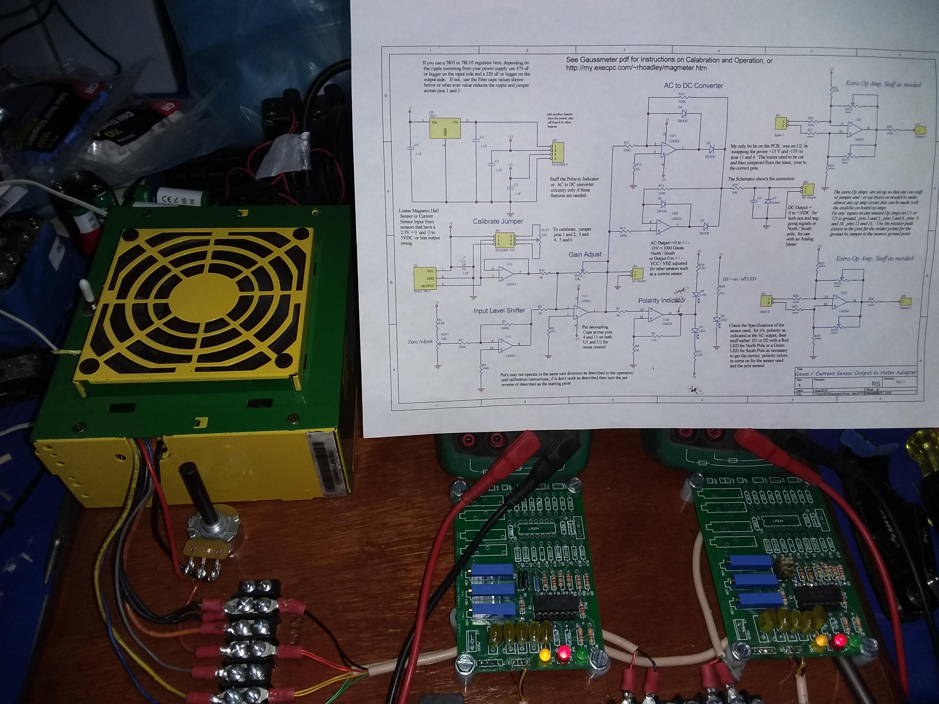

      The Hall Sensors are used with a OpAmp circuit PCB that I designed about 15 years ago based on this web site:http://www.coolmagnetman.com/magmetr1.htm
      This OpAmp circuit scales the Linear Hall Voltage output so that it reads +/- 8.80V = 880 N/S Gauss (A1326LUA-T), or +/- 4.40V = 440 N/S Gauss (A1324LUA-T)on a meter or Oscope
      In the Pic's/Videos the clear Pin sensor wand is the A1326LUA-T, and the grey Pin sensor wand is the A1324LUA-T
      sorry for the fuzzy pic taken during calibration

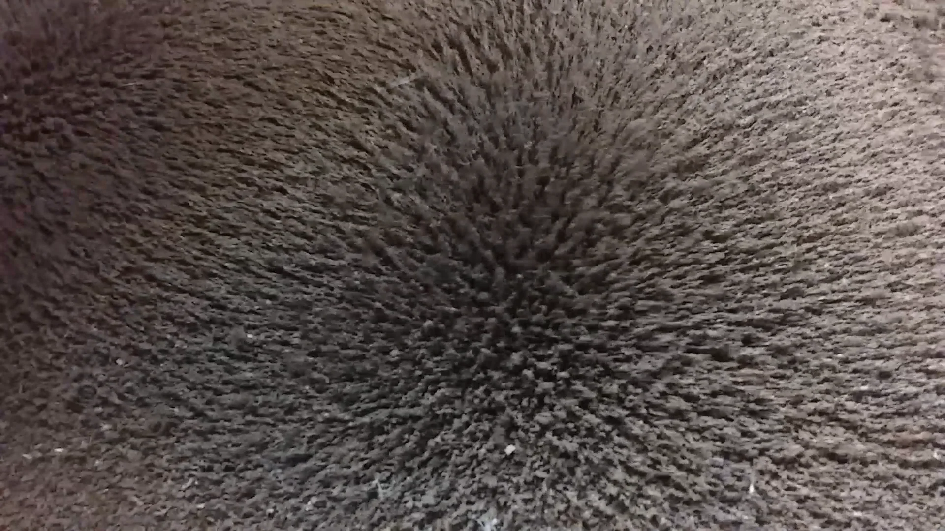

                This video shows the Hub Motor pie shaped magnet field using brake drum/rotor filings that were rusted, and used for various experiments over the last few years.
                https://vimeo.com/375034572
                Several years ago, I Put a SG/cap pulser coil into a plastic tub w/ lid full of these filings, and then running the SG was a very interesting experiment. Changed the Oscope wave forms and operation in ways i did not expect.

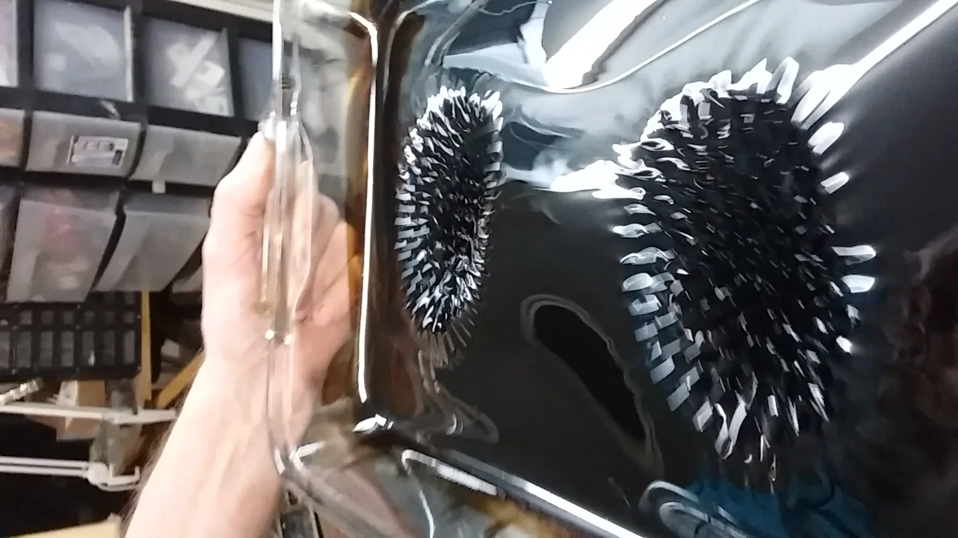

                  This video shows the Hub Motor pie shaped magnets field shape using Ferro Fluid
                  https://vimeo.com/375038141

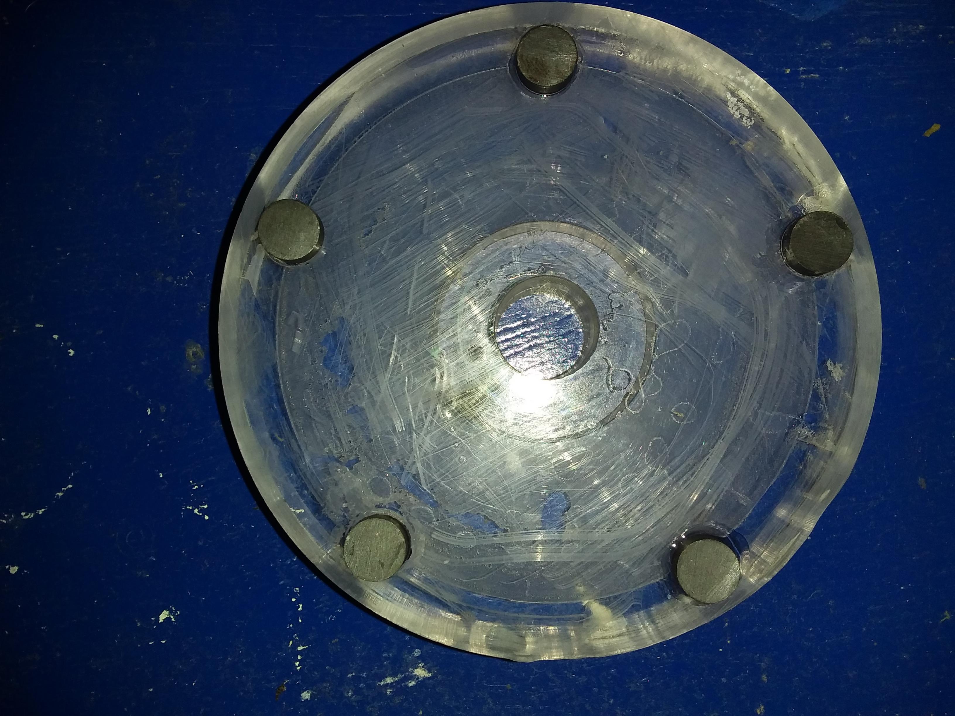

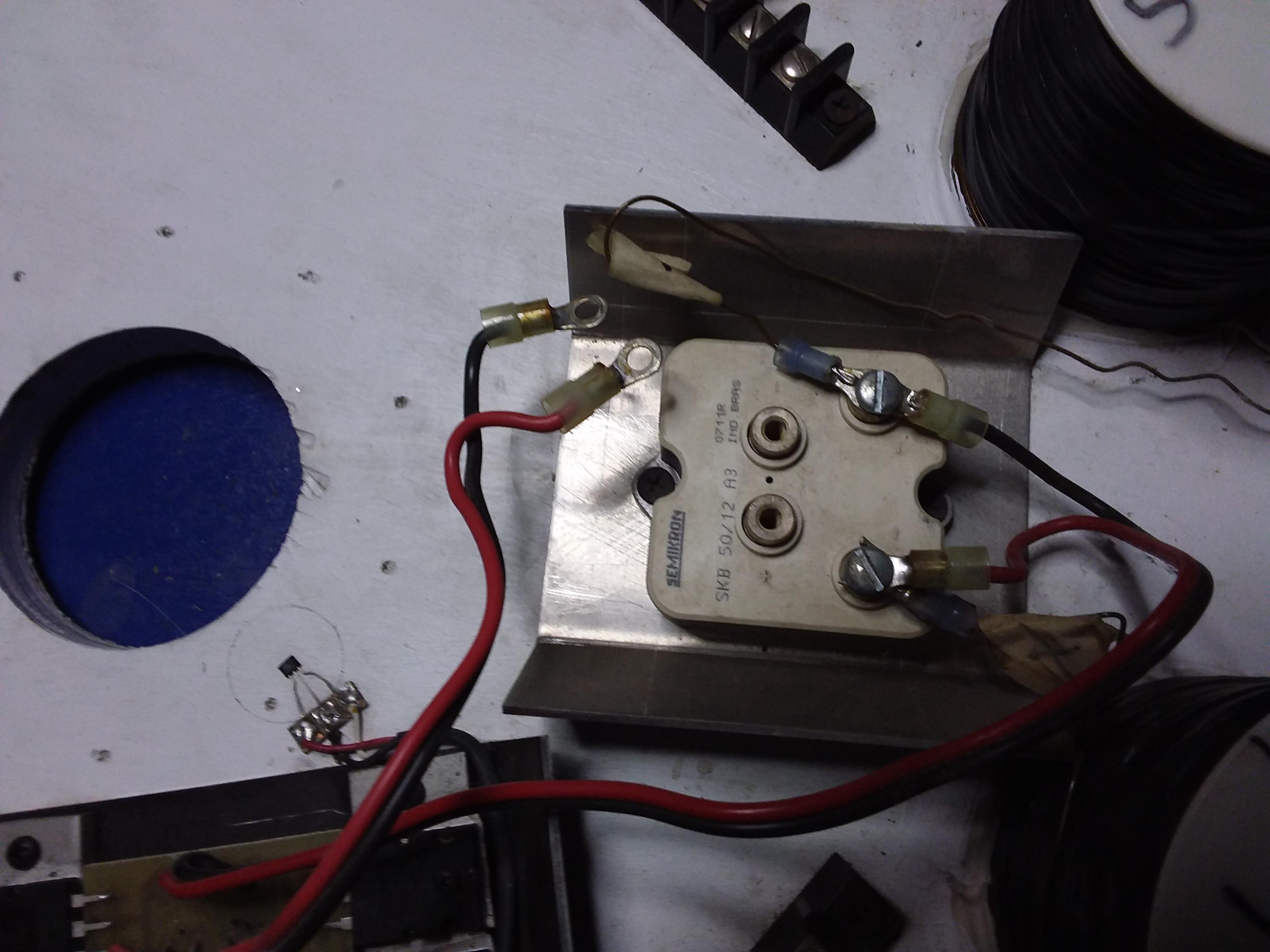

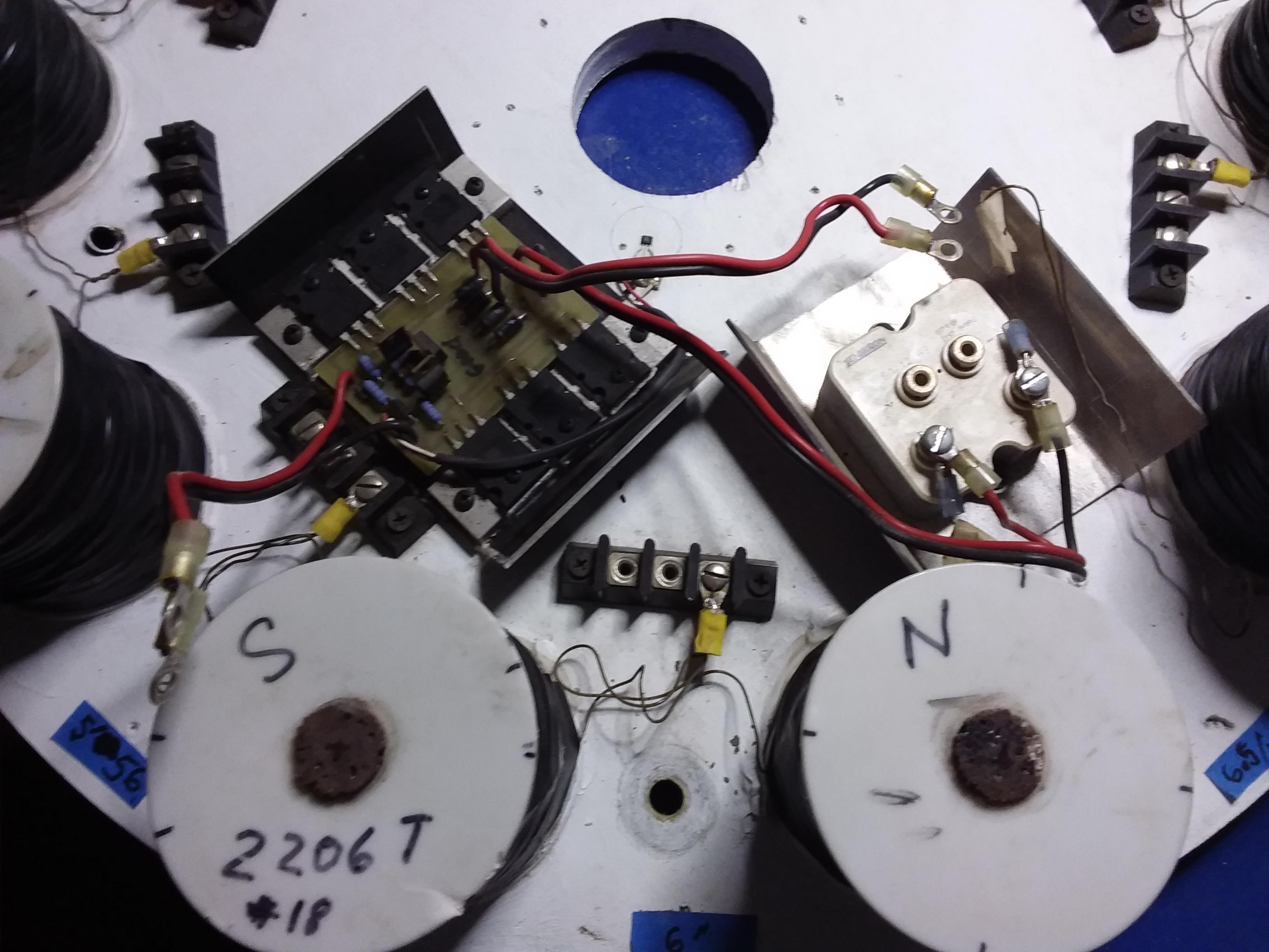

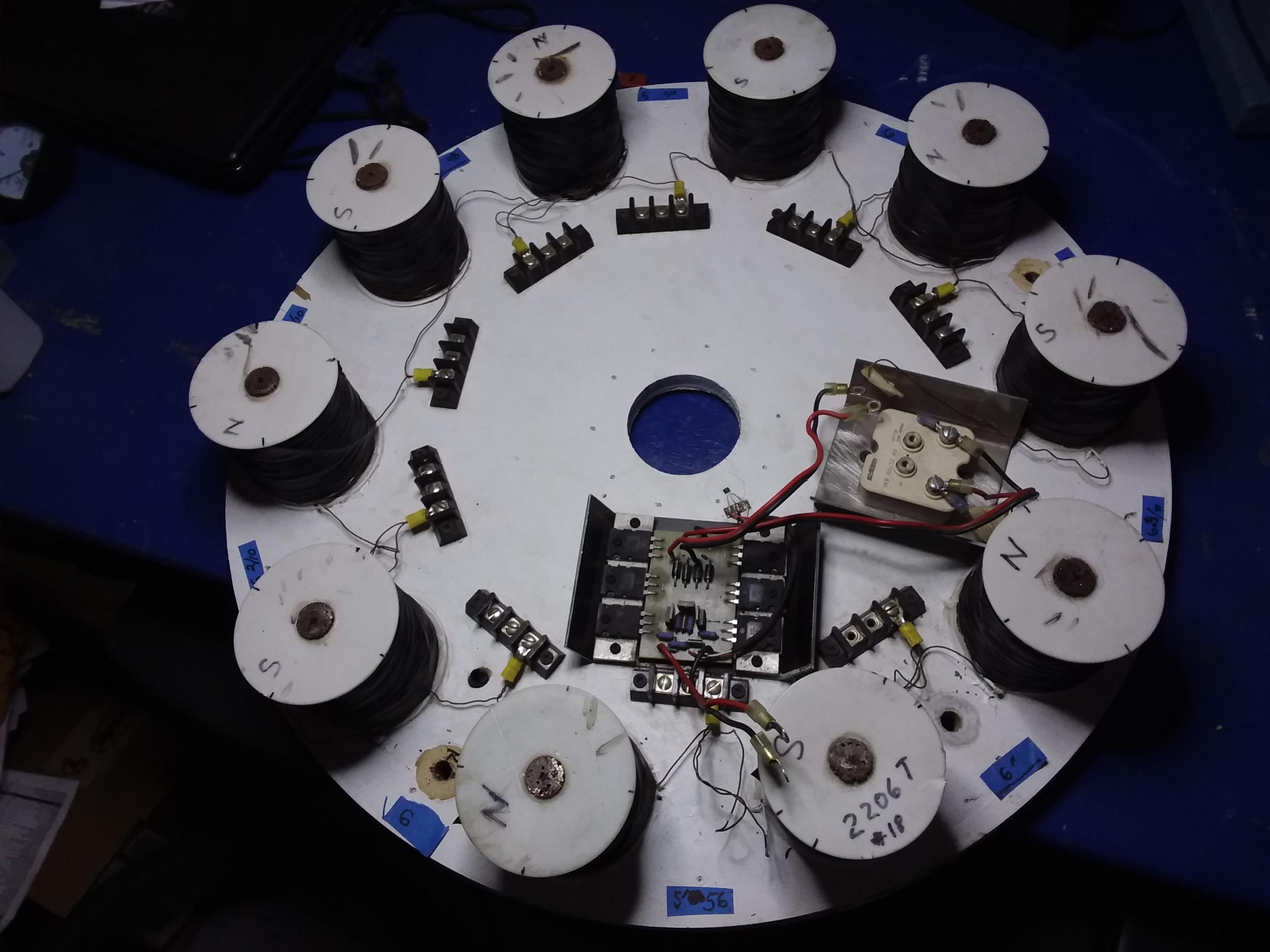

                    Here are pics of the Ferris Wheel Hub Motor Timing wheel. When I received the FW, the 5, 1/2" magnets on the timing wheel were missing. You could clearly see where they had been glued down. So I replaced the 5, 1/2" magnets on the Timing wheel with new ones as talked about in the FW EFV-23-2010-Tech Review video.
                      I had planed to take inductance and resistance measurements of the FW Hub Motor coil's this weekend to post along with these pic's...
                      My 20+ year old LCR meter was dead in the water when I unpacked it from the box it was moved in... So I had to buy a new one, and will post the measurements next weekend.

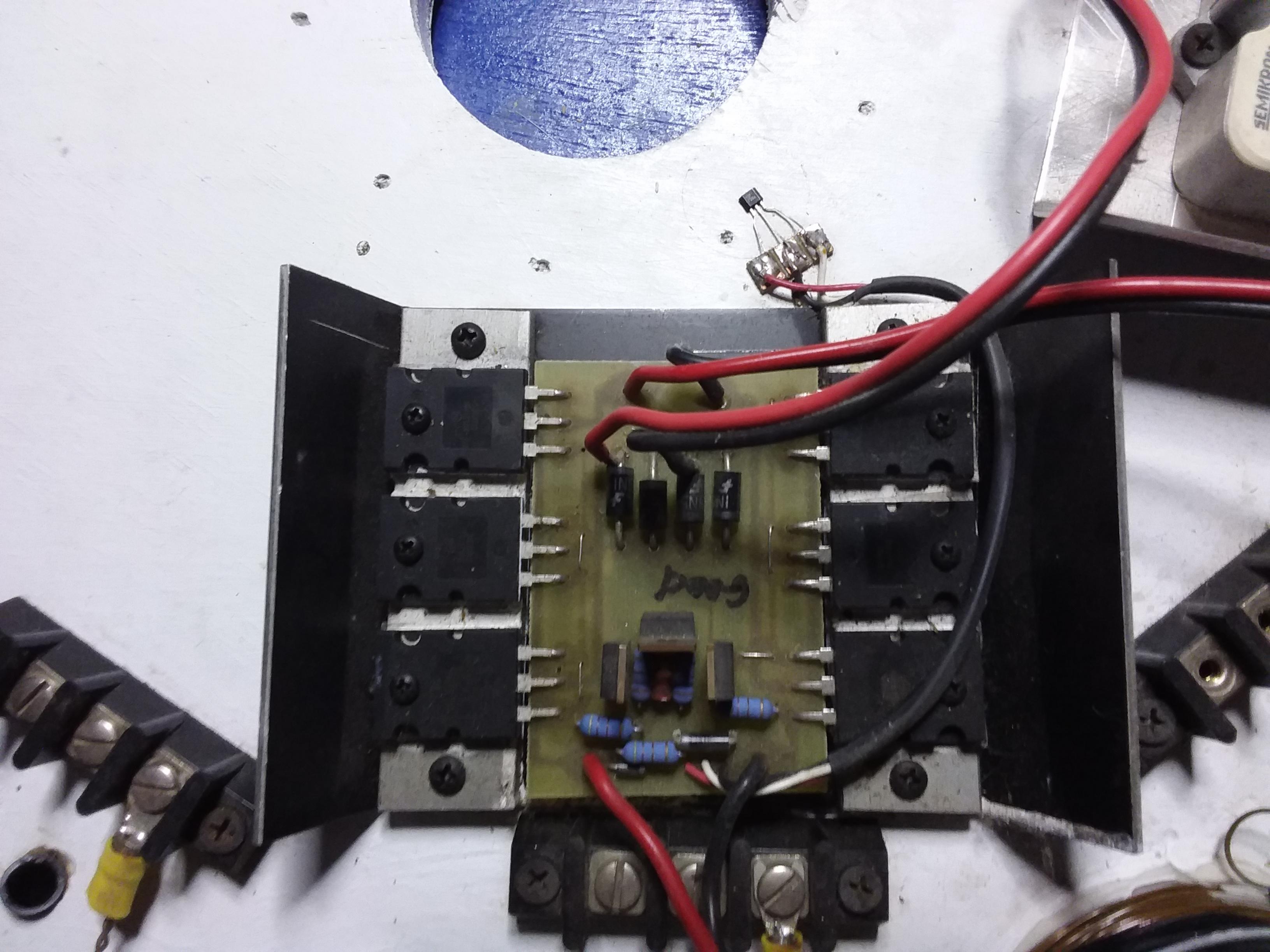

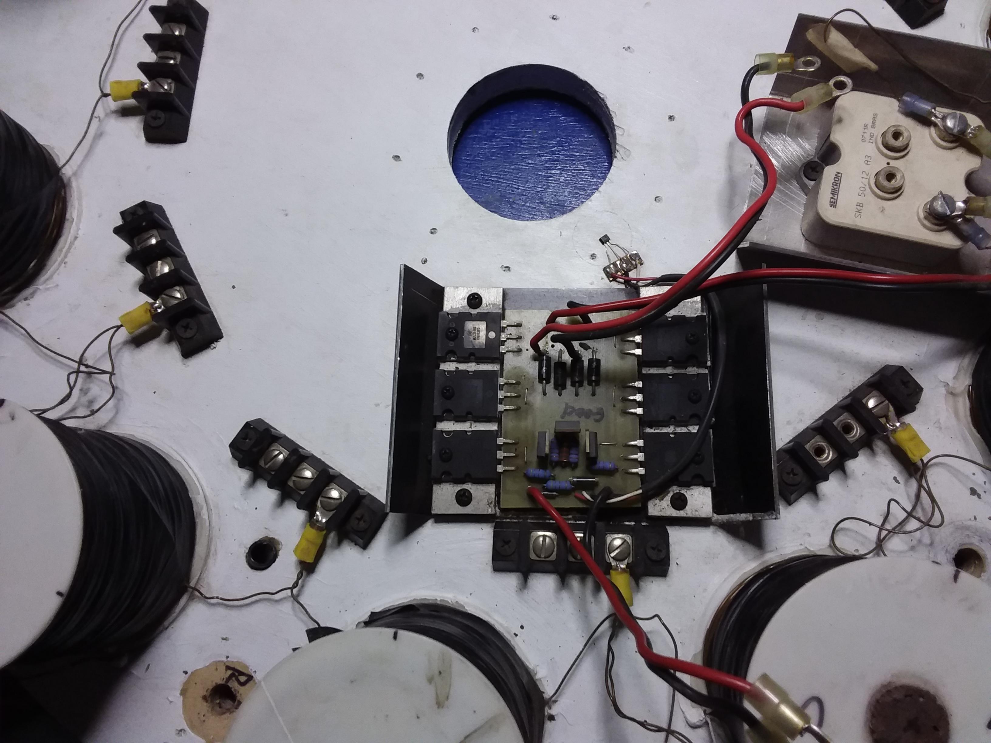

                        following this closely....amazing stuff!!! What kind of circuit is this? i remember John saying "it's a highly modified Bedini Cole Switch" any chance on reverse engineering a schematic?
                          I've already reverse engineered the circuit, and have made PCB's of my version of the circuit
                            nice! thats so cool! is it indeed a modified bedini cole? any chance of sharing the schematic?
                              It is a modified B/C bipolar circuit. The Hub motor has 3 sets of bipolar transistors and the main wheel circuit has 5 sets of bipolar transistors.... I will post the circuit schematic at some point soon, I dont have it on the tablet.... I have sold several of these PCB's, so it is out there...
