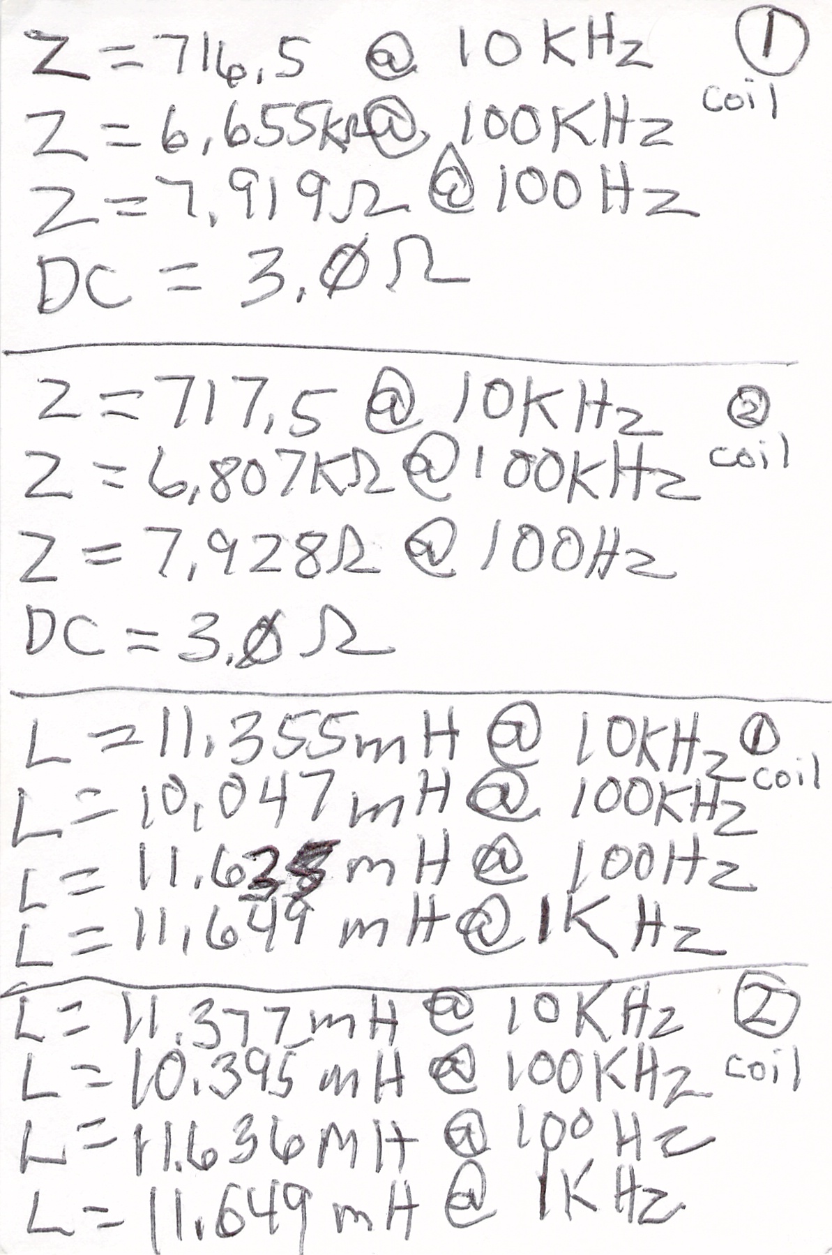

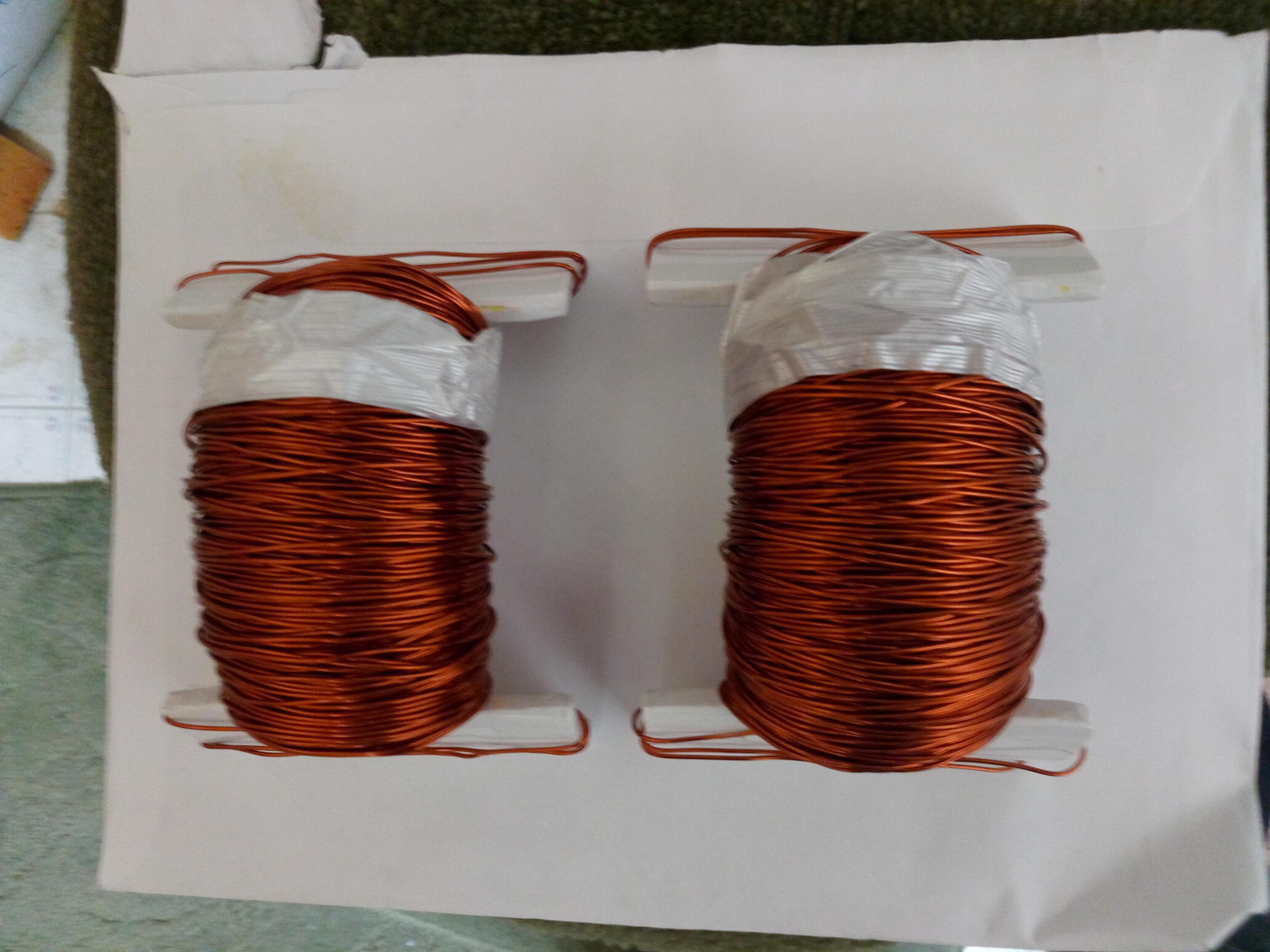

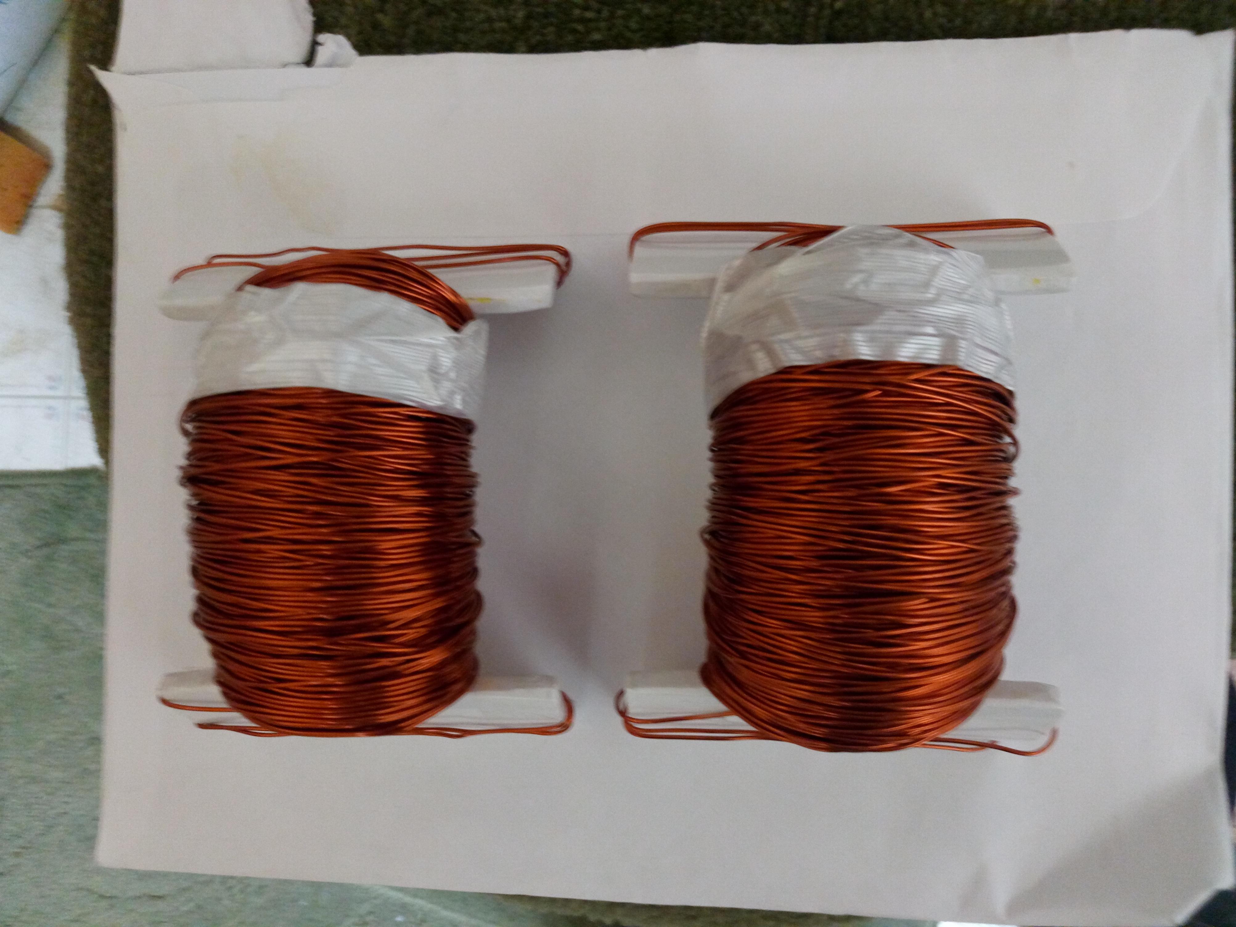

            The above pictures are coils I wound for my ZFM and the measurements I took from them. The other picture is the two rotors I had built of which
            one of them still has round N52 magnets on it but they were 1/2 inch thick. The other rotor was modified later on and 1 7/8 inch by 1 inch by 1/2 inch N52
            block magnets were added. I hope your build goes well because the more people doing these experiments the more data we will have as to what works
            best.
            Good Luck and have Fun with this ZFM build.
            -- James

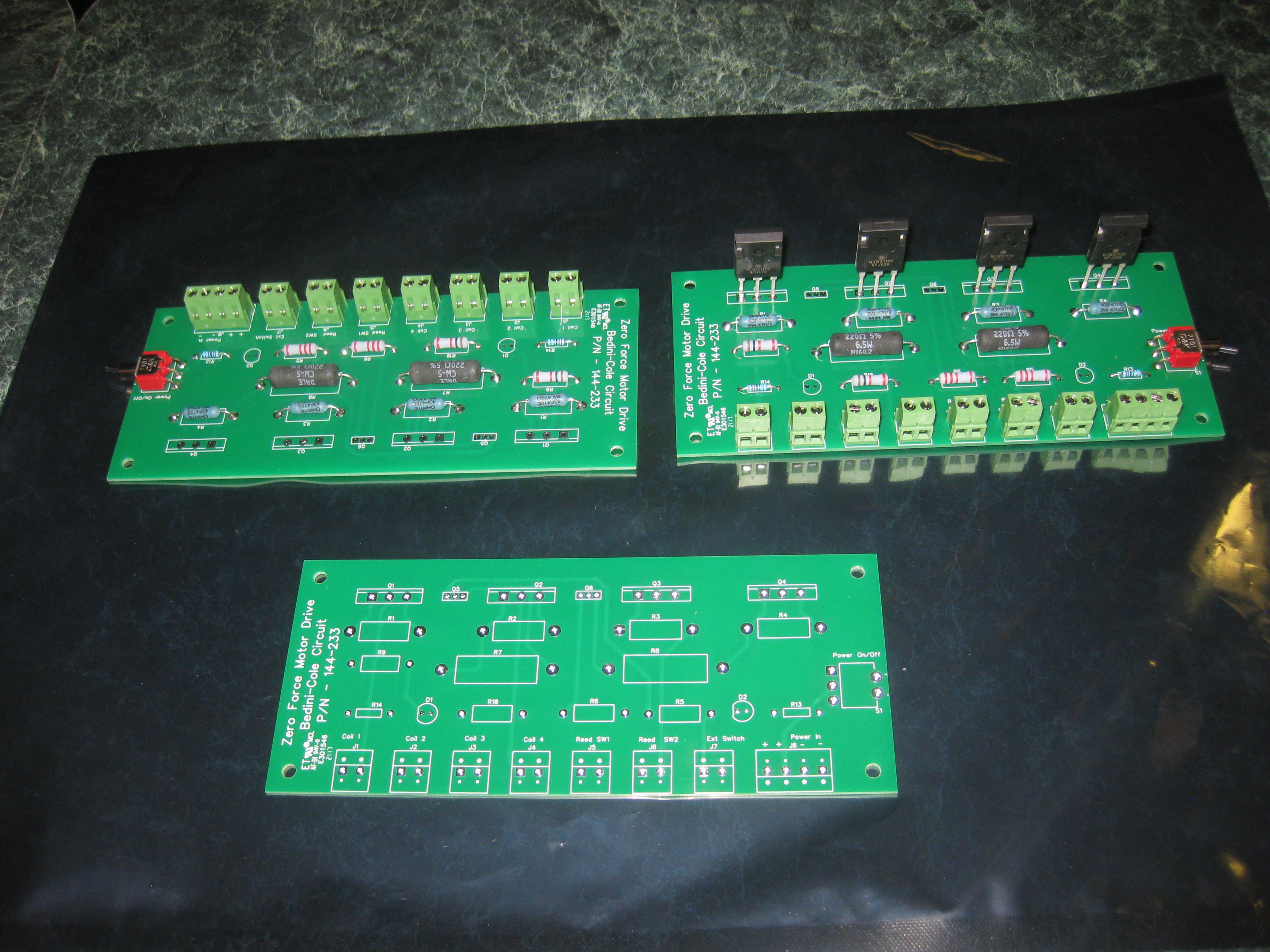

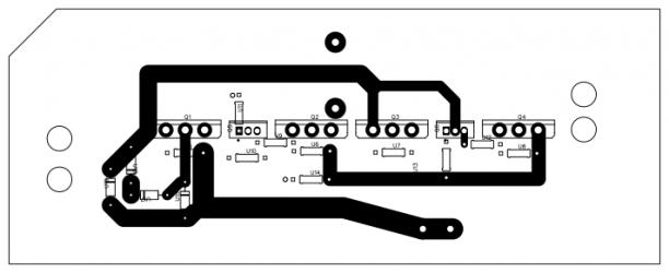

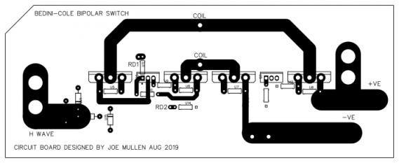

              Wow! Thanks James! Really cool to see the coil impedance measurements. Would you happen to have a pic of the Bedini-Cole Switch PCB you designed up for Yaro? Attached is the design I'm working on. Wondering if having a double layer pcb will have a negative effect on anything...

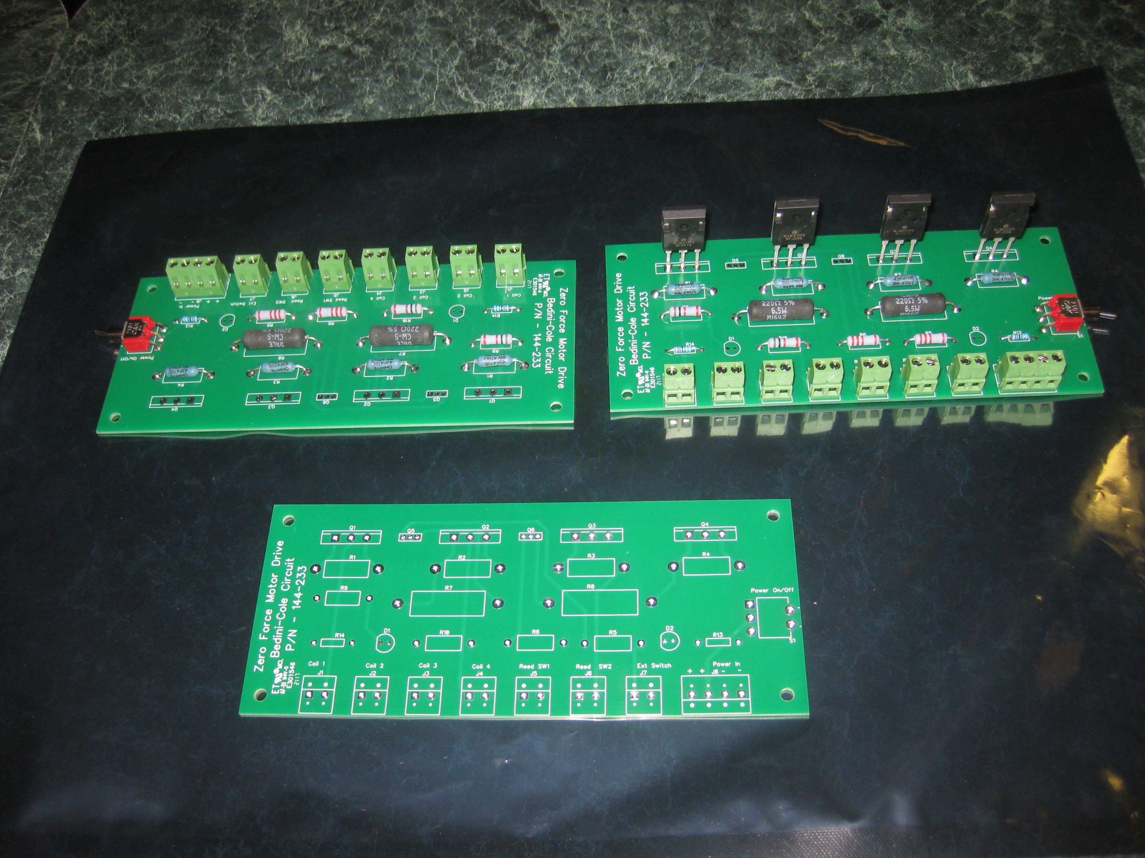

                Hi Joster --
                See the attached picture of the PCB board.
                -- James
                • #83
                  This is great thanks so much! I have a few questions:
                  1. What are J3 and J4 for?
                  2. What are D1 and D2 for?
                  3. My pcb design is 2 layer. Should I try and do it all on one layer as you have it here?
                  4. Trace width? should the traces not be wider? at least for the coil connections to facilitate a low impedance path to extract the radiant energy? You likely know better than I as I haven't done much pcb design so I'm just confirming.
                  Thanks again,
                  Joster
                  • #84
                    Thanks again,
                    Joster
                    Hi Joster --
                    Sorry for the delay in me answering your questions but I only check this forum once a week now
                    or just on the weekends. It is good to ask questions here due to we are also teaching others and
                    hopefully others will take an interest and build there own ZFM also. I myself started out using a
                    cheap PCB design software package called DipTrace but I now use Altium Designer 19.
                    "1. What are J3 and J4 for?"
                    On the original design there were 4 coils. So J1 through J4 are for a 4 coil ZFM.
                    I myself only used two coils and put jumper wires on the ones I did not use since
                    all 4 coils were connected in series with each other. So for a two coil ZFM design
                    you would use J1 for coil 1, J2 would have a Jumper wire, J3 would have a Jumper
                    wire, and J4 would be for coil 2.
                    J1 through J4 were for coil inputs.
                    J5 and J6 were for Timing Reed switch inputs.
                    J7 was for if you wanted to relocate the power On / Off switch somewhere away from the PCB.
                    J8 was the external Power input to the PCA.
                    "2. What are D1 and D2 for?"
                    I had told you that in the pictures I sent some of the parts were not soldered to the PCB
                    yet. D1 and D2 are important to trouble shooting the design. They are LED's. Before you
                    even apply power to the ZFM you can see these LED's light up just by spinning the rotor
                    by hand. When they light up without power applied it tells you the coils are wired to the
                    PCB correctly and the reed switches are wired up correctly and not broken. They are also
                    an indicator if a transistor happens to go bad you can tell which 2 of the 4 are not working.
                    The LED's are help in adjusting the timing on the ZFM. If the timing is off you can see it in
                    how bright the LED's are.
                    "3. My pcb design is 2 layer. Should I try and do it all on one layer as you have it here?"
                    My PCB is a 2 layer also. You should use your 2 layer PCB. It makes soldering much easier.
                    What you would do is, try to get every hole that would go to the bottom layer to have a part
                    pin going through that hole.
                    "4. Trace width? should the traces not be wider?
                    Depending on how big your PCB is and the way the parts are laid out on it I made my traces
                    as wide as the connector pins and part pins they would attach to and in between power busses
                    were all made as thick as possible without causing shorts.
                    "5. at least for the coil connections to facilitate a low impedance path to extract the radiant energy?"
                    For my ZFM design the coils were wound with 18 gauge wire and I used 450 feet for each side to
                    get the coil resistance to be around 3 ohms. This made a 6 ohm coil when put in series. The
                    transistors being used are used to pulsing current through the coils and since they are Audio
                    Transistors they are used to driving speakers from 4 to 8 ohms. The little bit of impedance on the
                    PCB will not have any effect on the whole circuit operation.
                    I am not sure if you saw the below video I made in front of my townhome this summer but the
                    link is below.
                    https://www.youtube.com/watch?v=-sDcE_xCZS4
                    -- James

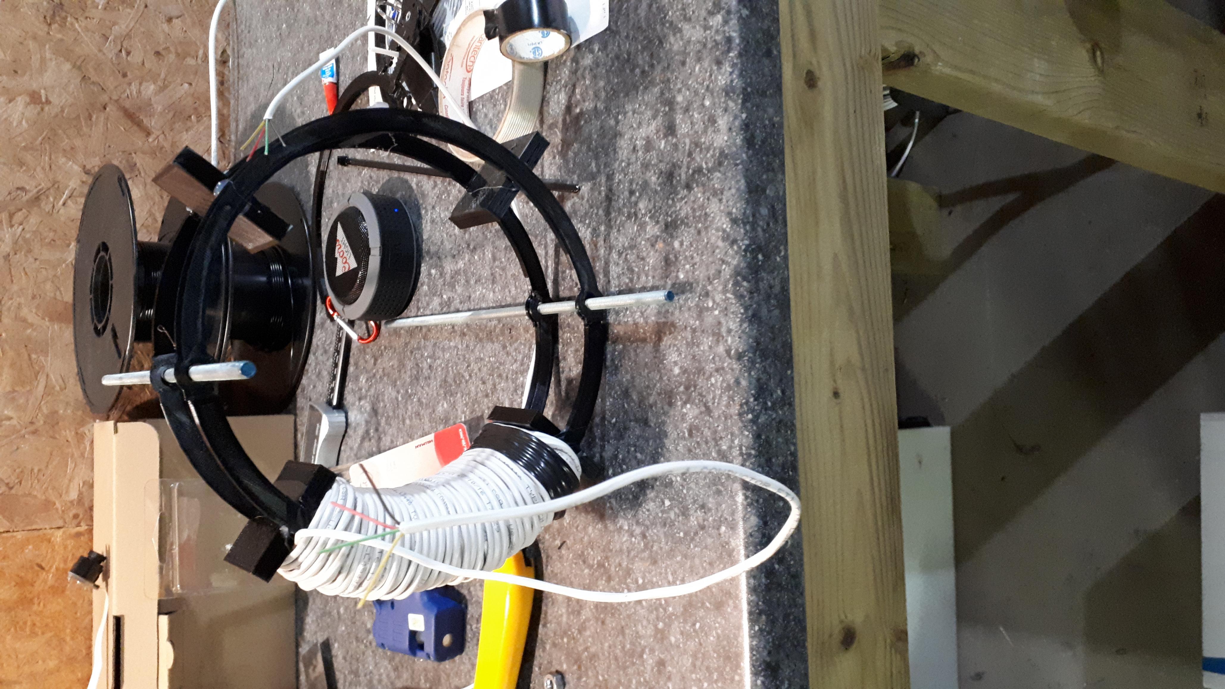

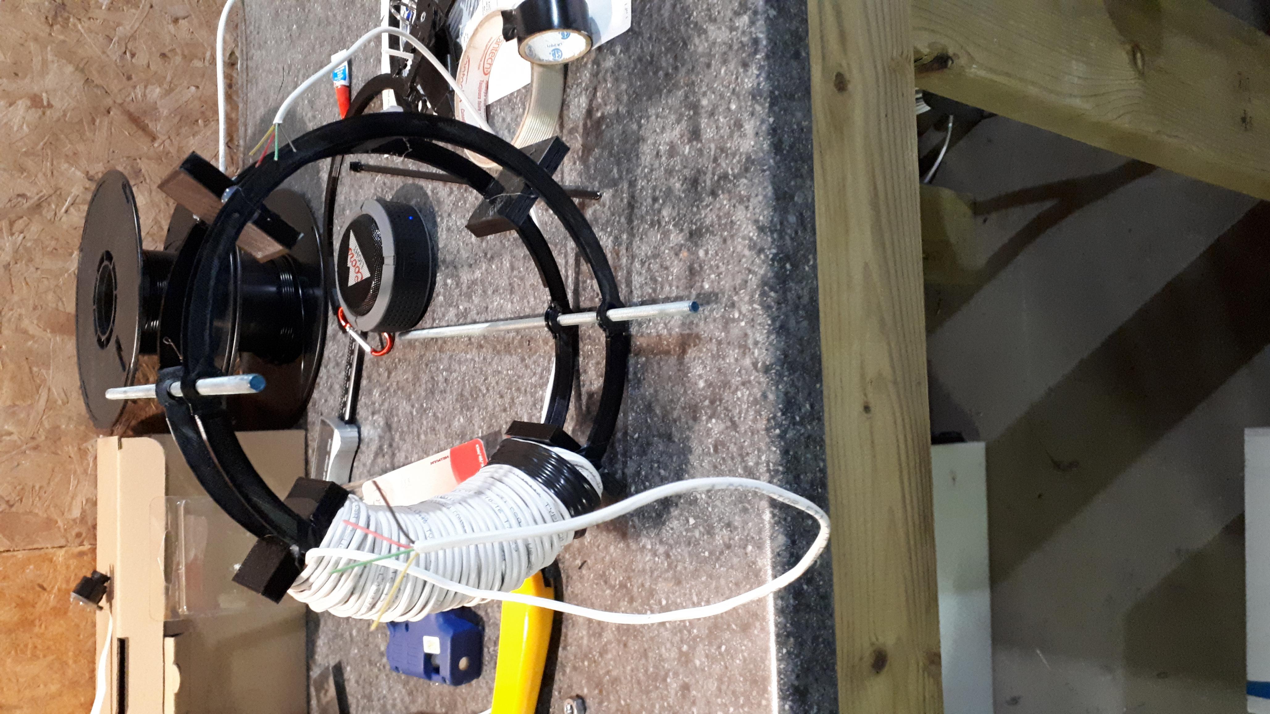

                                All sounds great! check this out....
                                Hi Joster --
                                That is a very nice looking setup you are working on. Tell me how you are going to connect the four wire? Series??? Parallel??? or Combo of
                                both series and parallel?
                                -- James
