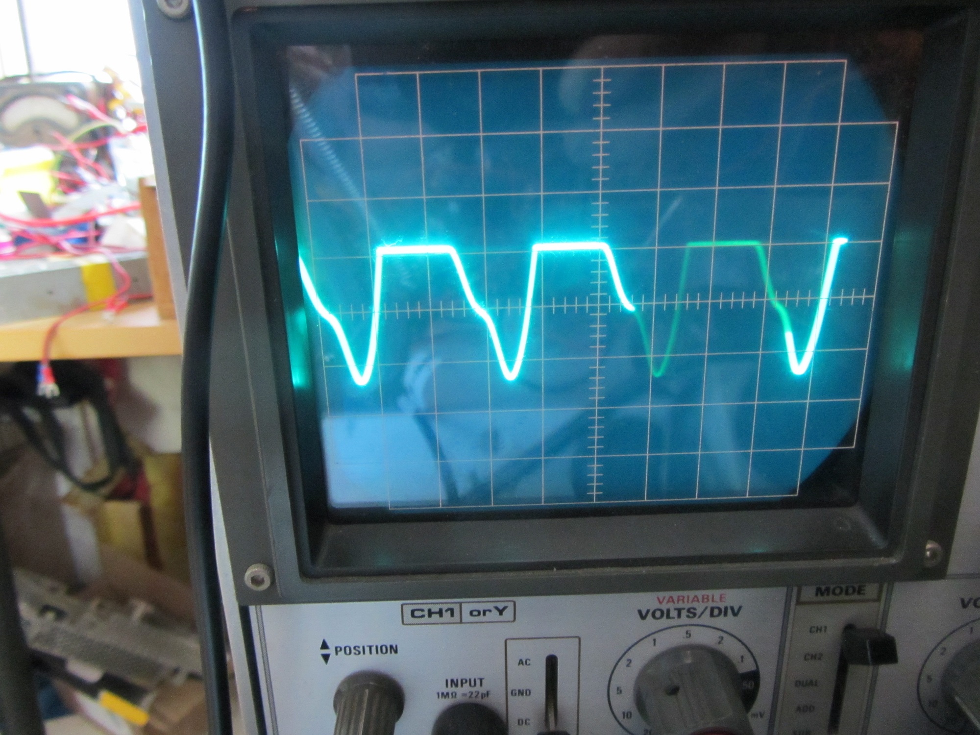

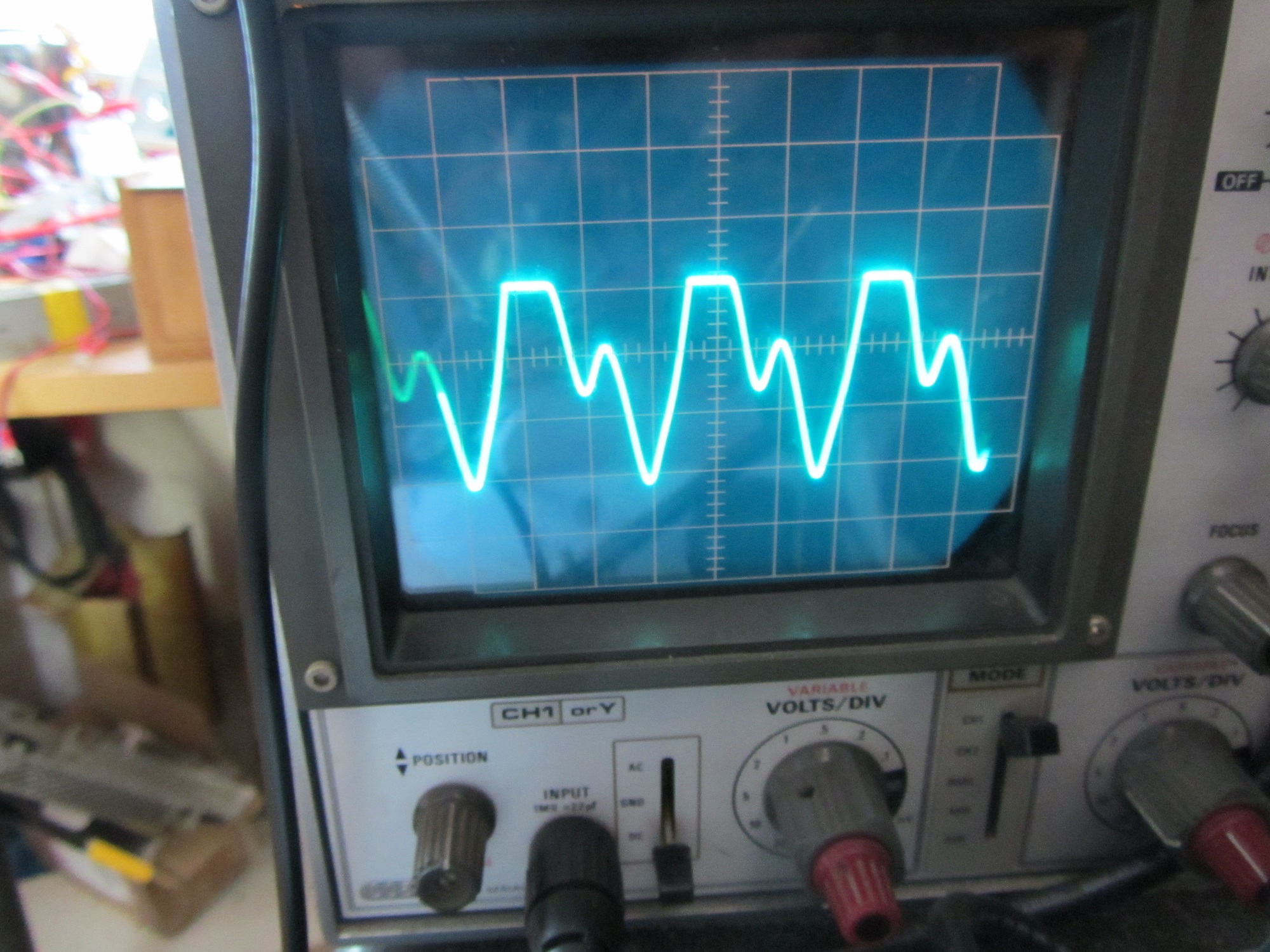

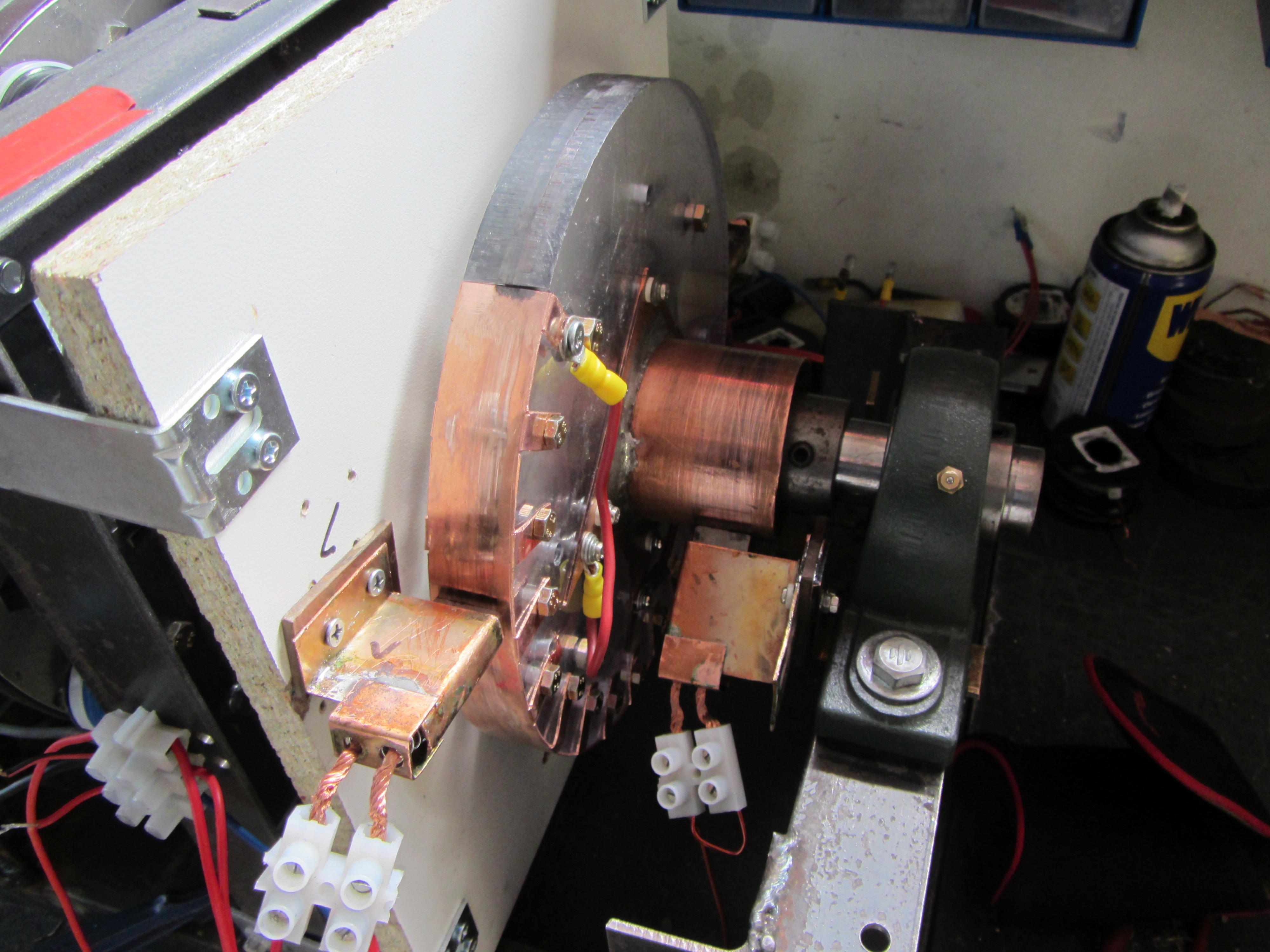

    I have recently finished builing a FEG. I seem to be missing something because although it runs not very smoothly - it is hunting, waiting for the next battery pulse - it does run but slowly drains the battery.Also, it is a bit noisy, that is, it has a high vibration sound.
    I am uploading a few pics of the scope output and the actual machine and would appreciate any comments from anyone who may also have dabbled with this project.

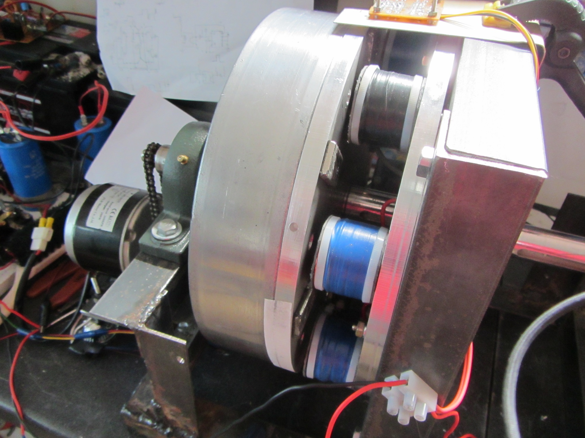

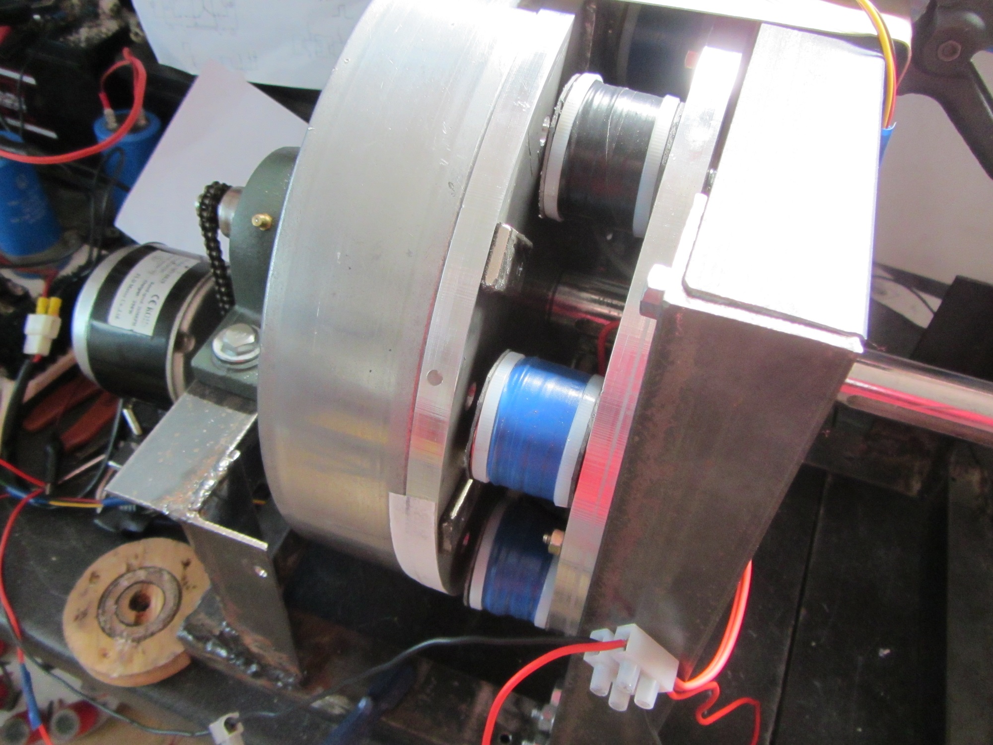

    I have built the magnets into the flywheel. Machining costs are not cheap. My first FEG attempt kept bouncing off the bench because it was running unbalanced. With the machined parts my FEG runs smoothly, limited bounce. I have used 8 coils with 8 N35 40x20x5 neodymium magnets. The coils are as specified in John Bedini's book. 250 turns .8mm wire My first attempt with older ceramic magnets did not give a very strong output. The scope is showing about 60 volts (20 volt scale) through the diode into the capacitor. Two photos, after discharge - lower voltage and charging 50 volts. When running I have disconnected the pulse follow through charging as it seems to make little difference. However, my caps will only charge up to 32 volts over a period of about 1 second. Thus, I am limited to the size of capacitance. 10000uf is about the maximum at the moment. My run capacitors are a total 13uf for wave smoothing. The time base for the scope is 2ms. The voltage scale is 20 volts. Without a tachometer I am roughing the speed at around 620 RPM. The diameter of the flywheel is 295mm. I have eight coils and eight magnets.
    I am using the basic circuit of John Bedini, which I think is supposed to theoretically charge the battery with positive BEMF pulses. That said I have used a Hall sensor to define the changeover of flux through the coil but cannot seem to locate the actual point of pivoting to selectively collect the peak BEMF which should maximise the output to the cap. So I am thinking that I am maybe introducing some negative influence into the capacitor charge that is reducing the effectiveness of the charge prior to discharge into the battery. Result, my circuit needs some development!
    It has taken a bit of time to put this FEG together so I am hopeful of getting it to run with the excess output as suggested by John Bedini in his book. Also, to run it a bit quieter. Happy wife, happy life!!

      The noise is more like a buzzing and appears and disappears, so it is possibly speed related or some form of harmonic distortion. It might be possible to tune this out with the run capacitor. I would think that using a magnet and coil offset would still make a noise, could not be sure, hard to think that one through. Requires testing! Although Watson's rig run but notfor long so no details there. Maybe someone out there has constructed such an energiser. Building one of these is not a cheap exercise unless you have a friend who is a machinist!

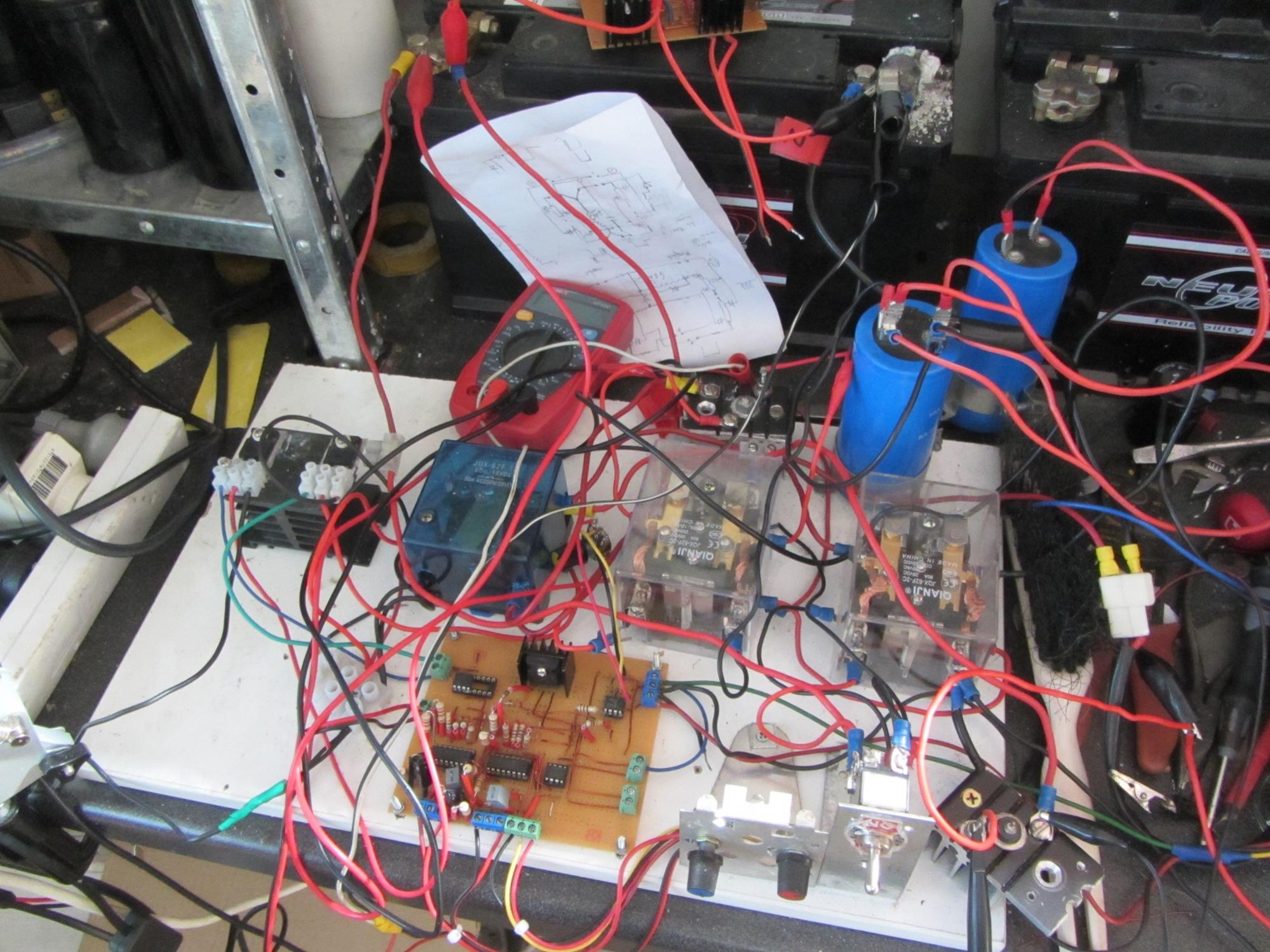

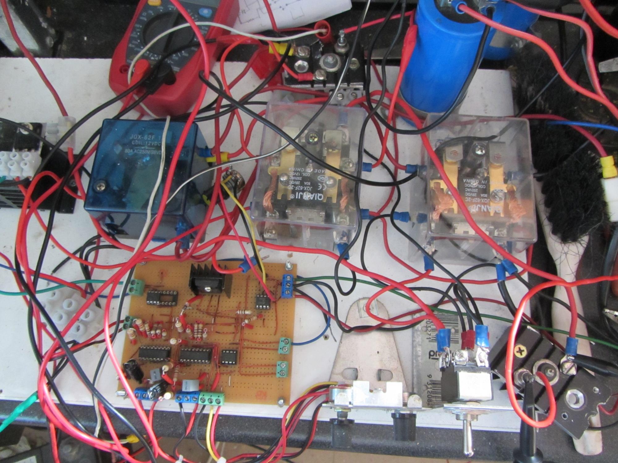

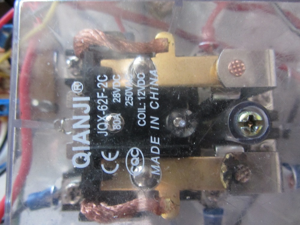

      I am uploading some photos of the relays I have usesd. 85amp, silver/copper contacts about 5ms switching. I got them on Ebay. Excuse the messy wiring still a work in progress!

            I am taking out my relays at the moment and going to replace them with IRFP460's. For me the issue I think has been too long at either the motor pulse/flywheel inertia stage. My motor is small 250watts so it might be working too hard. Also, I have the energy there, the battery jumps .4 of a volt when discharging the cap. To my mind the pulse from the cap discharge should be synced with the motor pulse turning on, or momentarily earlier. Due to the lag of the relays this pulse does not seem to be working for me.

              Commutator Mod
              I have modified the FEG as per recommendation of Mr Bedini in his booklet. I have found that this change has provided a new intellectual challenge. Clearly, to get this FEG operating requires some thought. It is relatively easy to synchronise the brushes with the switching of the capacitor charge/discharge and motor runtime. However, my coils are not providing sufficient "energy" to maintain the momentum of the flywheel. The situation is worse using the commutator than when I at least had it running off the relays and a timing circuit. With the commutaotor it appears that every pass becomes a motor pulse and cap discharge moment. So either I need a variable counter to enable a sufficient charge time for the Cap, or I need to rewind my coils to provide a low impedance load - get more current through.
              It is easy to see why people have not persevered with this machine. Every change requires some engineering cost or material cost of some sort of a walk to the precipice of the unknown. More so a problem when there is no clear horizon of information to illustrate if I am heading in the right direction. It is no wonder that for some people there might be some skepticism as to the validity of the information provided suggesting a simple device!
              A lesser mortal might give up. But as I have invested time and energy and money I'll persevere for a little longer. The concept of "Tinkering" is the wrong choice of verb to describe the challenge of getting this thing going.
