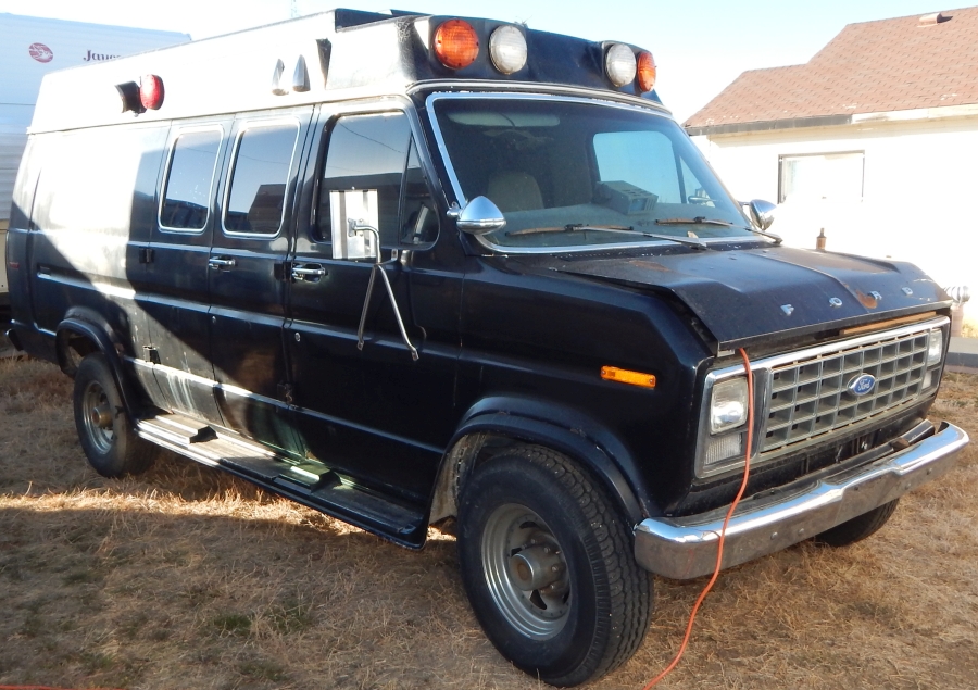

                      In fact; I recently acquired a cheap 1979 ford van with standard carburetor and ignition which should serve well for these experiments and tests.
                      I still have a generator on the bench with plasma ignition system ready to go and since I am experiencing difficulty obtaining materials for the current experiment; I am now working on this project a little more and also thinking about vehicle conversions so; I am very interested in what you are doing especially in terms of reliability because this is a concern. Systems do need to be practical so need to ensure things like long lasting plugs and reliable diodes can be obtained and used.
